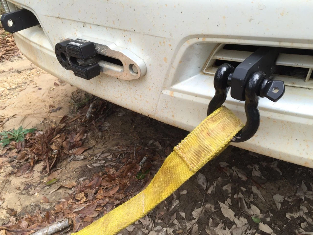

Got to use my shackle mounts today at my camp. Had some trees down from recent storms. Having these mounts made it quick & easy to pull them out of the way.
Sent from my iPhone
