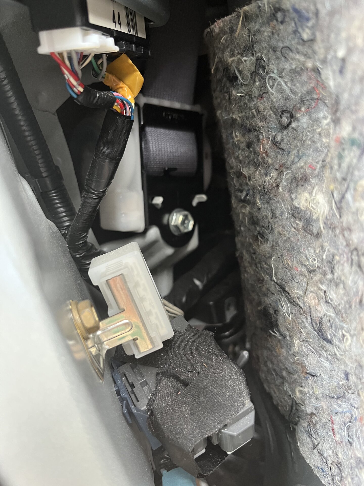

Hey Y’all,
I’ve added a Curt hitch and 2” shackle hitch receiver to my 2004 GX470 for recovery purposes. However, I’d like to have the option to tow if I need to.
My 2004 is February production. I know there’s a cutoff in 2004 where some of tow parts changed over. I read this post over on ClubLexus, and I pulled together the following parts list. Want to make sure I’m not missing anything before ordering.
Does this look right?
  • under hood relay x2
  • Wiring harness x1
  • Relay in trunk / near driver rear tail light x1
    • 81985-60021
    • This is the one I’m unsure about. I can’t find where it would plug in, and I’ve opened the area where the jack goes and pulled back the trim panel (see pictures below)
  • Not required, but I want to test the harness and make sure everything works…

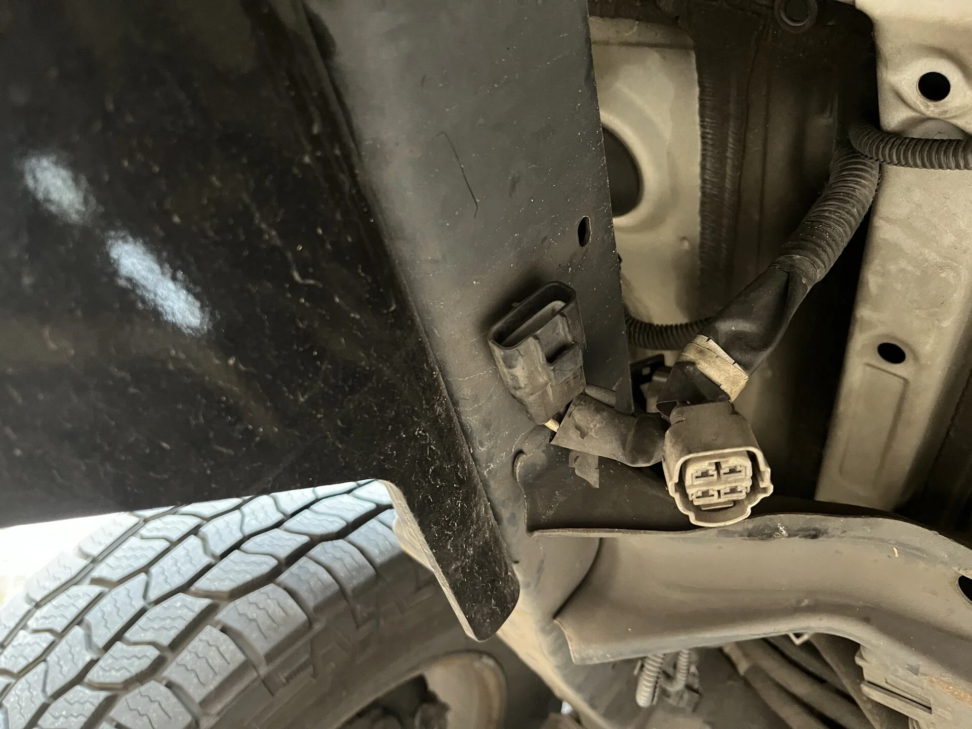

If your truck has the factory towing package you'll have a 7 pin connector under the back bumper on the drivers side. If not this might help

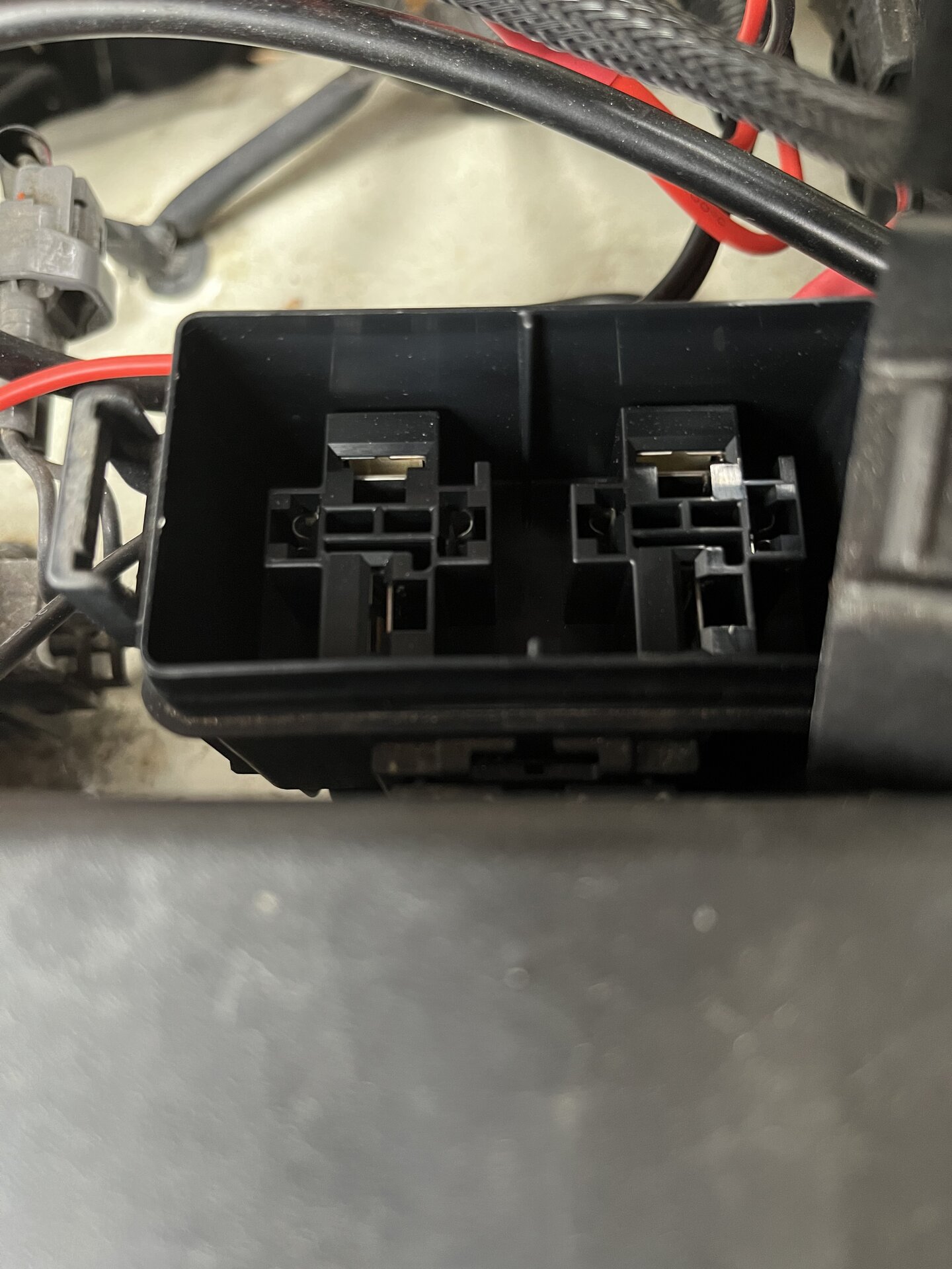

Hm, I have the 2 plugs in the rear near where the spare tire goes, but I don’t think I have the towing package. The container for the 2 towing relays under the hood is empty.
Based on the thread you shared it seems like some folks need to order that relay for the rear, but others don’t. I’ll pull the trim panel entirely off later tonight and check for a receiver for that relay.
