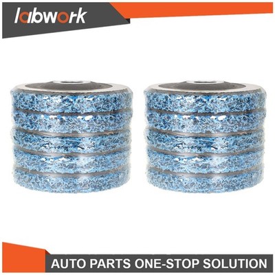

Polly Carbide Easy Strip discs. These discs work amazingly well for taking off old paint and rust without leaving deep scratch marks in the metal.
Sadly the Harbor Freight and most the Ebay ones only have the 5/8 hole. Did find some on Ebay with a 7/8 hole.
Also 3" rollock versions available on Ebay, not in Harbor Freight stores.
