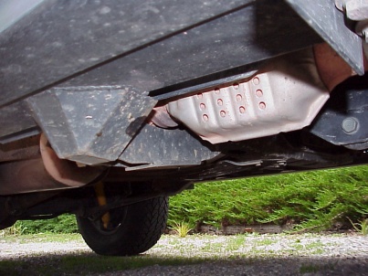

Most quality sliders, i.e. Christo's, Hanna, etc. offer cat protection.
Here is a picture of the Slee-slider's protection:
This picture is actually of the 2nd generation sliders, but the protection is the same as the current ones.
Hanna has something similar, but with the addition of a vented 'skid-plate' that covers the entire underside of the cats.
Even though it looks less substantial, I haven't had any problem with Christo's design, and I've heard the same from others who have tested it more than I have.
