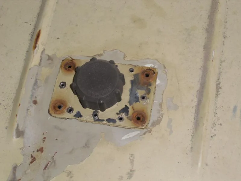

Figured that I better start on some body work. The top had this wierd flanged cap that a previous owner rivited on. Anyone have any guesses why? I have no clue.

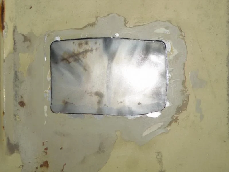

I took some duct tape and put it over the hole and was able to see a pattern and cut out a piece of metal from an old hood I had. I cut it a little larger and then used a scribe to mark what I needed to clean up further. Here is how it turned out.
attachment.php
Going to make a few more patches and try my hand at a little sheet metal work.
Humm, maybe an internal shower????
Nice job on the patch
