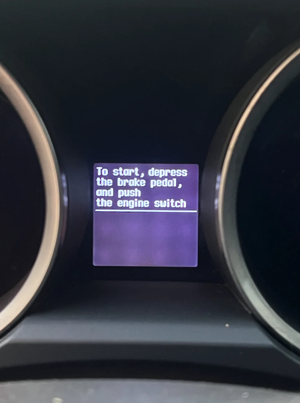

On the dash it shows the message "To start, depress the brake pedal, and push the engine switch":
Indeed, the car does not percept the pedal for being depressed as the taillights do not illuminate when the ignition is on and the gear stick does not unlocks/move when the brake is pressed.

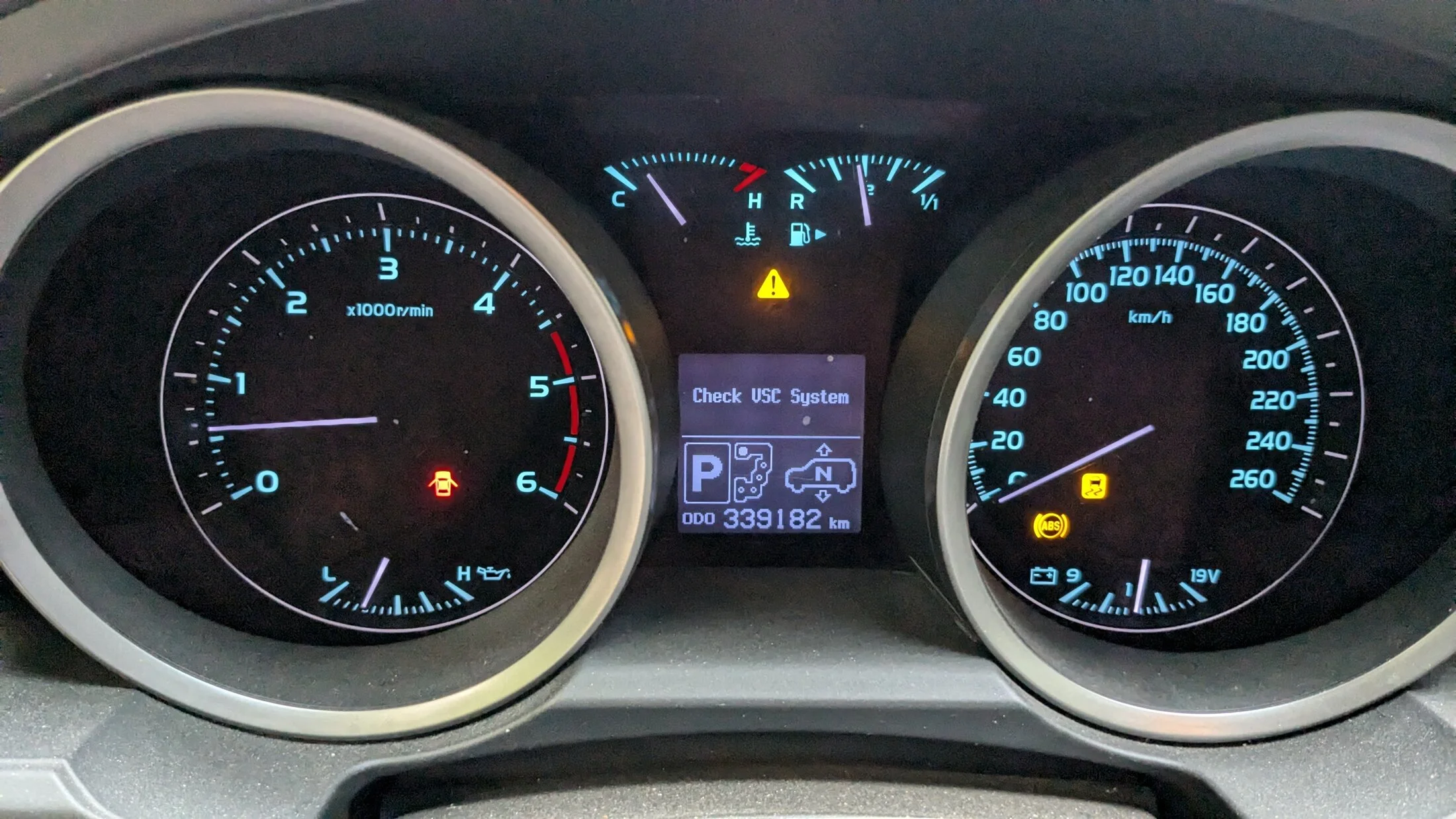

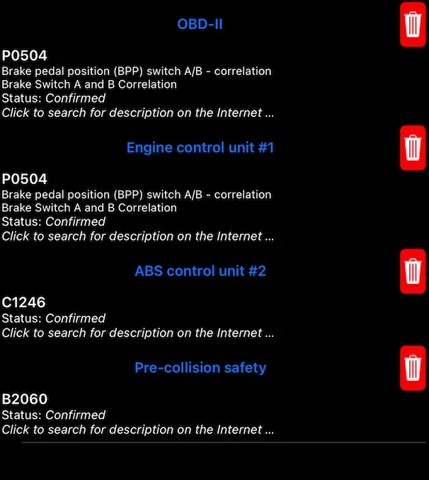

Together with this, VCS, PCS, 4Lo and so on started illuminating on the dash. Connected my cheap OBD reader and tried to check what error it gives so I got the following:
P0504 - Brake pedal position (BPP) switch A/B - correlation
C1246 - ABS
B2060 - PCS
Deleted all the error successfully and tried again but no luck.

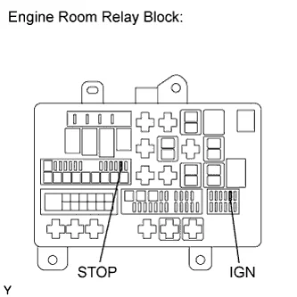

@NikP's info from the FSM is spot-on. I'd definitely double check the STOP fuse first (#2) and then the IGN one (#3) since you're in there as you're not seeing brake lights and I'd even go so far as to swap it even if you think it looks ok.
