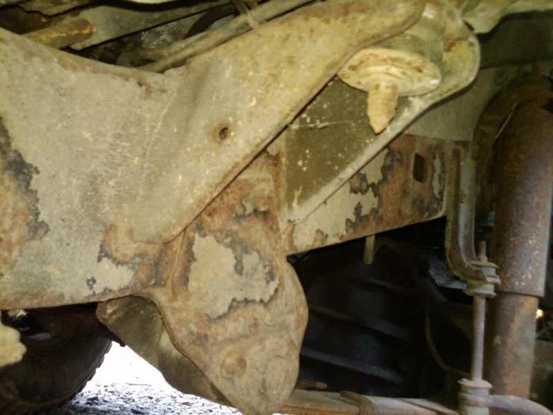

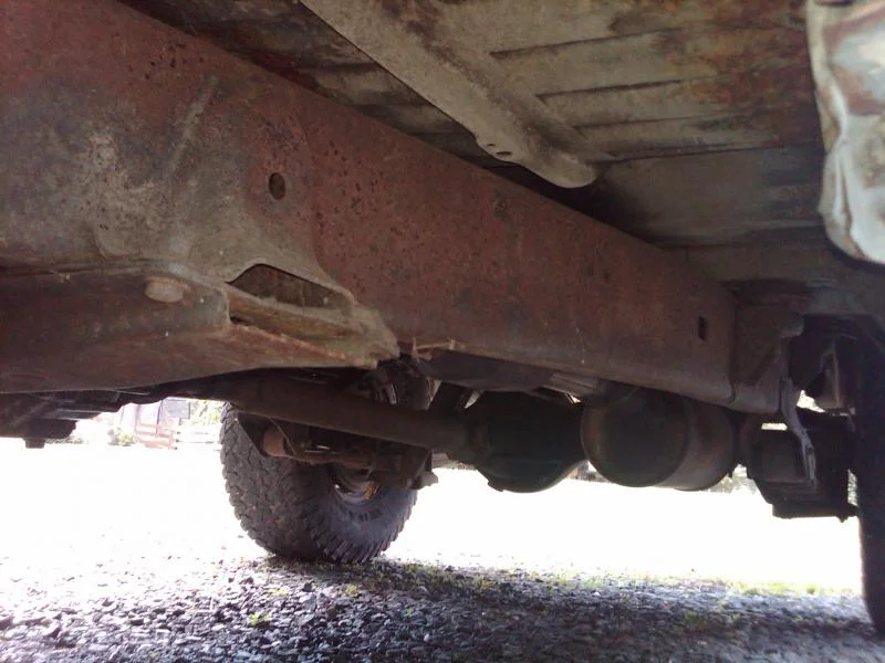

Apparently my memory is a pessimist, because it looks pretty good here.
The 2-3 main places these trucks frames rust are not shown in your pics. You need to see the inner frame above each of the rear spring hangers (the hangers under the rear doors) and the inner framerails next to the spare tire. The rust holes over the spring hanger are not too bad to fix, the rear frame rail rust is a different story. Some folks also have issues with the rear shock crossmember rotting off where each end meets the inner framerails.
I agree the outside of this frame looks decent. It will need wire wheeled and painted pretty soon to keep it decent but it's not bad.
Nick
I have pics of the outer rails above the spring hangers, but none of the inner frame and non rear of the wheels. I remember the rear section being worse than the rest.... but I would also think that would be one of the easier sections to replace / repair? I'll get to see it again and hopefully drive it this weekend. I will update at that point. Anything else specific I should be looking for?
Thanks very much!
those parts dont rust... lets see the rear inner frame pics and the rear front and rear sping hangers
