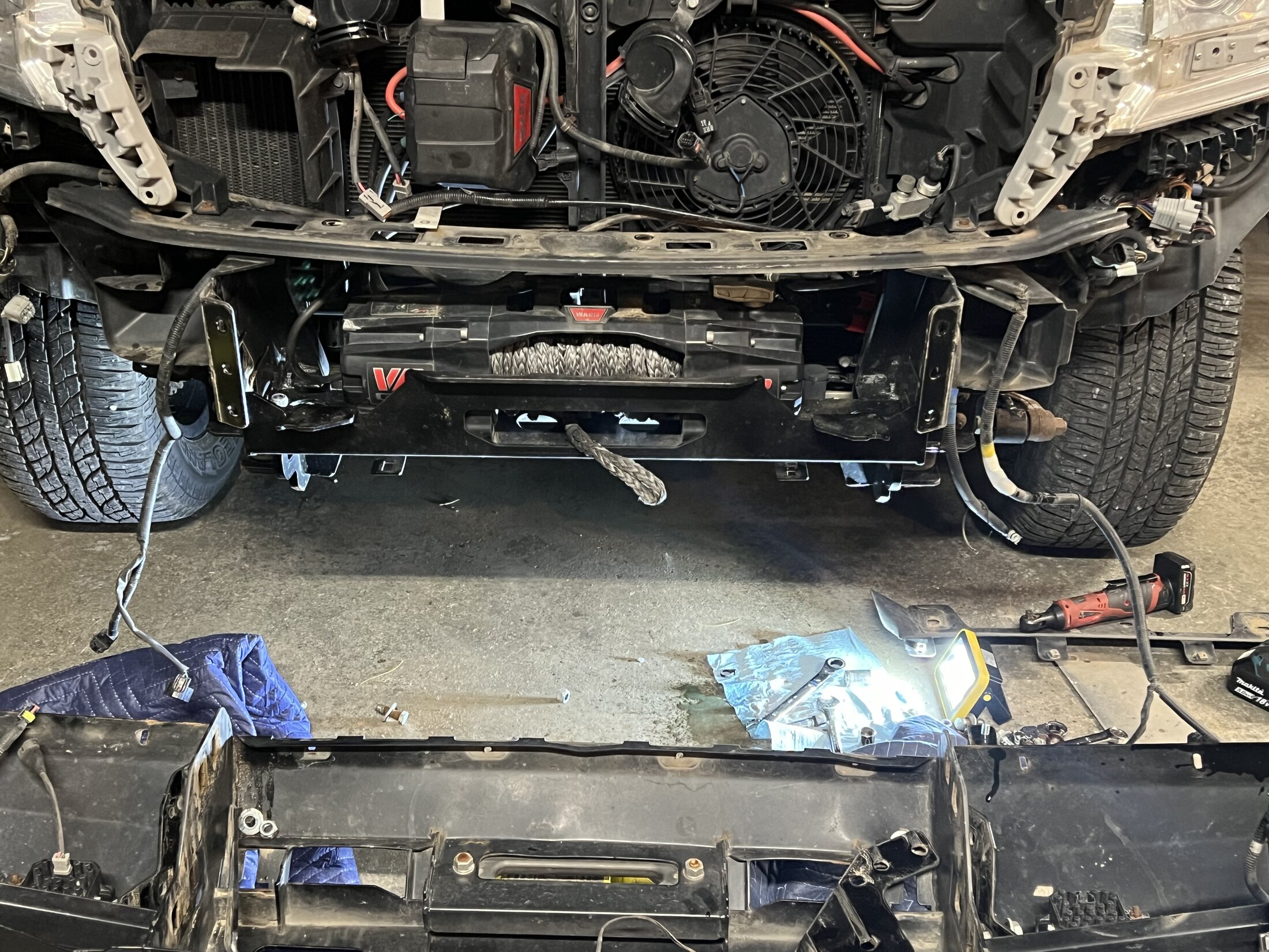

I'm in the middle of removing my TJM T13 front bumper as I return my 200 to a street configuration - my wife wants it "less tarted up" LOL for daily use. (that's fine by me since I have a built 80 for trails now)
So I remember the bolts holding the bumper to the winch cradle being a pain in the backside to install, but I'm finding them all but impossible to remove.
Access is super limited and although I can get wrenches and spanners on the fasteners, I don't have enough swing or leverage to undo them.
I installed it myself, so I 100% know it is doable, but I'll be darned if I remember what combination of tools I used to do it.
Do any of you recall the tricks? Any tips? Words of encouragement?

I’ve done this twice and yeah, it’s a bit of a pain. I don’t have any specific tips. I just recall having to reach through the rectangular holes on the front of the bumper and “wedging” a wrench or ratchet/socket and then using a wrench or socket on the other side. I also have long cheater/breaker bars and some lengths of pipe to slip over ratchet handles.
Is your hardware stainless steel? Did you use lube/anti seize on the install?

I didn't replace the stock hardware, so I suspect it is just typical zinc coated or whatever the basic stuff is, not stainless. It doesn't seem corroded though. I probably used a very small amount of antiseize.
I guess I just need to give it another try.
I'll see if I can figure a way to wedge a wrench inside. Good tip. Thanks!

Success! Thanks for the encouragement and advice.
I used the "wedge the spanner" technique from @kcjaz. The two bottom bolts I used the spanner on the inside (nut) and the top I used the spanner on the outside (bolt). It would have gone quicker with someone holding the spanner :) but I made it work. I tried both regular spanners and ratcheting ones and the ratcheting ones seemed to work a little better.
The two top bolts had minimal space to swing a wrench through the rectangular hole in the bumper, so a ratchet with fine teeth worked better to get them loose. Then I switched to a little Milwaukee M12 ratchet to finish the job.
