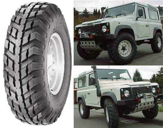

A little search shows Silverstone are making them.Im sure there are others.They look ok on the LR:smokin:
http://www.infort.ru/offroad/op_slvrst.jpg
I'm using these on my 79 now! There are made in Malaysia ;)
