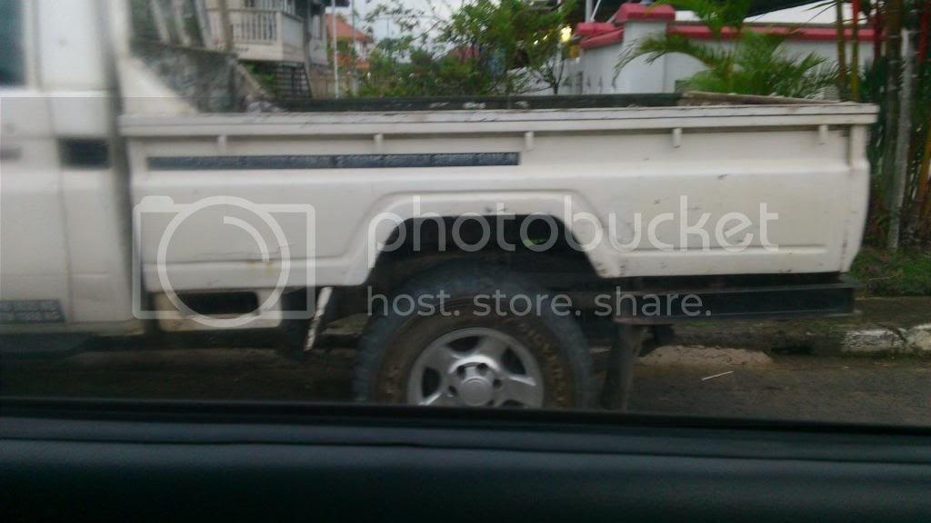

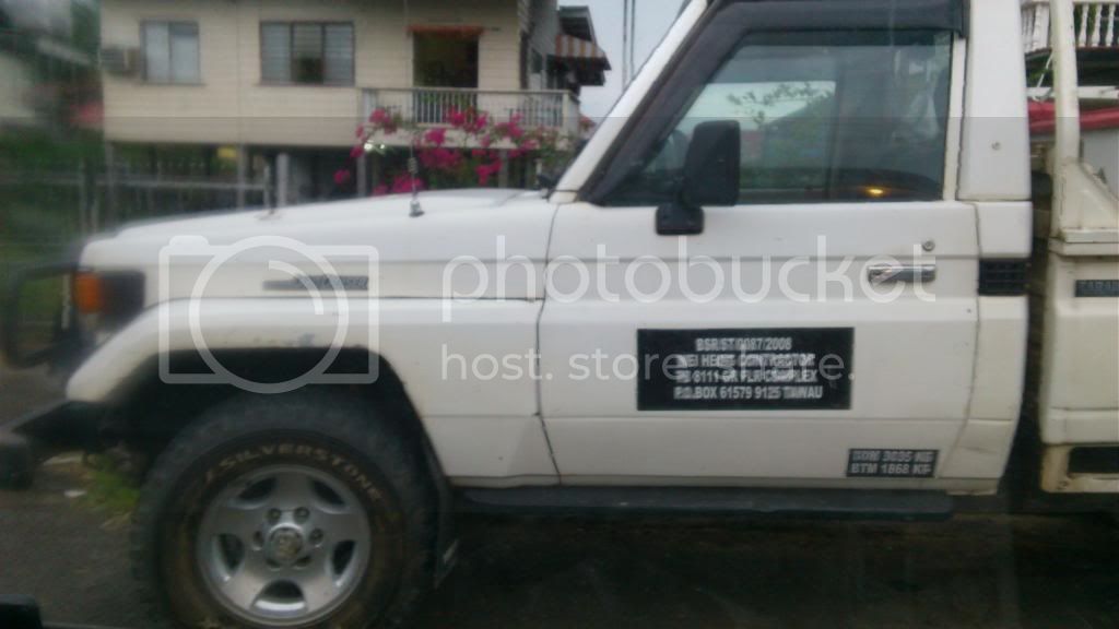

There is 31X10.5XR15 made by Silverstone in Malaysia.

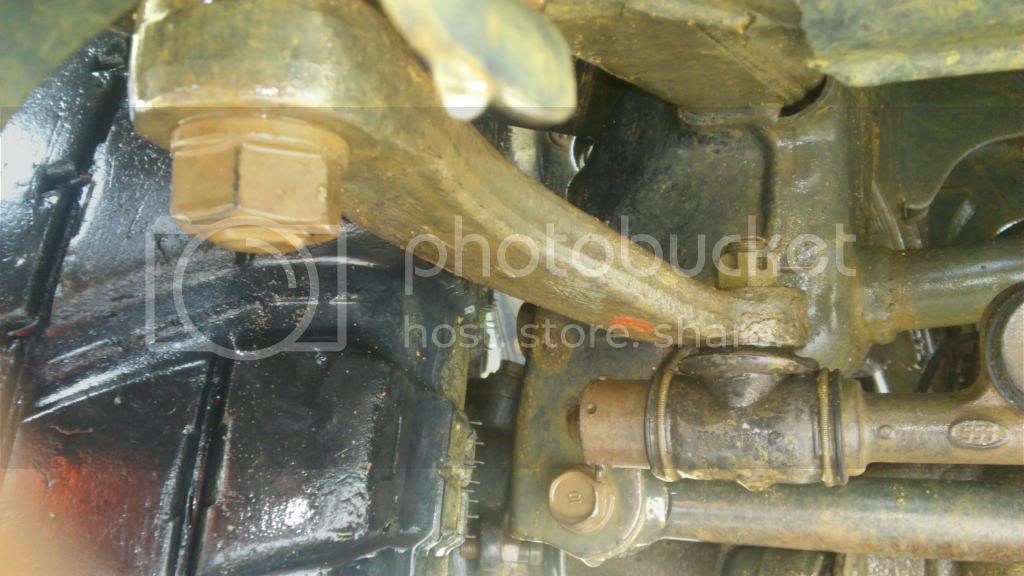

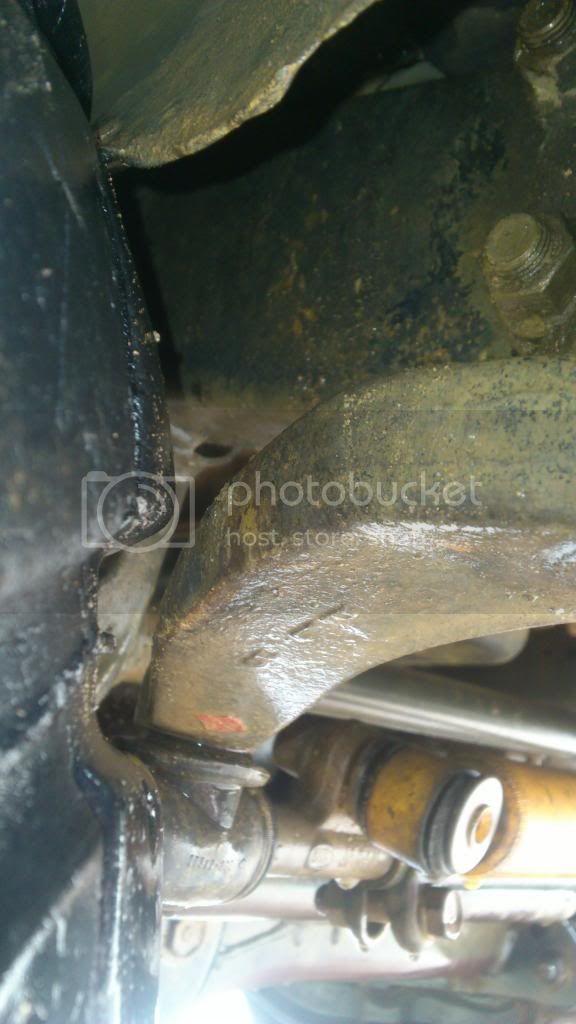

I'm running on 285/75/16 with stock suspension, stock steel rims and it will slightly rub the steering component when I'm turning left at full turn. I think rims with slightly negative offset can cure this problem.

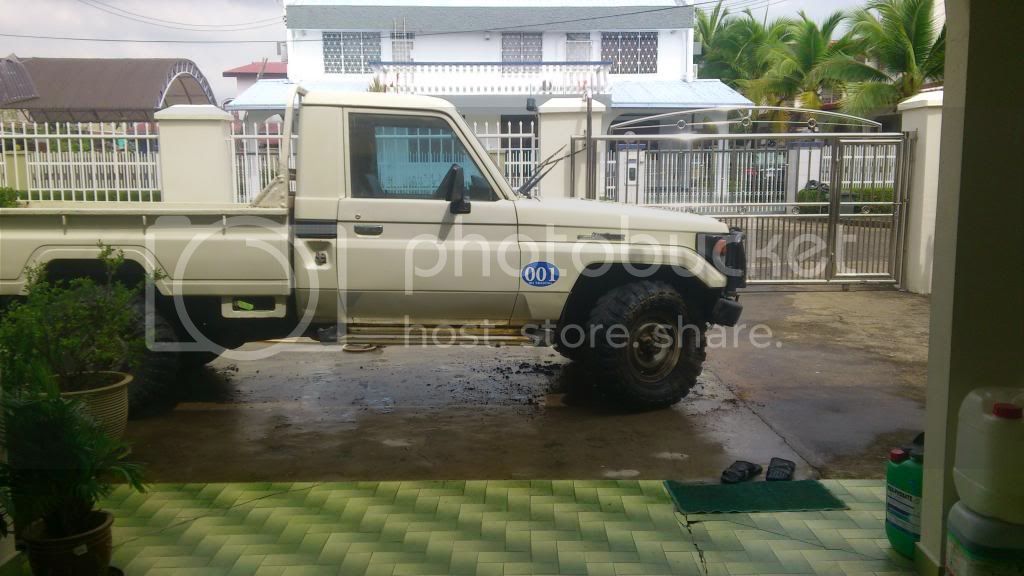

Can we get more photos of 70 series with 255-85-16 tires?
