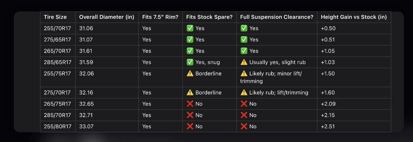

This is a table for stock height. A little info to get you started. Figure if you have a 2" lift you can fit some 33s but there are lots of threads woth useful tidbits if you look around.
Height gain values are inaccurate and should be divided by two. Other than that thanks for this handy table.
You are correct. The column header is misleading - it is height gain for the tire. For truck height gain, divide by two.

Lots of folks on here have run a BMC, myself included. It's simple and easy and solves the problem. I didn't need a BMC with a 265/70R17, but did with a 285/70R15. You might be able to skip it with a skinny tire like a 255/80R17, but it's not guaranteed.
If you want to run a 33" or larger on one of these rigs, be prepared to chop. If a chop is 100% off the table, stick with something <33". There is only so much real estate in the cramped GX wheelwell to work with.
