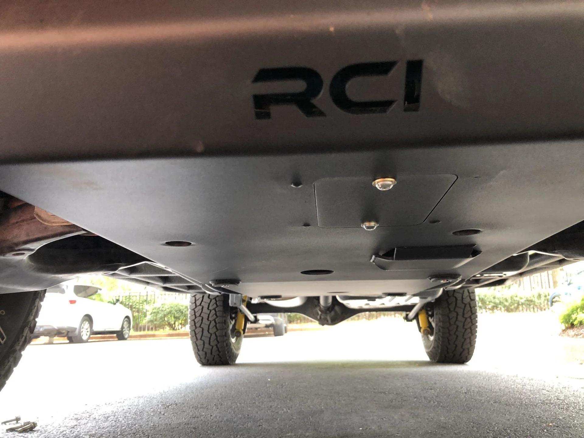

Got 2 of 3 RCI skids on today, fuel tank skid will go on one evening this week. I need to find the torque spec on those bolts. So far so good...

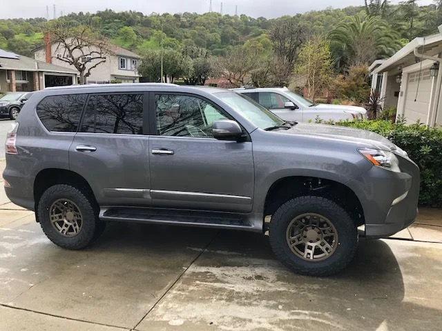

What size are those wheels? Spacers? Lift?
I bought Rival skidplates and now almost regret not getting same RCI as you got. The Rival ones are cast alu and I feel the RCI are not cast? Right?

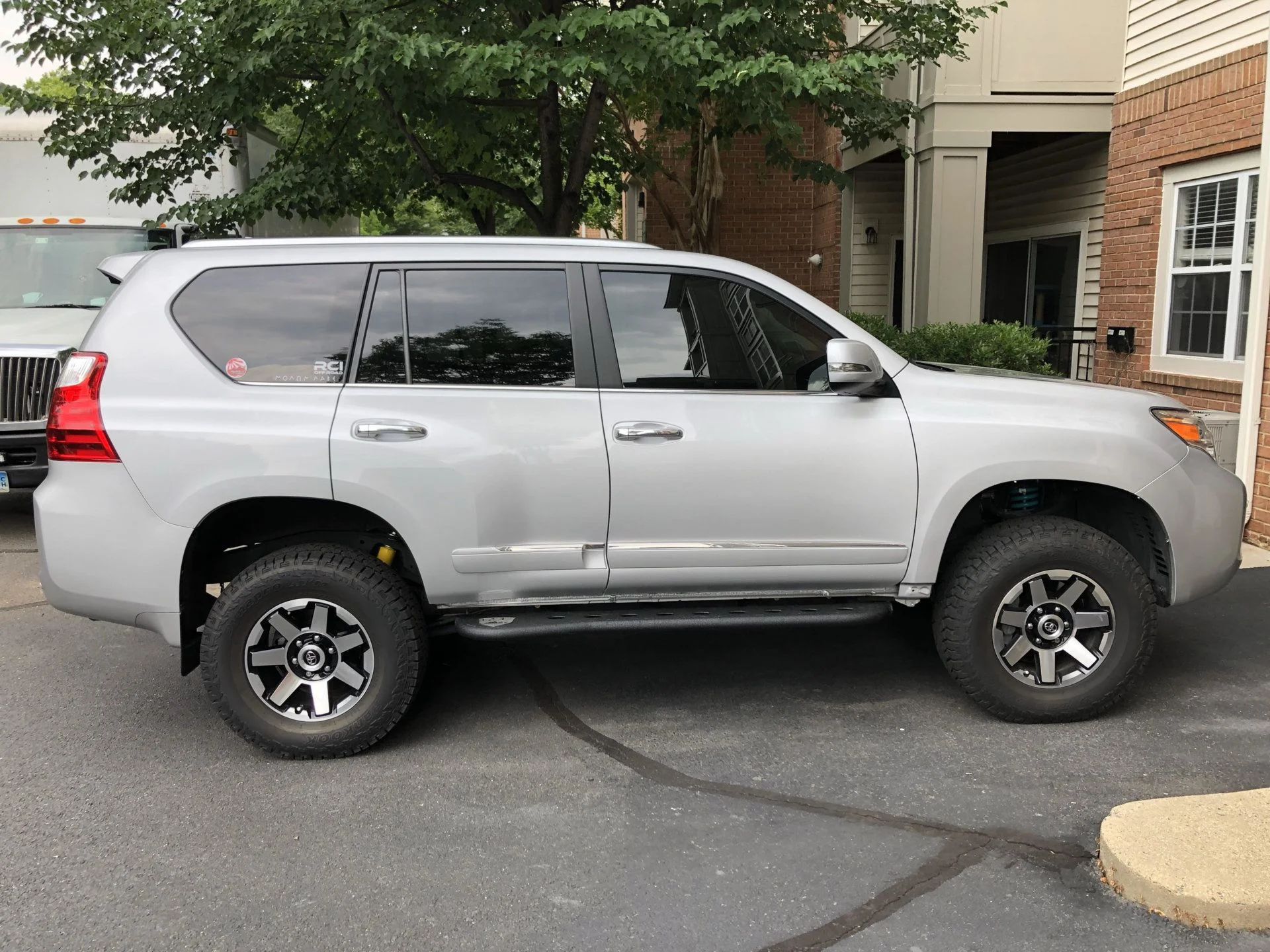

Thanks a bunch @SWECER I"m running T4R Trail wheels, 17x7.5/275/70/17 tires, Dobinsons 2" HD lift, no spacers and no rubbing issues. Got the fuel tank skid on last night, I opted for the steel at 1/4" I think they are, 59lbs worth on the fuel tank skid! Solid though, makes me more tank-like now :) I need to find where I can get the torque specs for everything still, haven't had luck yet looking in the TechDec app.
Thx! What ET/offset does those wheels have? Thx!! :bounce:
I'm planning to try and put 17/8.5/285 with wheels that has offset of 0, compared to my originals with offset of 30. (18/7.5 with 265/60/18)
My car is slightly different as I have a LC 150 Prado and don't have the same side trim, and I have also added an AFN front bumper that gives more clearence. In addition a 2" lift (Ironman)
Nice, post up some pics. I'm not sure of the offset but it's a Toyota OEM 4Runner wheel. I'm interested to see that bumper and skids, I don't know if they're available over here. I'd like to get some 150 badges one day if I can find what a 2012 should have outside the US.
With all due respect there are not any armor products (read: skids, bumpers, sliders, etc.) that will or should ever be cast. There are several reasons:
  • To try and cast a skid plate, the mold would be far too large for most companies to build AND to pour. Also with such thin material such as skid plates, bumpers, etc, it would be near impossible to get the material to flow the entire length of the mold.
  • Casting provides a very brittle part. Brittle meaning that it will not handle impact, such as the vehicle coming down and landing on a rock after rolling over it. It would shatter into a million pieces. This is due to the fact that the molecular structure of cast parts are not aligned so there is no "grain" to the metal. With no grain, the part will easily break or shatter. Also a reason to not use cast aluminum rims.
  • When any metal, e.g. aluminum, steel, stainless steel, iron, copper, brass, bronze etc. is extruded and forged, it aligns all the molecules in one direction which provides a "grain". This grain is what allows a metal to bend and not crack and break or the ability to be pounded on and not shatter or tensile strength to be pulled and stretch and not break.
One thing I would really like to see and I've expressed this at least one other time in this forum is if some one would make aluminum bumpers and Delrin or polypropylene sliders! That would get our rigs back to being close to factory weights and help increase our MPG and even off road abilities! Someone is already making aluminum bumpers for the 100 series Landcruisers!
Great info @r2m thanks, didn't realize all that. A friend of mine with a Tacoma has a Delrin skid for his tank, saw it last night as was like wtf is that, 1/4" and light as can be, fastens with like a seatbelt-type strap, but looked like it'd held up well and the weight difference is night and day of course
