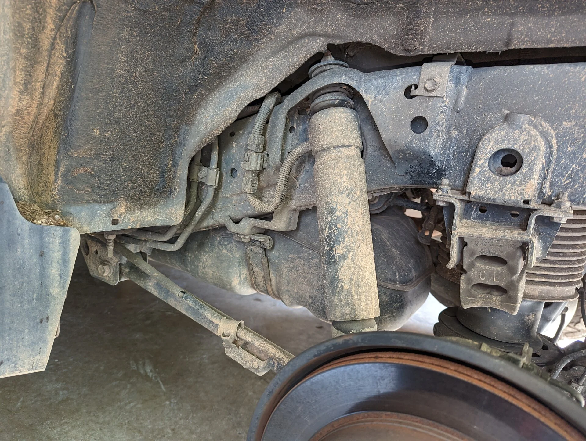

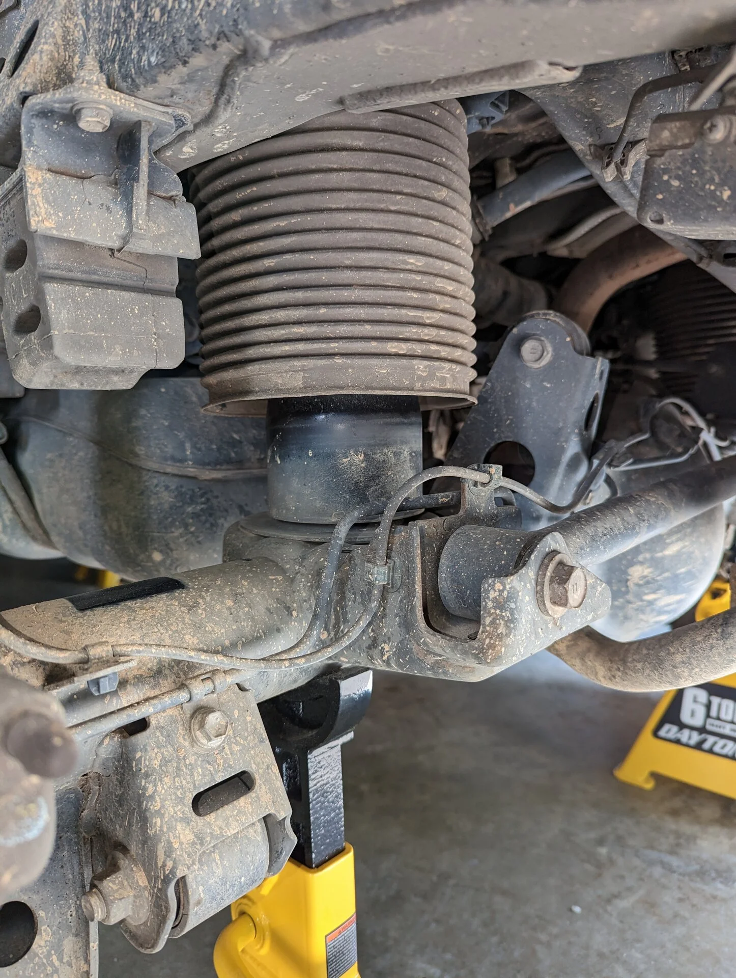

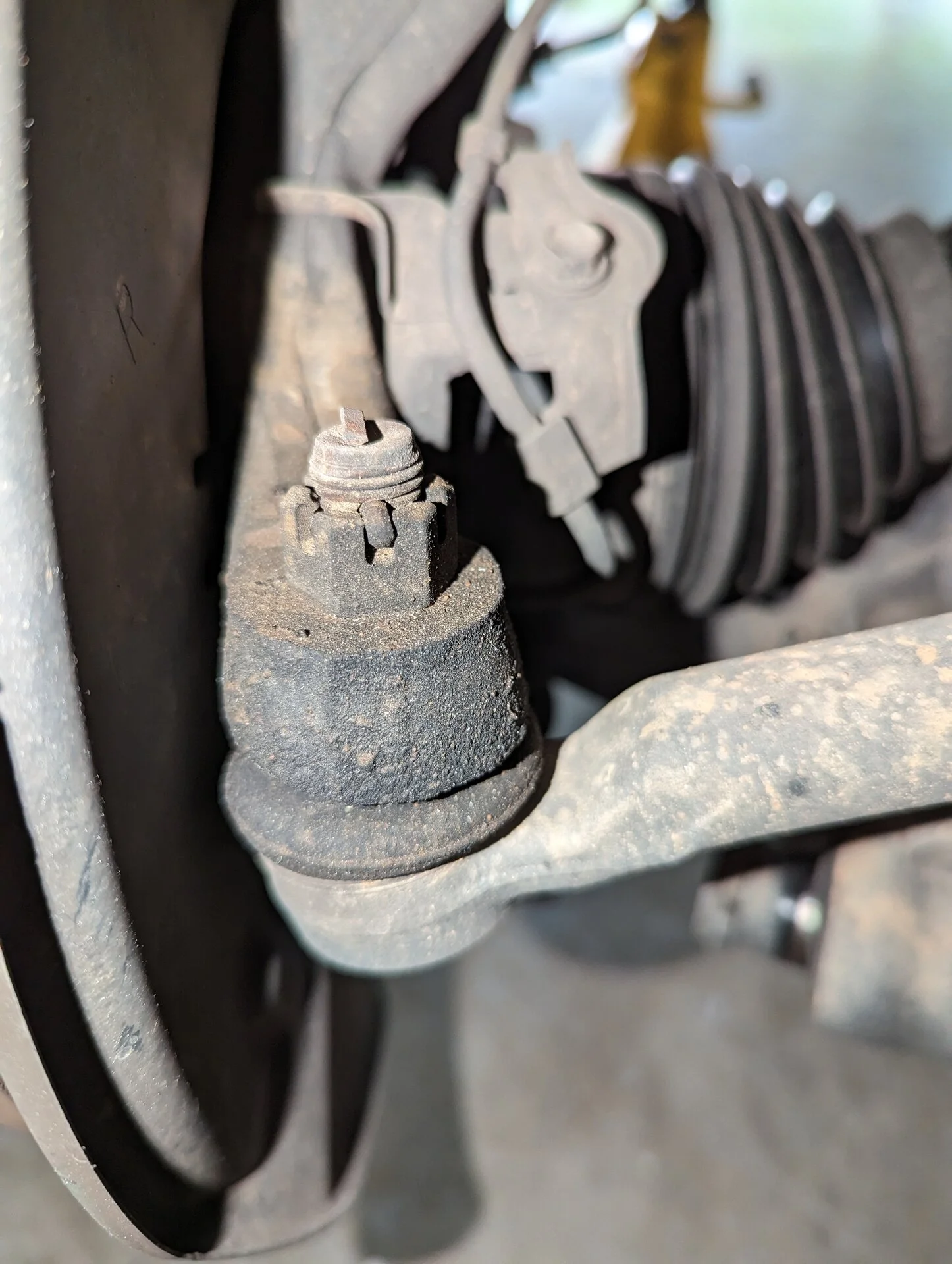

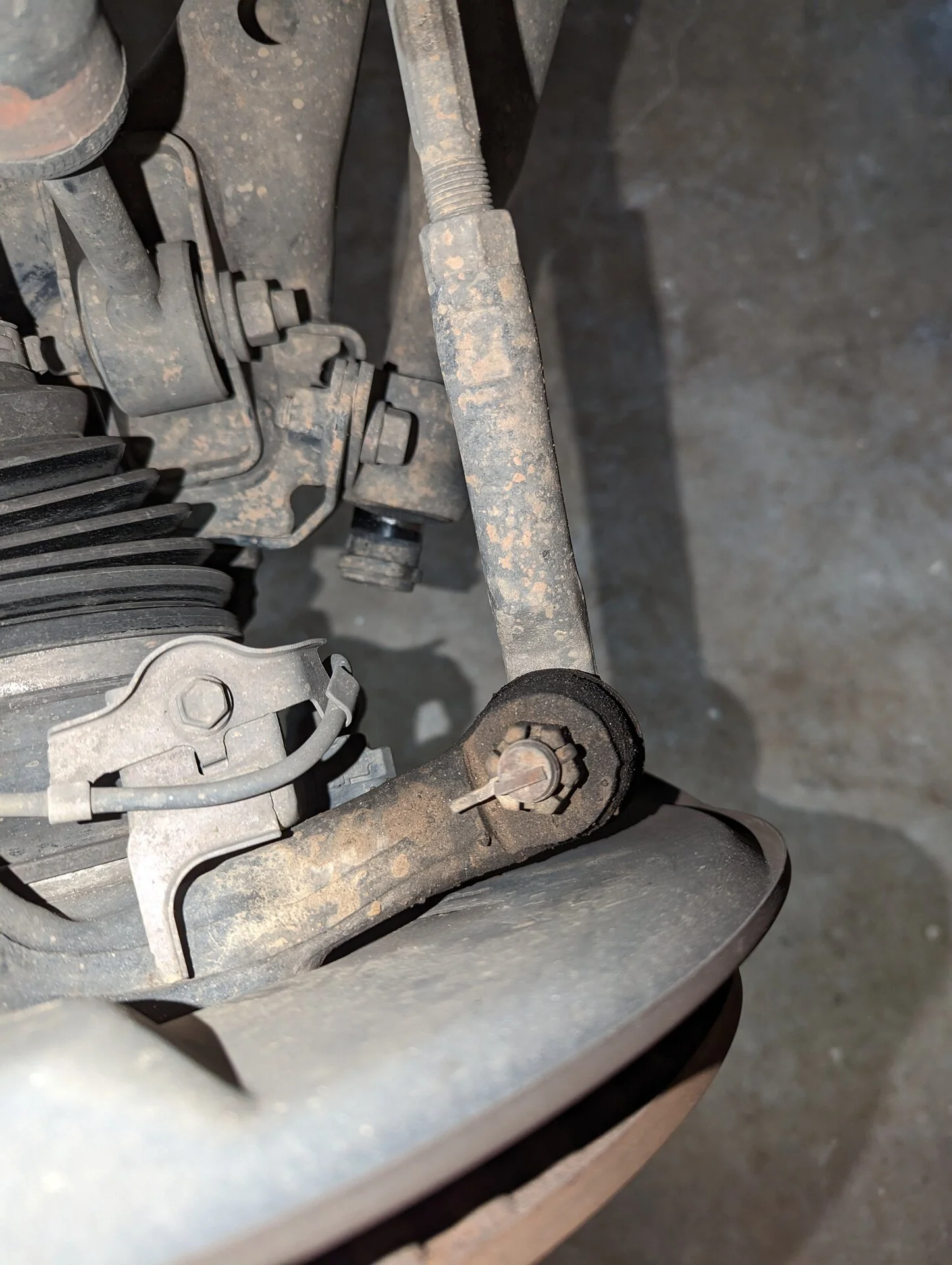

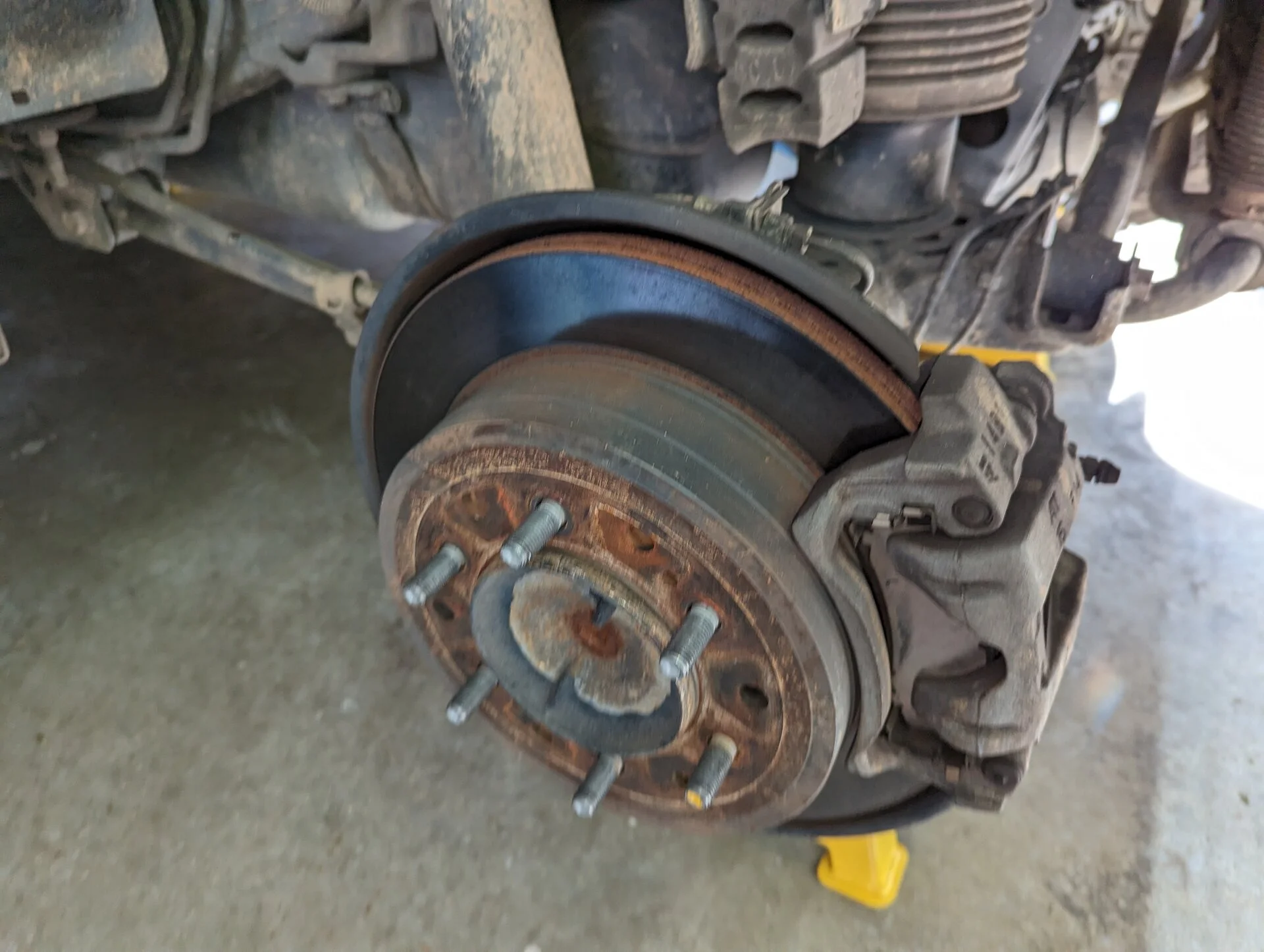

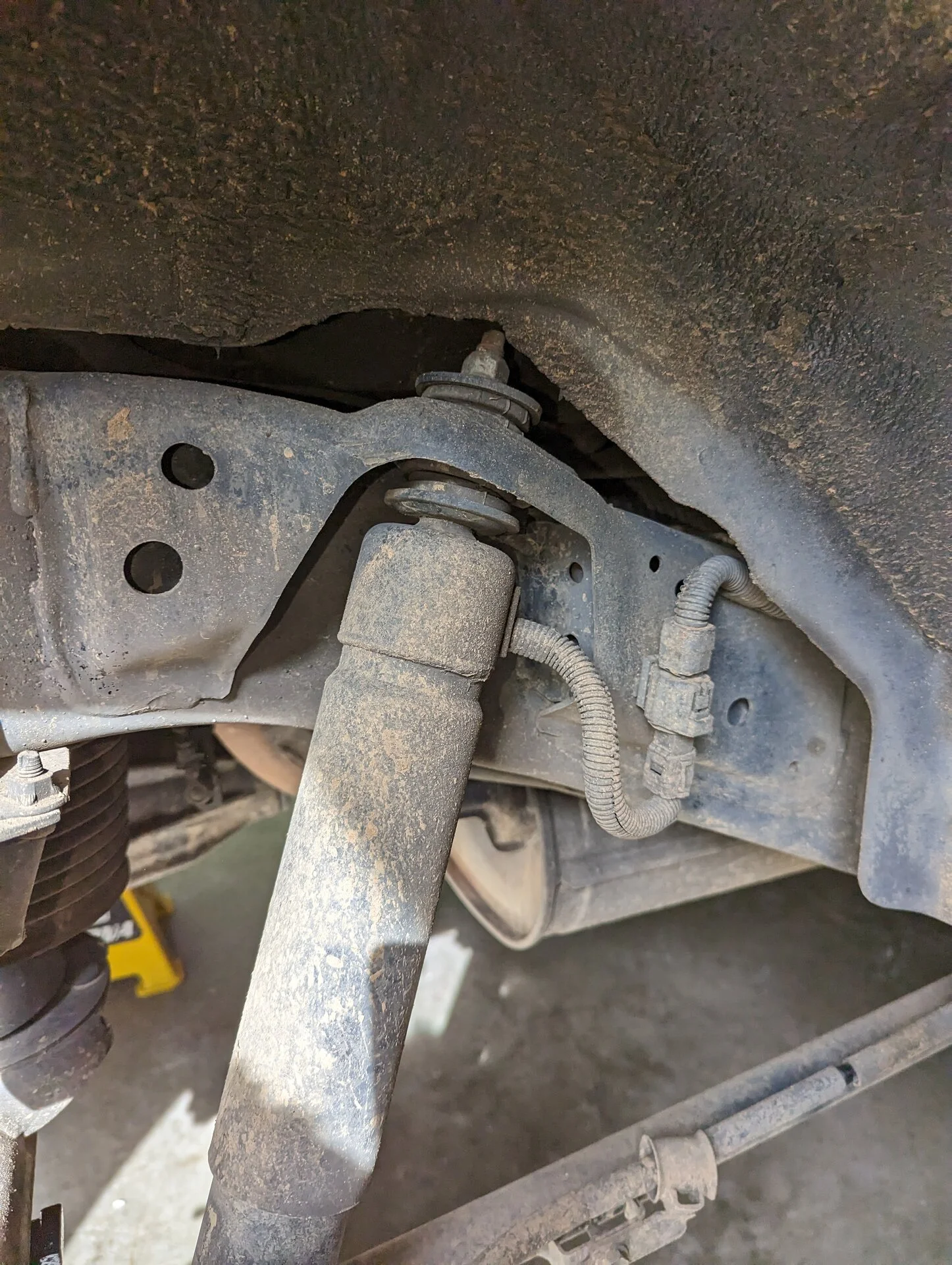

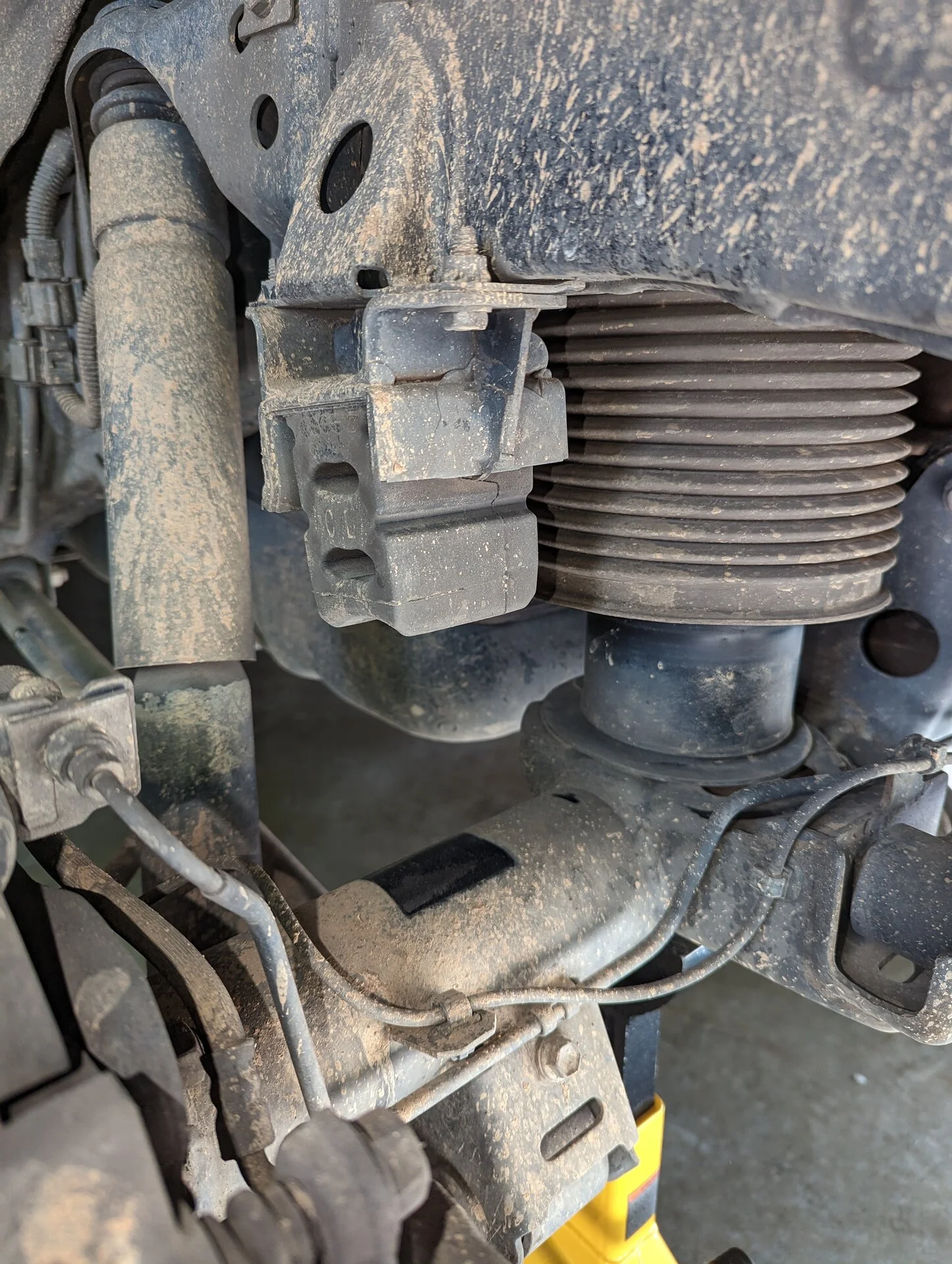

Some tire rotation pictures. Not sure what's normal/not.
Left rear:
Front right
Truthfully, I'd look for a 5 star Yelp front end or alignment shop and have them do an assessment on it.
Preferably a shop that specializes in off road suspension and even better if they specialize in Toyota products only.
I don't see anything abnormal aside from actually using those bumpstops. Keep on sending!

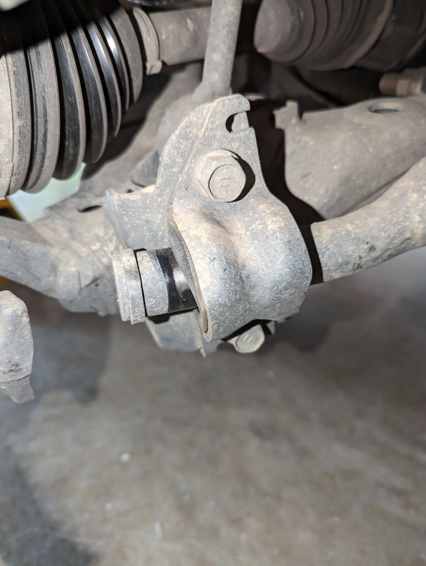

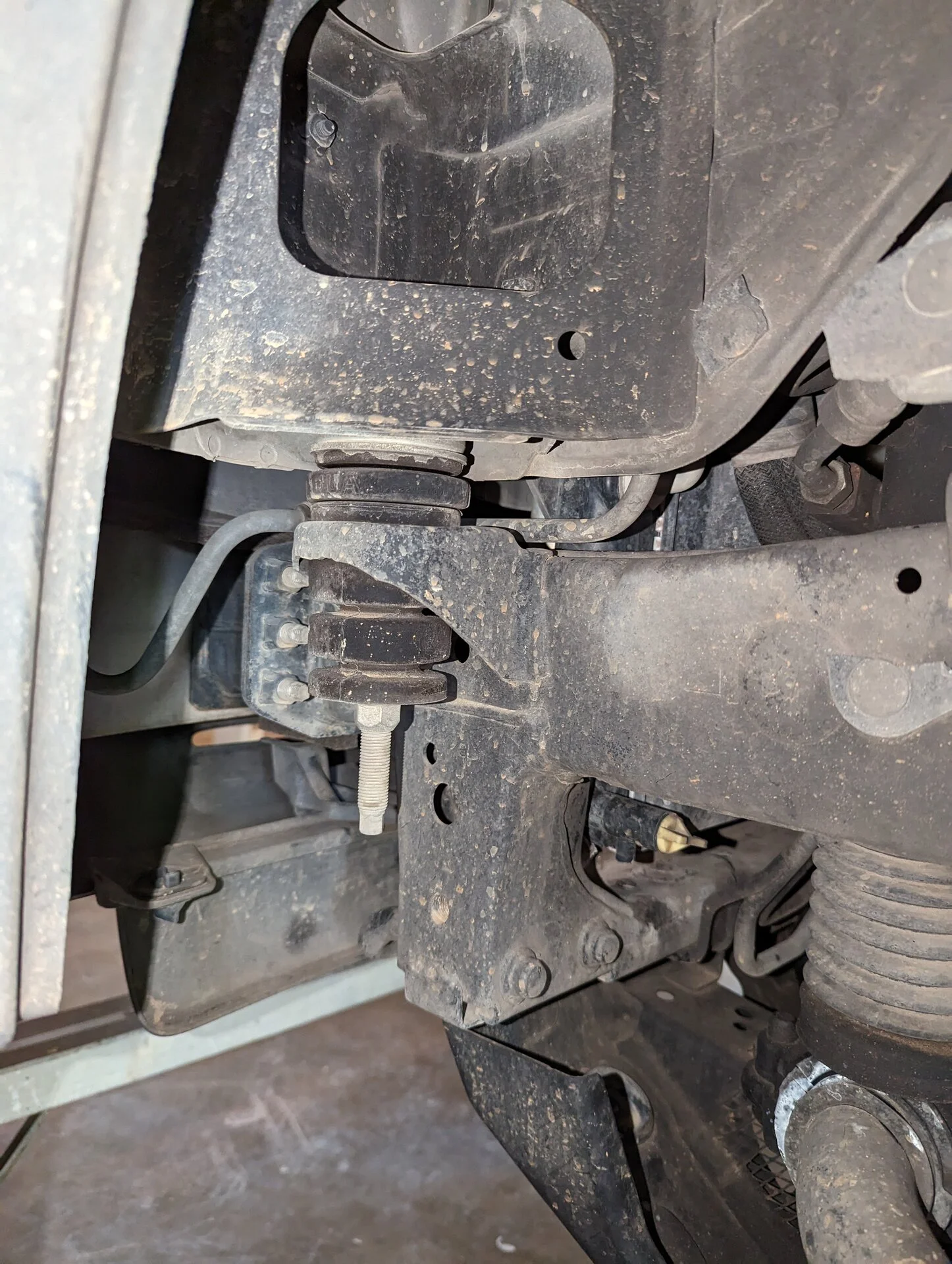

Stabilizer bars are part of the KDSS system
You may want to look into some of the Dr KDSS products when replacing unless you want to stay completely stock
I thought everybody's KDSS business looked like that? ;) Given the pressure generated by the system to function correctly, I can't see rubber bushing NOT deforming quickly. Having said that, I realize absolutely no negative ride implications for having bushings like that.
:meh:
I guess once you start hearing clunking or rattling :)
@Washingtontaco installed those billet clamps on his rig
They are holding well!
I will try out the stabilizer relocation brackets in a few months.
Come to think of it I need to look at those rear stabilizer bushings to see if they are starting to squirt out.
