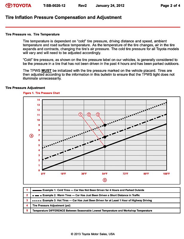

The simple answer is, "No."
It is normal that tire pressures will increase after driving, that's why the tire pressure is set when the tires are cold - meaning not having been driven on for at least 4 hours, not allowed to sit in the sun, and fully equilibrated with ambient air temperature.
One can be driven crazy trying to continually adjust tire pressure based on changing air temperature. Ideally, whenever air temp changes, one should allow tires to re-equilibrate with ambient air temp and re-adjust pressure. Practically, it is only necessary to re-adjust tire pressure when there is a significant change in either ambient air temp or elevation. What this means is that if one checks tire pressure once a week at the coldest part of the day (usually first thing in the morning) and adjust to RCTIP, you're good to go.
Notes on when to set RCTIP:
- Assure tires are cold and fully equilibrated to ambient air temp
- Check regularly and adjust when necessary
- Check and adjust when air temp or elevation changes significantly
- If checking/adjusting tire pressure in a protected environment, e.g. heated garage, adjust tire pressure to compensate for outdoor ambient air temp
Concerning the last point, here's what Toyota recommends for compensation:
HTH
