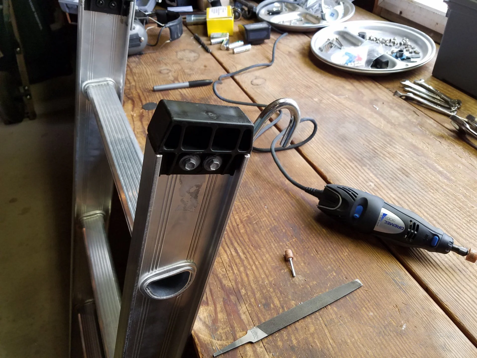

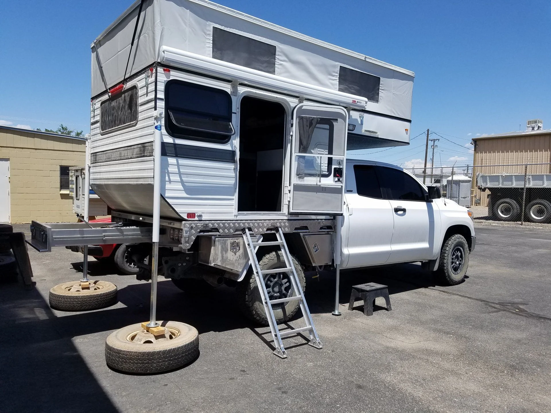

Got the ladder put together yesterday, I started with an 8' aluminum ladder then cut it to size and fit some hooks.
It hooks onto the bed in such a way that it can't fall off, or be inadvertently removed, thus preventing a 52" header in the middle of the night. However removing it is easy if you know the correct sequence.
It fits perfectly on the floor of the camper making it really easy to recover or stow.
At some point I'll TIG some really cool aluminum hooks onto the ladder replacing the plastic end caps and steel hooks. The functionality will be the same but it will be more aesthetically pleasing.

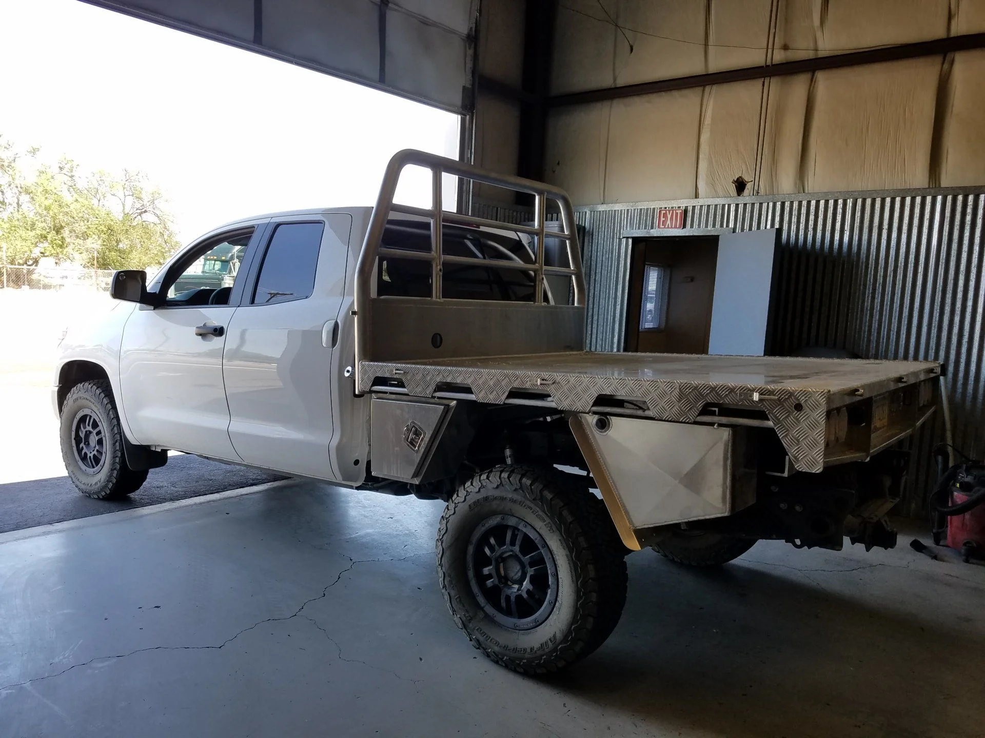

Could the Norweld flatbed have been installed any "lower"? The truck and setup looks great, but a good bit of space b/w roof and bottom of cabover. Maybe a mount for a table? Fairing with light bar?
Did the underside of the camper cabover come painted black or did you do that? The underside on my slide-in Hawk and I think others I've seen are all white.

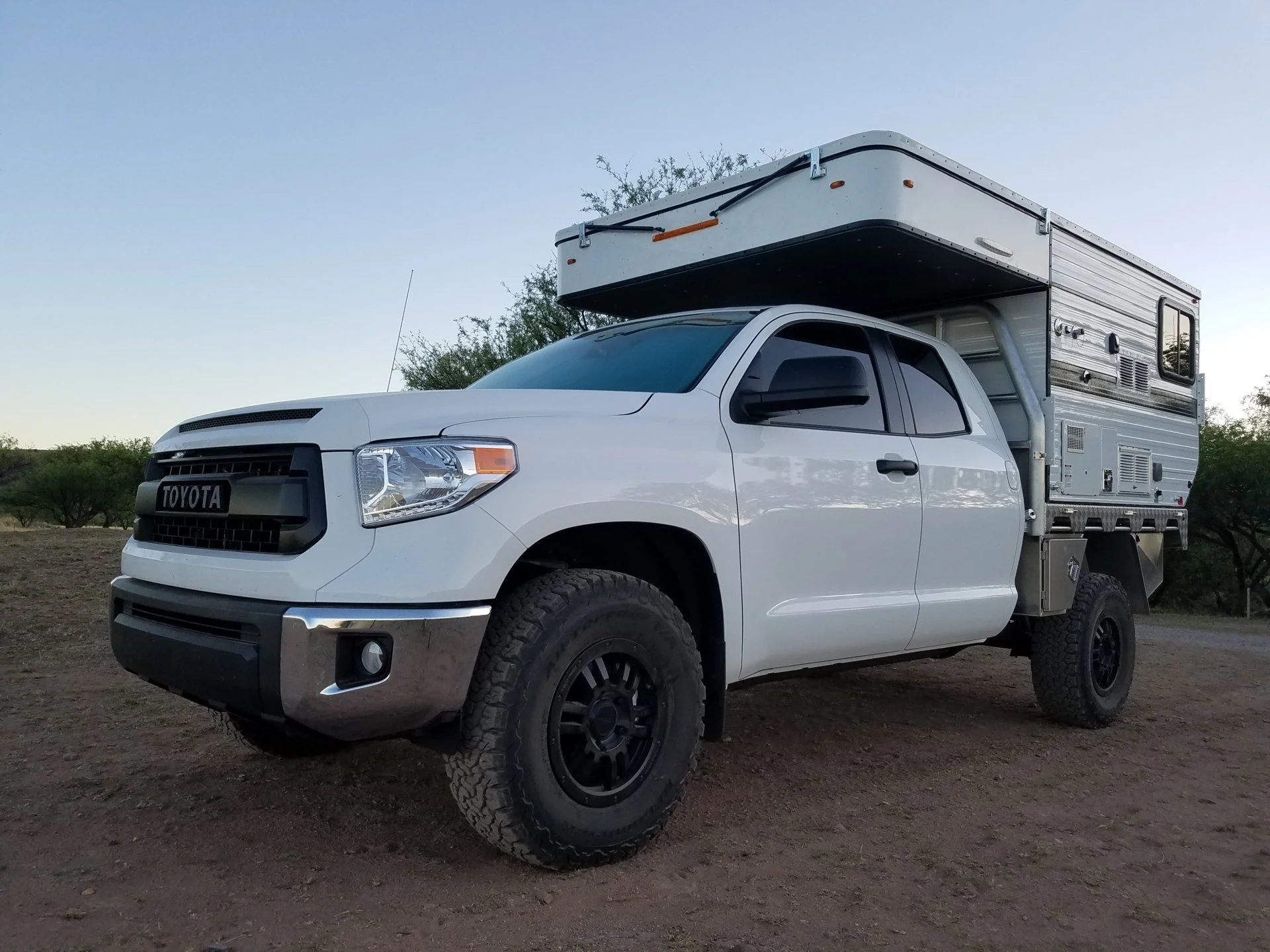

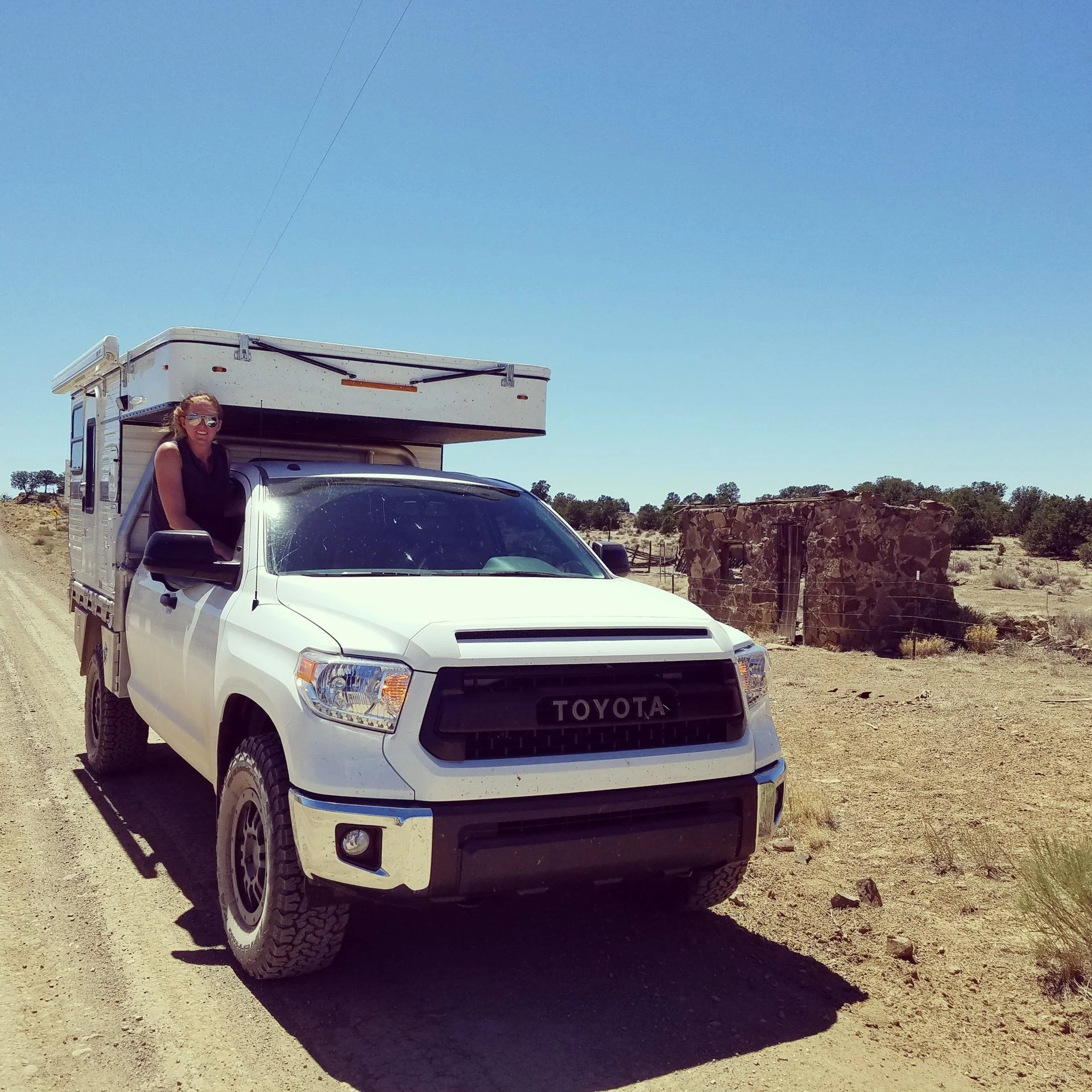

The Tiny House Tundra had it's maiden voyage this weekend...to the Overland Expo!! Great times!
The truck did brilliantly, it was flat through corners and rode great on both pavement and dirt.
Although it was pretty windy on the trip from Sonoita to Flagstaff the truck was super stable. A bit of a relief as I wasn't sure how it would do in full value cross winds.
I weighed the rig before the trip and with 38.5 gallons of fuel it tipped the scales at 7840 pounds. Add 40 gallons of water, two occupants, camp chairs and table, chow and beverages, tools etc.. and it should have put us right around 8700 pounds.
We averaged 65 mph and 10.5 mpg. There were a few spots where the wind died and the truck was quite happy in 6th at just over 80mph. When the wind picked up I needed to slow down to 65-70 mph to keep it in 6th. The best recorded mileage was 11.7 mpg and the worst 10.4, not bad considering how tall it is.

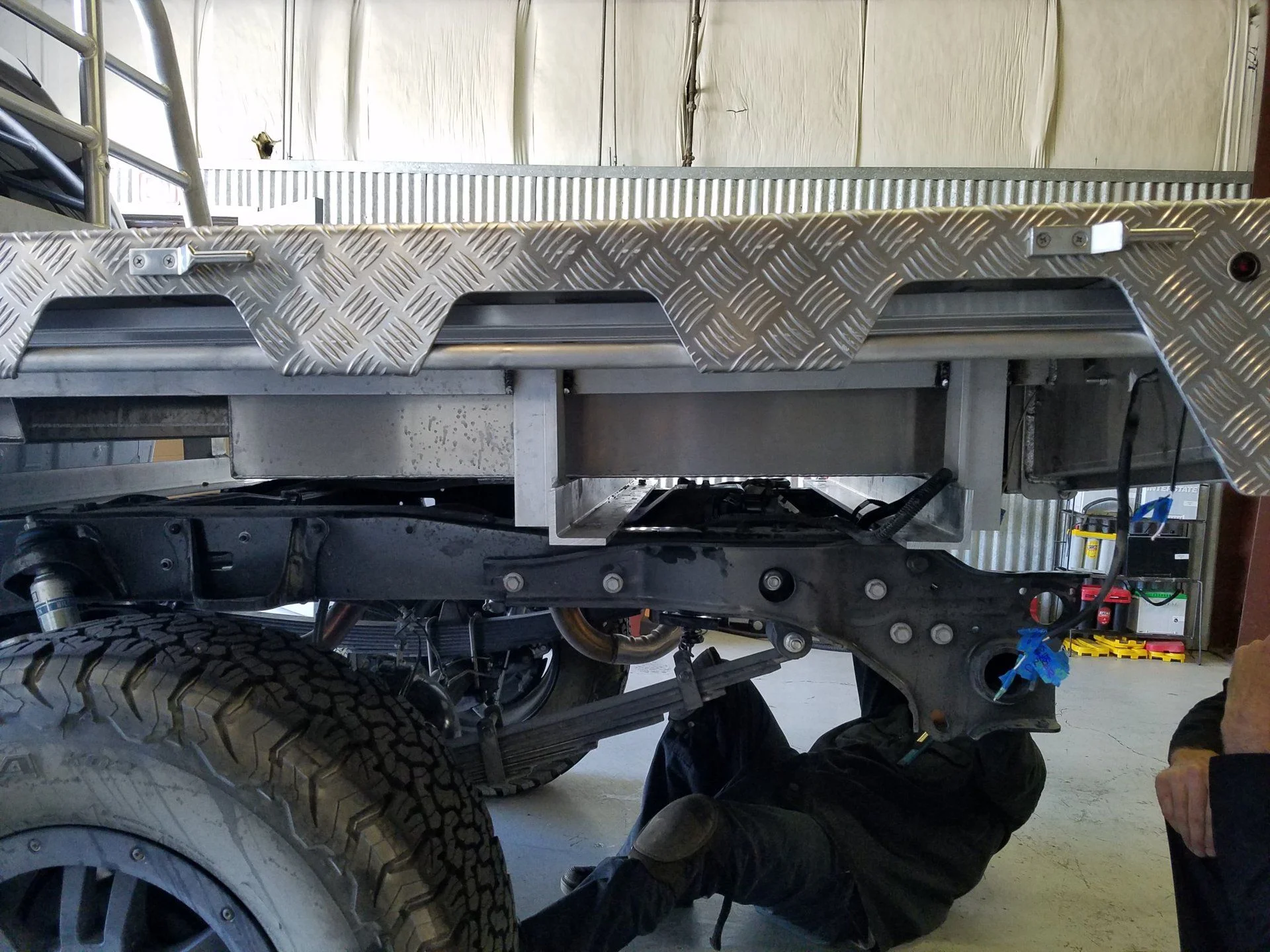

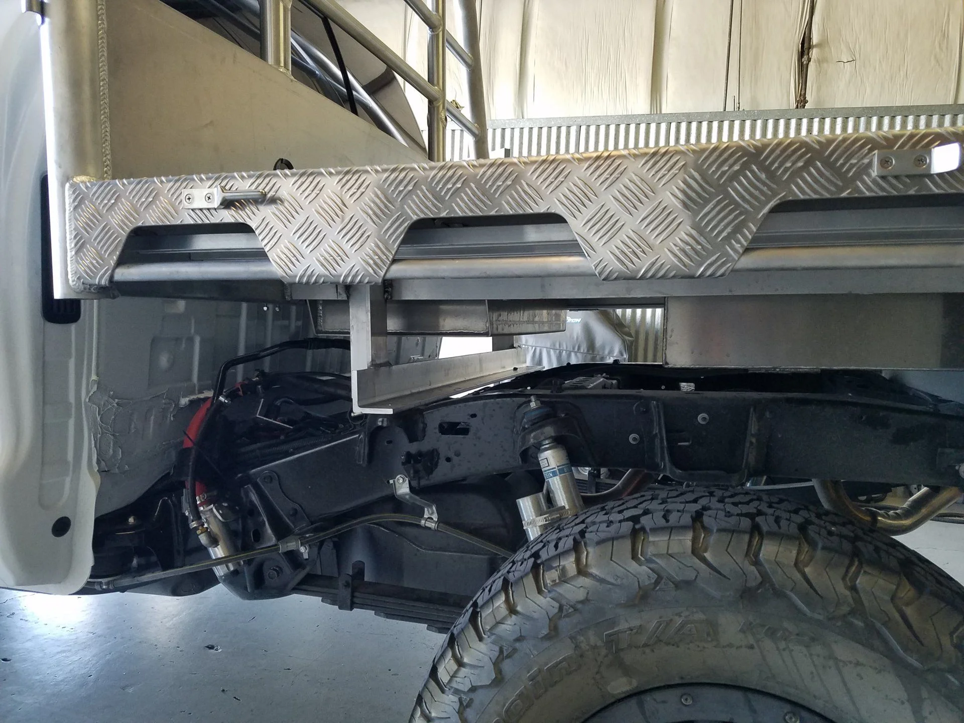

You are correct the flatbed should be have been installed lower. I'm pretty sure it's the first Norweld Tundra bed install and it has been a bit of a science project.
The bed can come down 1.75" as it sits, if I switch to a shallower rear drawer or lower the spare tire winch I should be able to drop it around 4".
Another minor mistake that I'm going to rectify is the bed brackets were welded to the bed, whereas according to Norweld they should have been bolted to the bed. Bolting the bed together allows for a bit more frame flex, when welded the frame can really only flex immediately behind the cab.
I'm not really looking forward to pulling everything apart and grinding the welds off but the end result will be well worth it. Any reduction in height will make ingress and egress in the camper easier and more importantly it will lower the COG and improve the aerodynamics. After grinding all the welds off and determining how low the bed can go the reassembly should be pretty painless.
If I still have room after lowering the bed/camper I may steal your idea and mount a table on the roof. An aluminum rack secured by nutserts holding a lightweight table would be a great use of space.
The underside off the camper came from 4WC painted black.

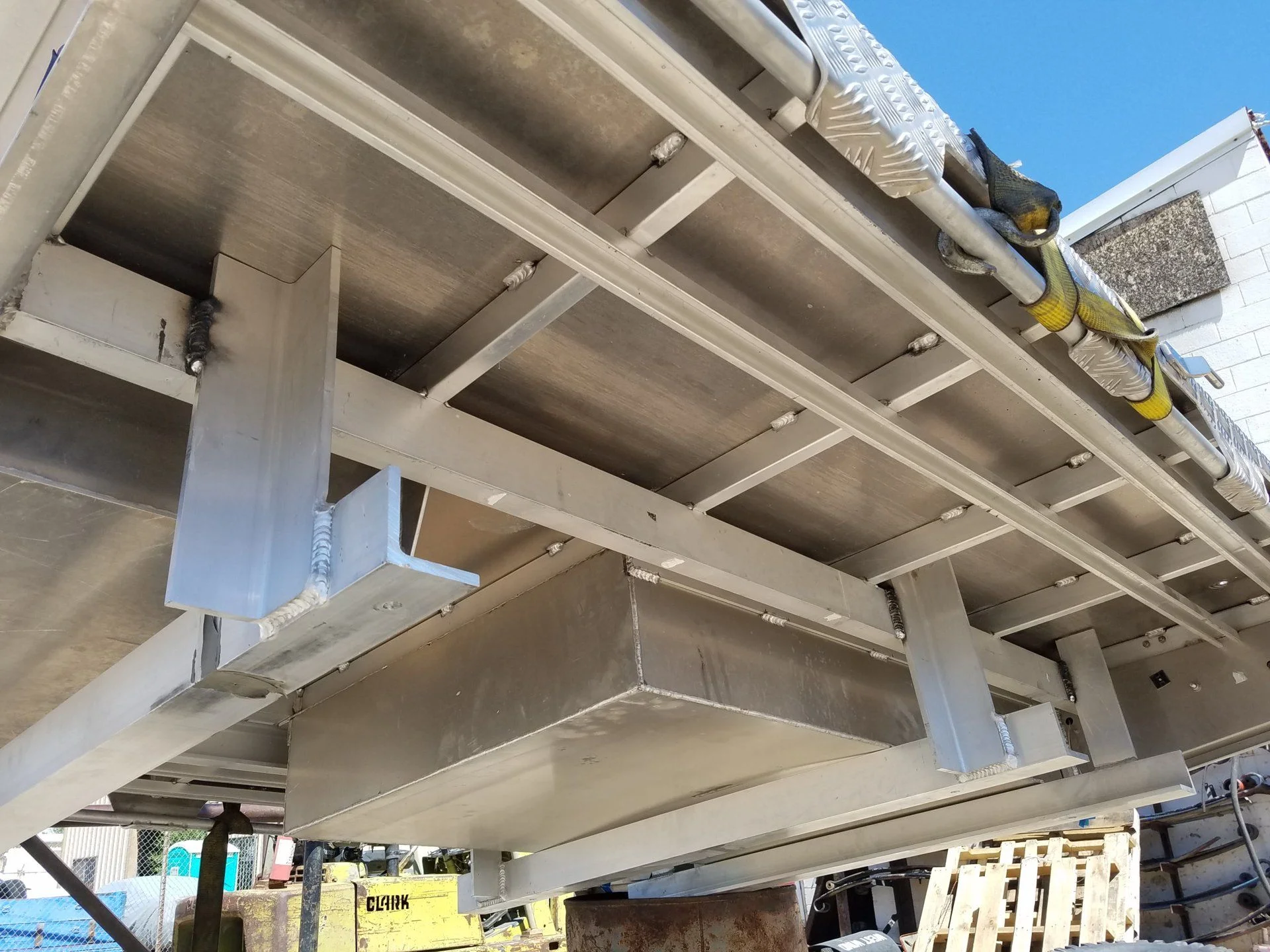

"Custom" jack extensions...
Without the boxes the mounting brackets we'll be modifying are more visible.
The horizontal aluminum angle can be notched to clear the rear drawer better and the vertical angle will be shortened commensurately. We'll be using bolts as opposed to welding to enable the frame to flex a bit better.
