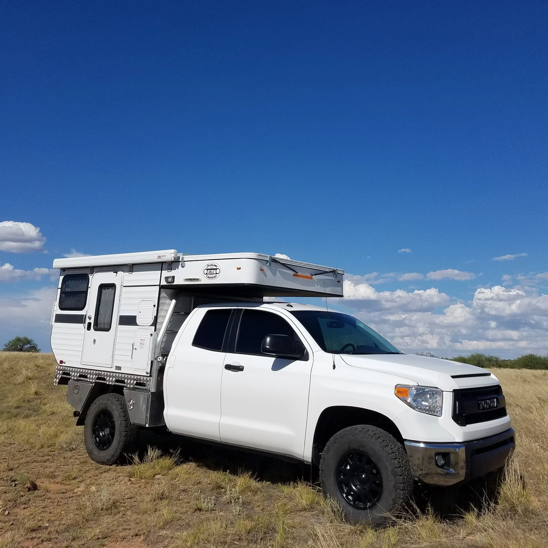

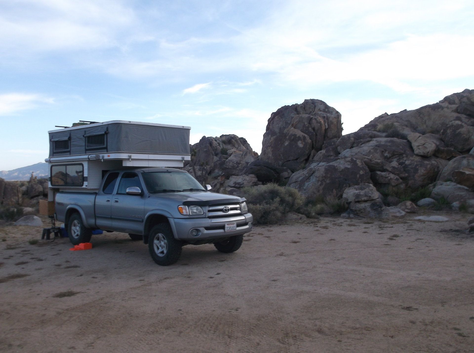

Nice setup. Have had a Hawk on my Tundra for the last 8 years and love it. You can cut down a lot of wind noise up front by adding a spoiler under the front overhang. The unused space can be used to store camp chairs and a folding table- one of the next mods I'm planning for mine. Are you on the Wander the West site?View attachment 1767243
Right on, I've been experimenting with a few spoiler ideas but haven't found the right one yet. Good to hear about your experience with the wind noise.
Nope on the Wander the West site I'll definitely check it out.
Thanks!
Is that a rx2 in front of the Pantera? Really neat Outlander you have created!
Yup!! Well spotted! Very cool ride.
Thanks! It's been a really fun build.

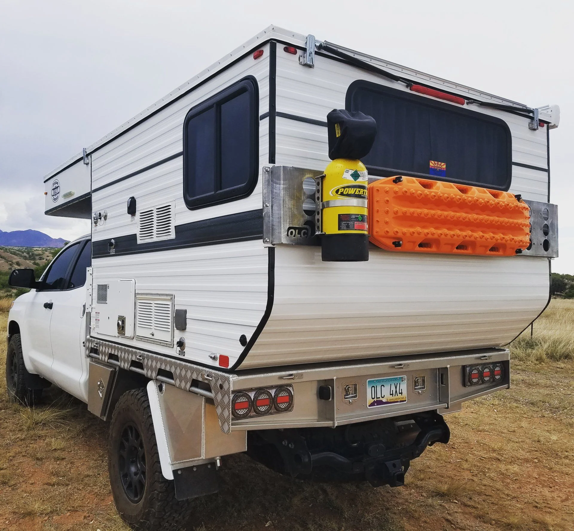

That said the truck is overweight and I haven't had any luck finding a way to re-certify the GVWR.
So...the 4WC is being moved to a platform that can legally support more weight and the Tundra will keep the flat bed.

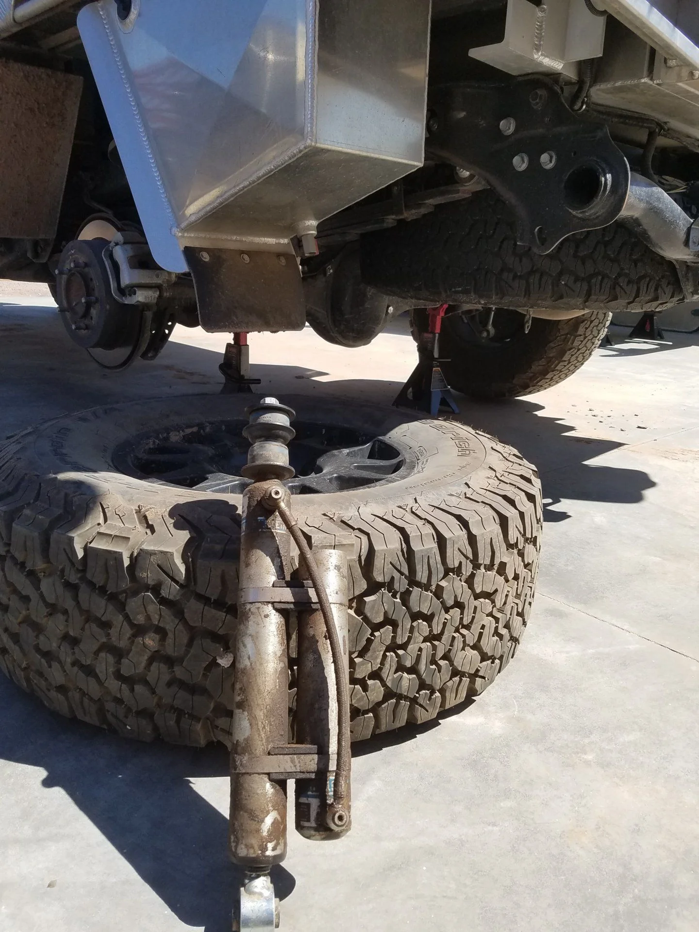

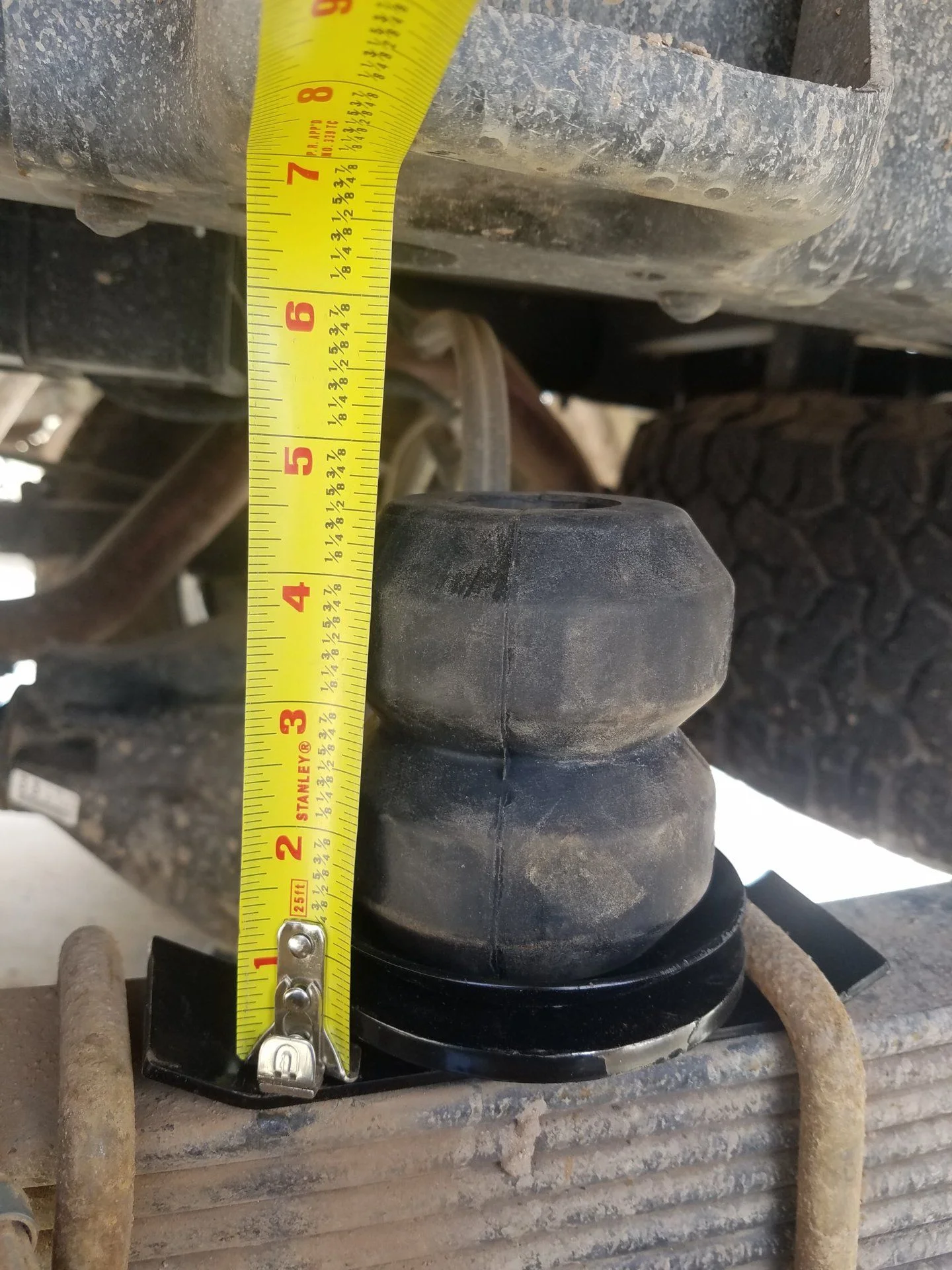

Now I just have to sort out the best spring rates to use now that it isn't hauling around a house.

The truck is overweight according to gvwr or in actual use it is overweight and not performing to your expectations?
Do you know the weight of the camper?
The truck is overweight about 1000 pounds according to GVWR. The truck's actual performance exceeded our expectations, both on and off-road. The suspension came out great and the truck has plenty of power and brake. Towards the end of our shake down I was getting a pretty consistent 13mpg which was impressive (manually shifting the trans seems to make a big difference). However regardless of how great it came out we can't sell it as it is overweight. Originally we had thought that there was a relatively painless way to re-certify GVWR, like an up-fitter for an ambulance, however not so much.
The upside is that the we have bad ass flat bed Tundra to build!! Nothing crazy, just a nice UTE inspired build.
The camper weighs approximately 1745 pounds empty. Add in the propane, water, fuel, food,recovery equipment, tools, etc... and it gets heavy quick.

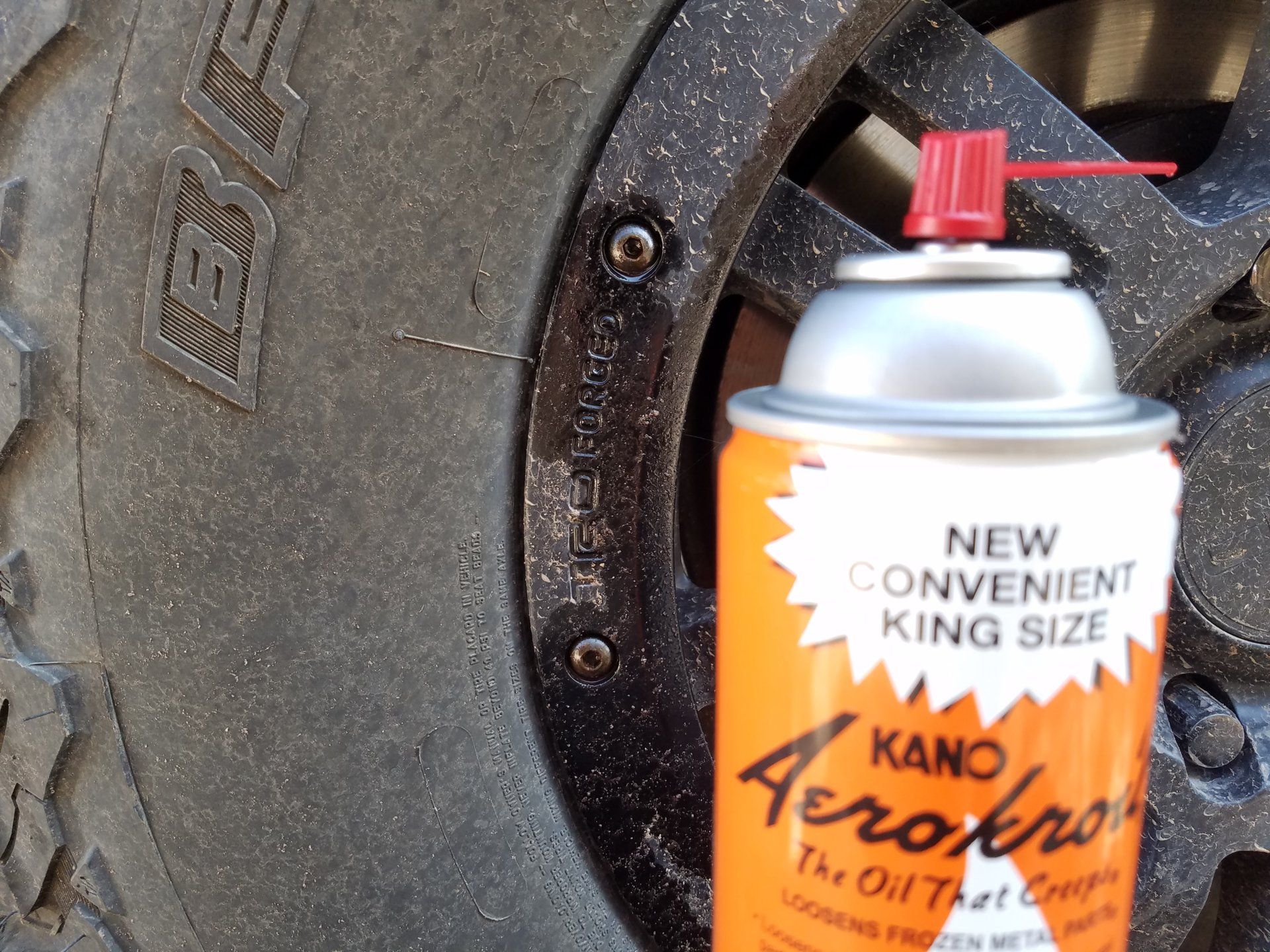

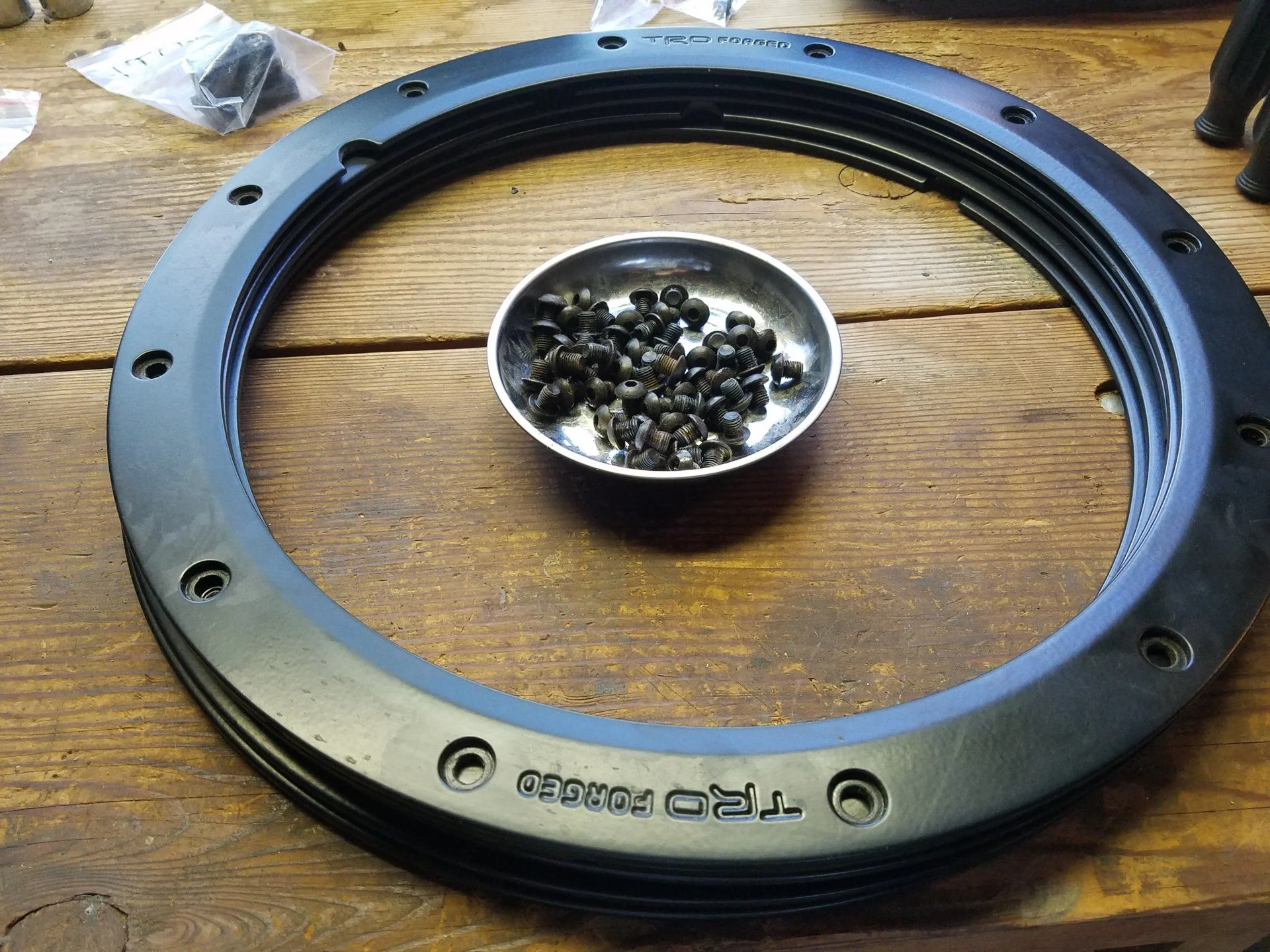

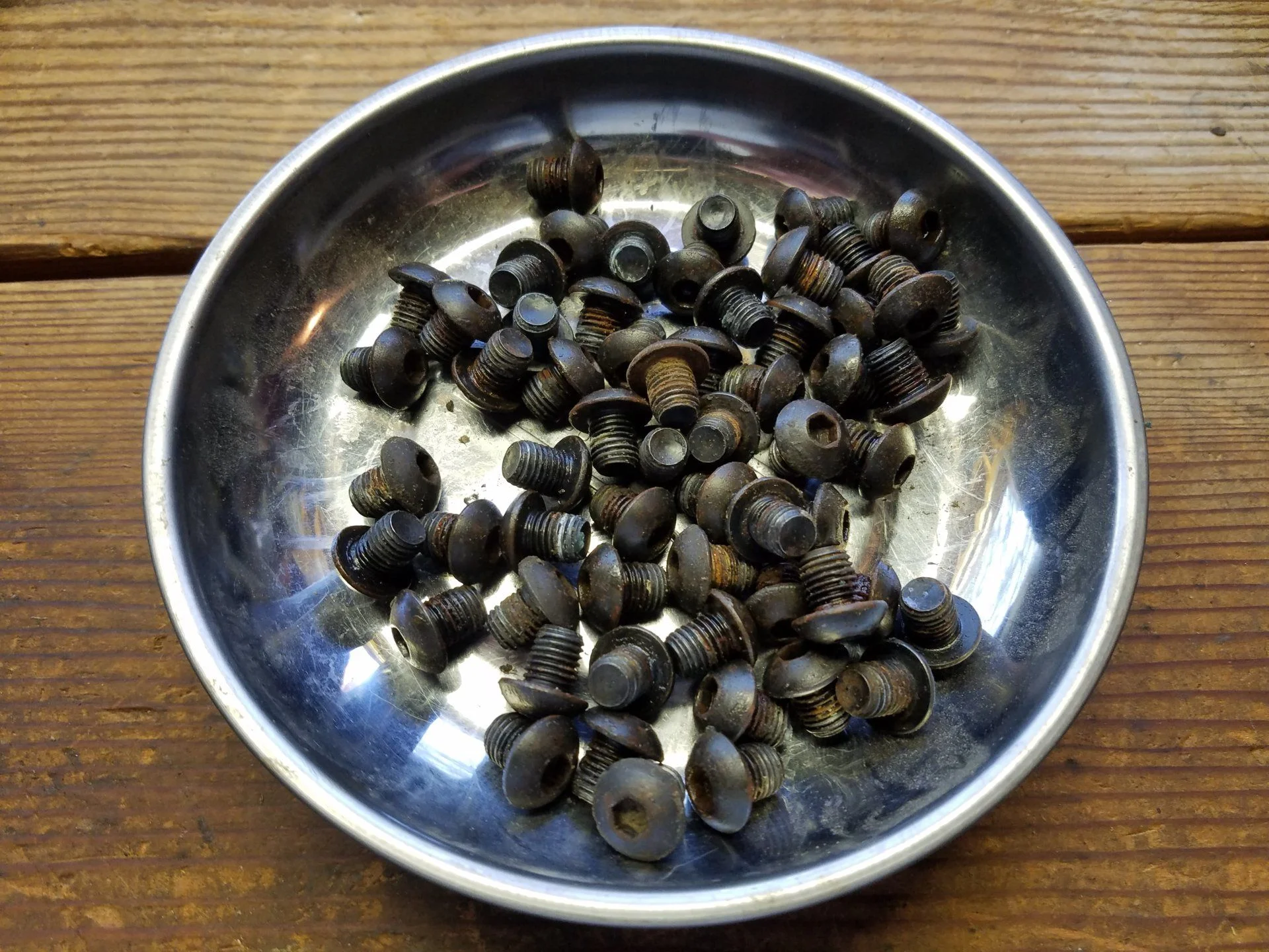

To those who predicted the black oxide bolts wouldn't work well for the RW rings...you were right!
Although I meticulously degreased and clear coated them, the minute we got up to Montana and it started really raining they turned brown.
Luckily they didn't fight too much coming out.

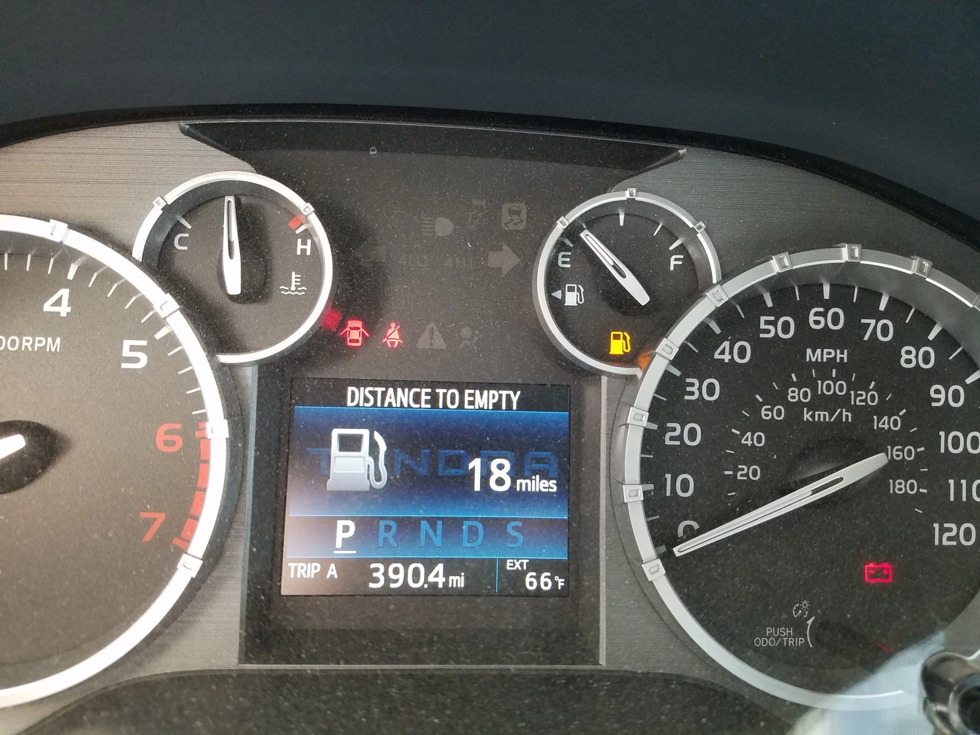

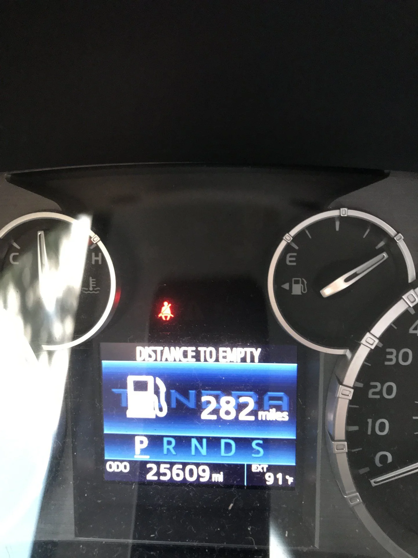

With my '08 Tundra when the screen says I have 0 miles left, the tank has 6 gallons so approx. 90 miles left, mine has to way to small 26 gallon tank, one of the only things I hate about the truck, when I'm pulling a 25' trailer I need to stop for fuel every 200 miles, so lame. After I got the Duramax it became my tow rig. Mileage is amazing 18-20 on highway empty and 13-15 towing depending on grade.
Just filled up but
I got it down to one mile to empty just to see how much gas to fill up. The 24 gallon tank in my 2015 will take no more than 22 gallons.
I heard that the 38 gallon tank can only take 34 gallons, leaving 4 gallons reserve to keep the fuel pump cool.
I assume the extra gas is usable.

We've decided to keep building the Tiny House Tundra!! It has been a really fun build and I'm super stoked to keep it going.
I had been concerned that the truck is a bit over GVWR when fully loaded, however it handles everything we throw at it with aplomb. Perhaps if we were building rigs at a production level we would want to recertify them. On that note we were able to increase the GVWR to 10000 as this one is commercially registered.
We took the truck up to OEX west and it was really great on the highway, I rarely dropped below 80 mph from Tucson to Flagstaff and still got around 10.5 mpg. The Alcan rear springs keep it really flat in the corners and minimize any body roll. The nights at OEX were freezing but the heater in the 4WC Hawk kept us warm and provided an "employee lounge" for daily after action reports.
