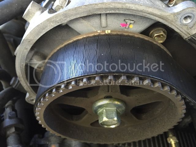

220k original belt on mine. Drove it 1500 miles before I looked at it and saw this....

Mine looked similar to the picture above. When I removed it I tried and tried to break the belt and couldn't do it with with hundreds of pounds of force.
@onpoint01 I never tried but now I'm curious to know what it would actually take to snap. I'd assume the belt would have to be compromised to the point of severe rot unless there was a manufacturing/materials flaw to create a weak point.
