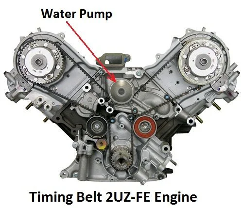

As per other posters, the ancillaries are more important than the belt itself. If you decide on a service, make sure everything gets replaced: water pump, tensioner, two idlers and belt. If these parts were not replaced at the previous service (does anyone only replace the belt only?), then it would be more important to carry out the 2nd service at the correct time.

In any case...a new Aisin Water Pump can be had (shipped) for $80-$95 bucks. The cost or effort to go back in a second time simply isn't worth it, were one to fail.
There are very complete 'kits' available these days (Timing Belt, Pulleys, Tensioner, Water Pump, Crank and Cam seals, serpentine belt) for quite reasonable prices. When mine is due again...it will be getting 'everything' again, but not until I've put 150K on the last change.
