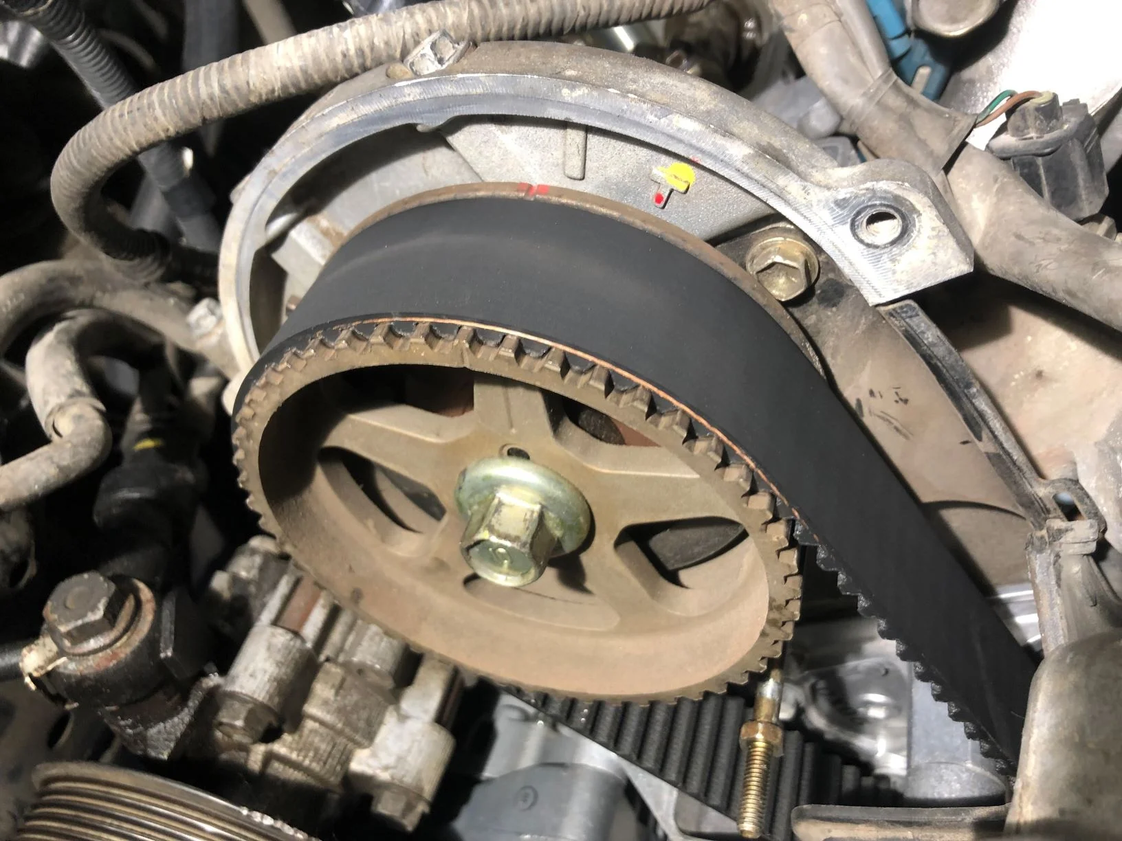

See the pic below. This is TDC compression stroke, the other side is on the mark. It's also making a knocking tapping noise that can be felt in when you put your hand on that cam gear cover. Any ideas?
See the pic below. This is TDC compression stroke, the other side is on the mark. It's also making a knocking tapping noise that can be felt in when you put your hand on that cam gear cover. Any ideas?View attachment 2737932
Looks like the belt is off by a tooth, I'd line it up and see. (Lined up at the line for the cams that are cast in not that T that also got marked red)
Yep, I'd be inclined to remove the belt and reorient all.

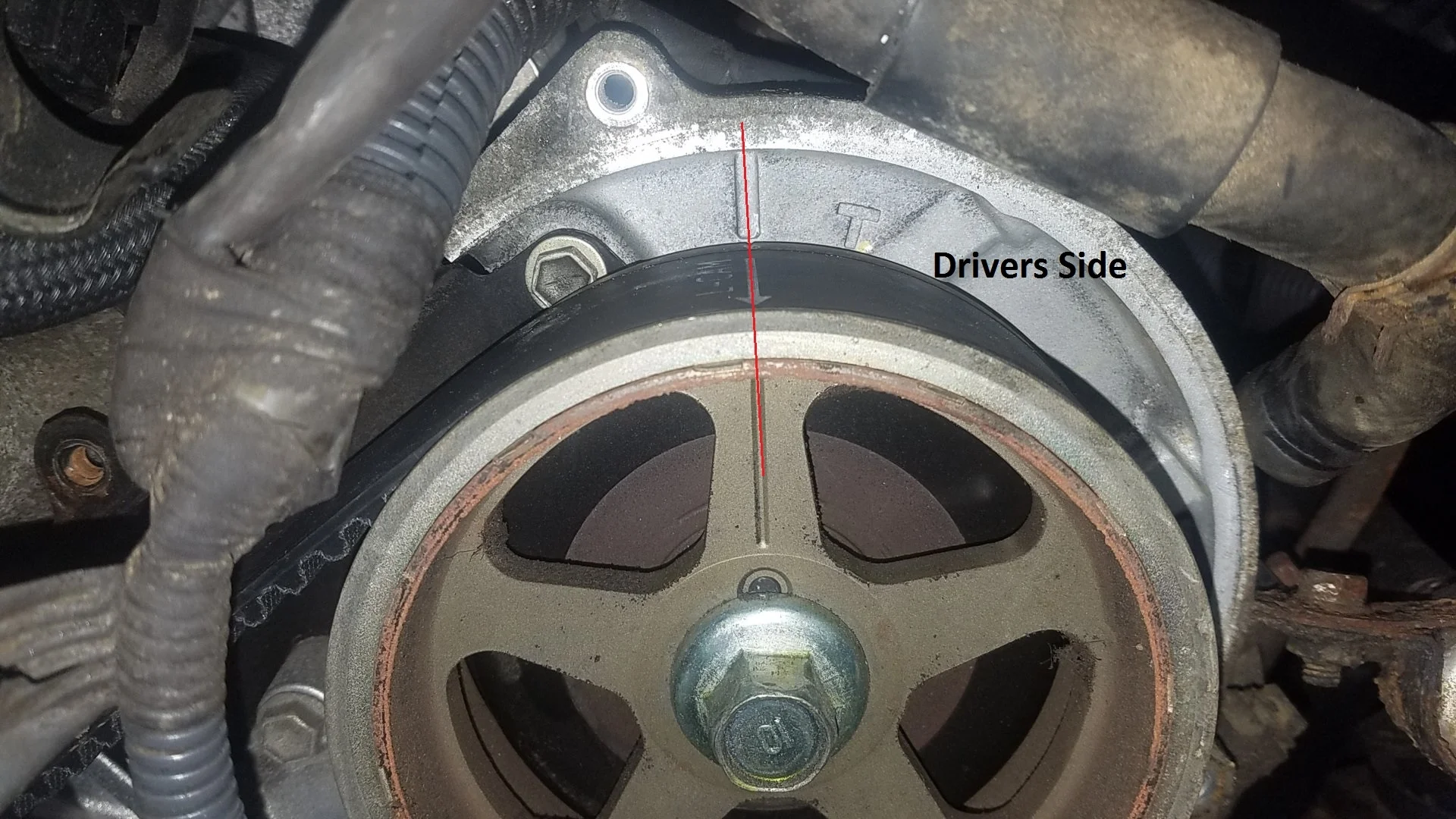

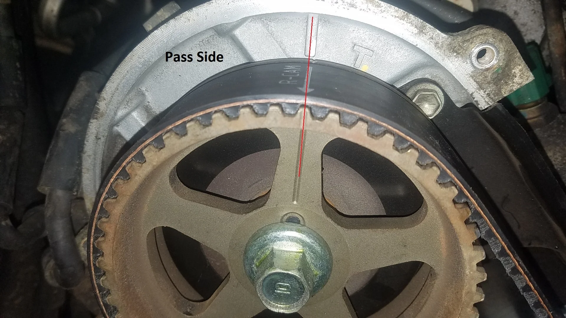

@flintknapper timing belt has been redone. I had pulled the hydraulic tensioner prior to that photo and replaced to see if that helped the noise. I think it must have jumped a tooth when I did that. It's for sure in proper order now.
I went through everything on the front of the motor and made sure it was tight. Put it all back together and the knocking noised is still there. I am homing in on the PS cam gear cover (the aluminum part, not plastic). I can feel whatever is making the noise when I put my hand on it. I checked the bolts on it and everything is tight.
