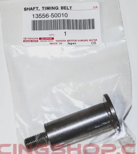

Does anyone know the size of this bolt and the correct Time Sert kit to purchase to repair a stripped out hole in the aluminum housing to the oil pump for this repair?
I saw someone mention M10 x 1.5, but I have no way to verify that.

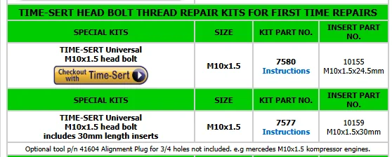

Kits available are:
It's my first time using time sert for a repair.

I just went and checked a spare one I have (from a old dead engine) - it's M10x1.25.
Awesome thanks so much for confirming, almost bought the wrong kit.
As someone who had to order a left-hand threaded M14 helicoil kit from freaking Australia (because it was the only one in the world I could find) for a Jeep Liberty CRD idler last year, I understand not wanting to drop the money on a nice insert kit only for it to be the wrong one!
Actually, nevermind on the length. The standard one is .5" deep, that did the trick.
