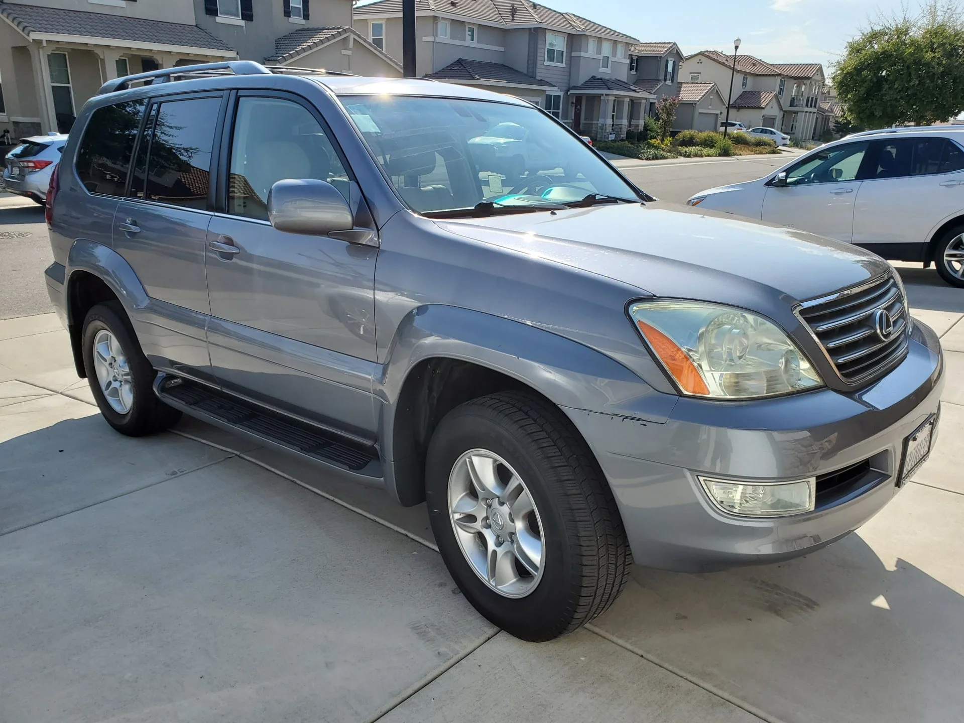

Greetings! I'm new to the GX forum having just bought a clean California 2005 GX470 with 102k miles on it. I plan to build it up over the next few years but I wanted to say Hi and ask my first question. There is no engine sticker confirming that the timing belt was changed, but the CarFax report said it was done at 62k miles or 10 years after initial purchase (by a shop in the SF area- not a dealer). The GX wasn't driven much and was well maintained, so I would like to believe the shop convinced the owner that the timing belt was good preventative maintenance at 60k. I even called the shop in question and apparently state law prevents them from sharing records from other people, but the shop owner said that CarFax records are based on an algorithm that analyzes the repair invoices, so the only way for "Timing Belt Replaced" to show up on a CarFax report is if the belt was actually changed. But there's no sticker anywhere in the engine compartment.
That being said, is there any way to verify the timing belt was actually changed? Can I open up a cover or panel to look at markings or condition of the belt? I feel moderately confident that the job was done, but I wanted to get your thoughts. Thanks in advance- and I look forward to posting pics of the buildup. Cheers! - Zipp

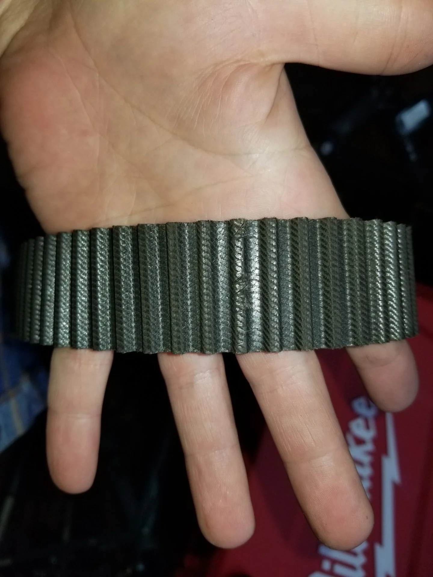

I recently helped replace a 20-year old OEM timing belt with 132K on it from a 2UZ-powered Tundra. The belt "looked" fine at first glance, but after more inspection with it off of the engine, it was definitely stretched and had some areas where the rubber was starting to fray. I am not sure it would have lasted much longer without failing/breaking. The Tundra ran much better with a new belt (likely due to the cam timing not wandering as much).

It did make it to 20 years, but was pretty close to the end of it's life :). The fibers were starting to fray (see below). It was an extreme case, but the timing belts will eventually wear out (although they can likely go much longer than the replacement interval - as this Tundra demonstrated).
The water pump on that Tundra actually looked great - no weeping or leaking at all, but it was of course replaced anyway.
