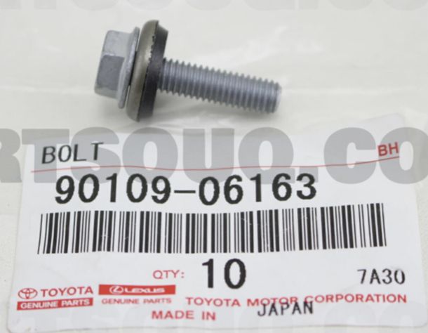

Is there a part number for those bolts?

Use Toyota FIPG.
Here’s a list of part numbers:
Valve cover gaskets:
11214-50011 for driver side
11213-50031 for passenger side
New valve cover bolts with washers, 9 per side: 90080-10330
Spark plug gaskets: 11193-16010 (left) 11193-70010(right)
Oil filler with gasket: 12196-50010
PCV valve: 12204-50020
Grommet: 90480-18001
Ventilation hose: 12261-50050
Foam covers 12235-50010 and 12235-50010
FIPG: 00295-00103
Spark plugs:
Denso 4702 IK20TT Iridium TT Spark Plug
SKU: #IK20TT
