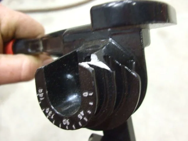

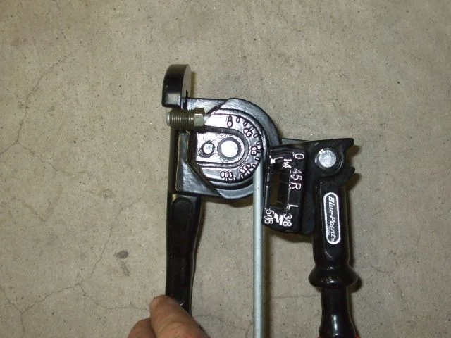

I have searched and searched for a brake tubing bender that will give me a tight radius. The problem I was having is the long nut on the Metric 3/16" Japanese brake tubing would not allow the end to fit far enough into the bender part.
I saw the one from Summit Racing and thought that would be a good one. Well I was on the Snap On truck getting some heavily abused items taken care of under warranty and asked what he had. He had the same tubing bender that Summit had, it just said Blue Point on it and cost $12.00 more than the one from Summit. With postage, the Summit one would have been more.
I ground just a bit of the bender portion and now I can bend the tight radius I needed.
The top picture is where I ground the tool out.
The middle picture is how far the long nut fits into the bender.
The bottom picture shows the radius using an American Quarter on the inside radius and an FJ 40 Trunion bearing race on the outer.
I'm happy with the results.

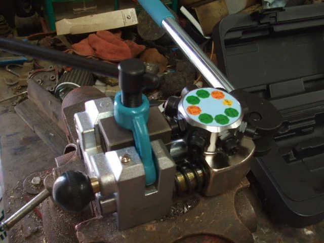

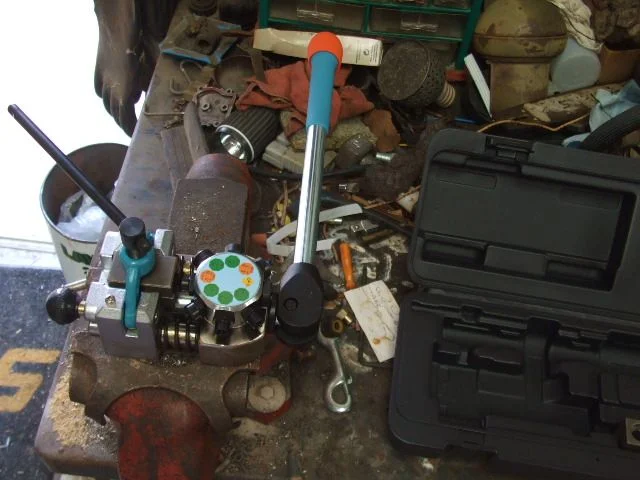

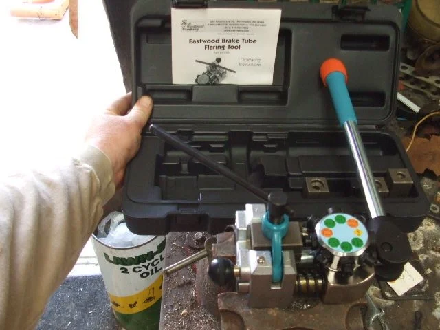

That Eastwood Tool looks like a WINNER! After spending many hours trying to build new brake lines for my 69 fj40 and failing most of the times, I will be buying that tool for sure. Wished I would have known about it a couple of years ago. Thanks Poser!!! And thanks D' Animal for starting this thread!!
Twenty seconds, MAX, and I have PERFECT FLARES, EVERY TIME.
That is priceless.
