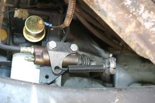

Has anyone done this lately. This noise is driving me nuts on my post 85 60. I think if the slave push rod was shorter is would actually return enough and not squeal without an added return spring. All I have to do is barely push the fork toward the slave and the noise goes away. I don't have a welder or I would try and rig something up with a spring before it makes me drive off a cliff.
Get a rod from a 40 and use that. You then will be able to adjust it. I do this on my conversions depending on the adapter they used, and it still looks stock.
if I put on an adjustable rod from a 40 then will I have to drill a hole in the clutch fork for the rod to go through?
Does the return spring in the slave just get weak over time. Maybe if I just replace the whole slave which would have a fresh return spring the rod will go back in further and stop pushing out the fork. I could just hack off a bit of the rod but then I worry it might be too short to work the clutch fork.
Well I replaced the slave and at first the noise went away but it came back. The good thing is that the clutch operates much smoother. I think I'm going to try shortening the extra push rod off the old slave and see if that works. Then I will try using at adjustable push rod or something. I'm trying everything before replacing the thowout bearing since I can't afford to have the truck down because it is my daily driver.
Last night I shortened the push rod a bit and still have the noise, not quite as bad. I guess the only solution is to put a spring on it which means I am going to have to buy a welder. Does anyone have a pic of this particular rig job, the spring addition that is.
Make or buy a small L bracket from HomeDepot. Drill the hole in the arm and the bracket. Use a universal spring from Autozone that you can shorten yourself and that should do it. Sorry at work and can't get to my pic's.
Found this pic on the search...
attachment.php
