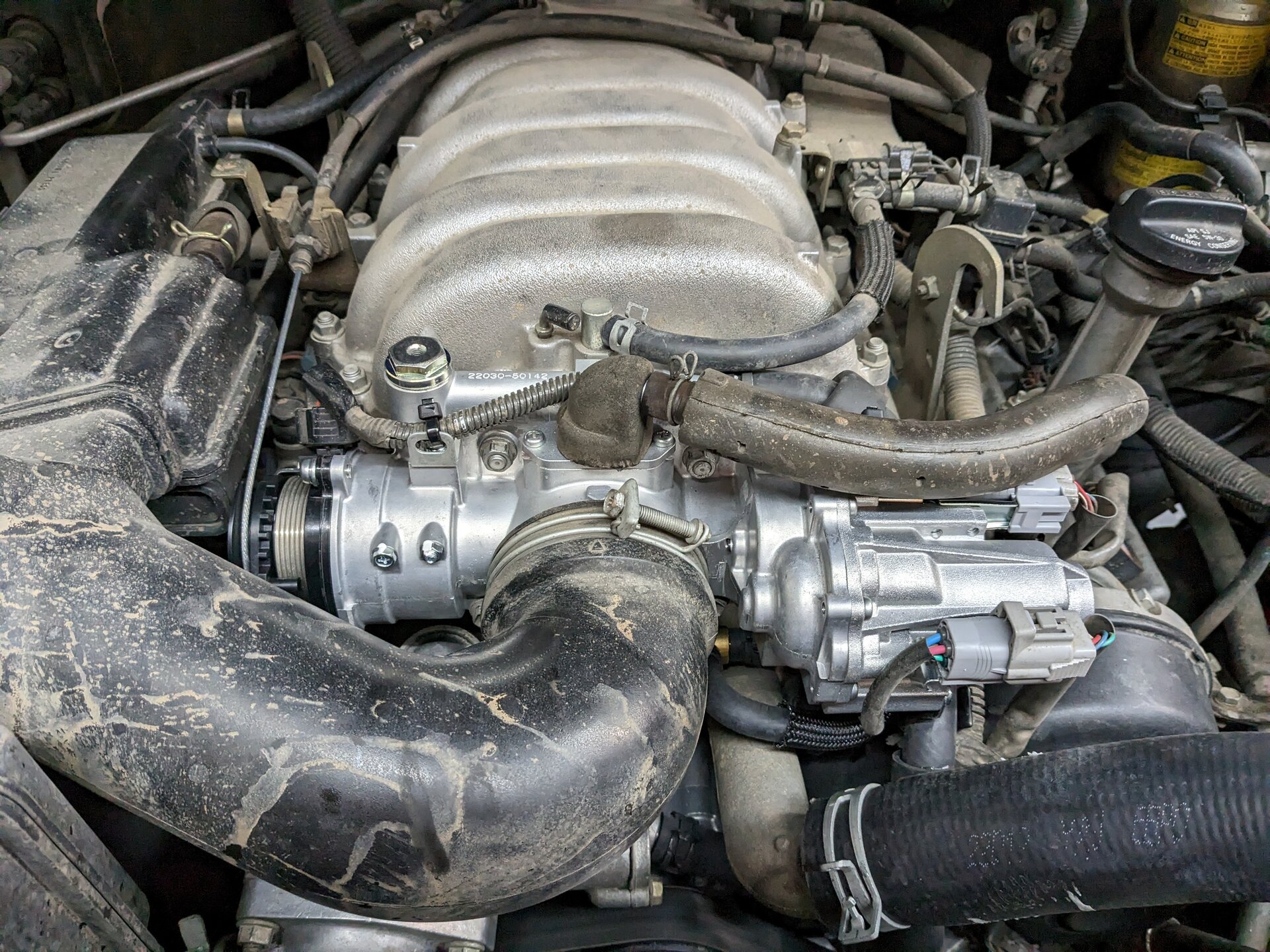

I picked up a new throttle body assembly on info found in another thread that the buzzing from my motor meant it was bad. Well, that info was wrong and everything tested out to the same specs as the new unit.
Anyway, if you need a hang with this and can get to Loveland I can help you out. It was a very straight forward swap. The only unexpected thing was needing new coolant bypass hose and clamps for the 5 inch segment under the TB assembly. I have extra now.
I did pull the battery cable and pump the pedal a few times to reset. Started right away, no issues.

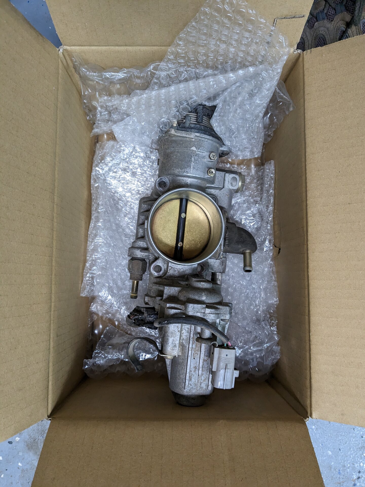

I have my old TB in box, everything tested to spec. And is in working order.
