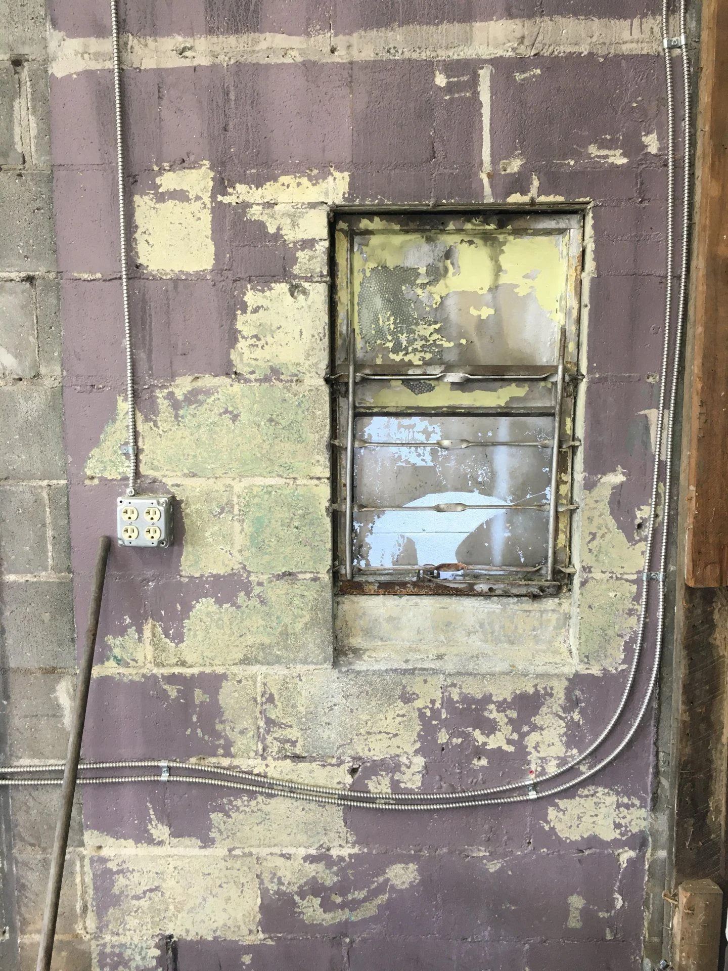

Small update. My cousin’s been going nuts getting every loose paint flake off the wall. I think we’re going to be able to start the wall repair tomorrow (then we can invite the structural engineers back in).

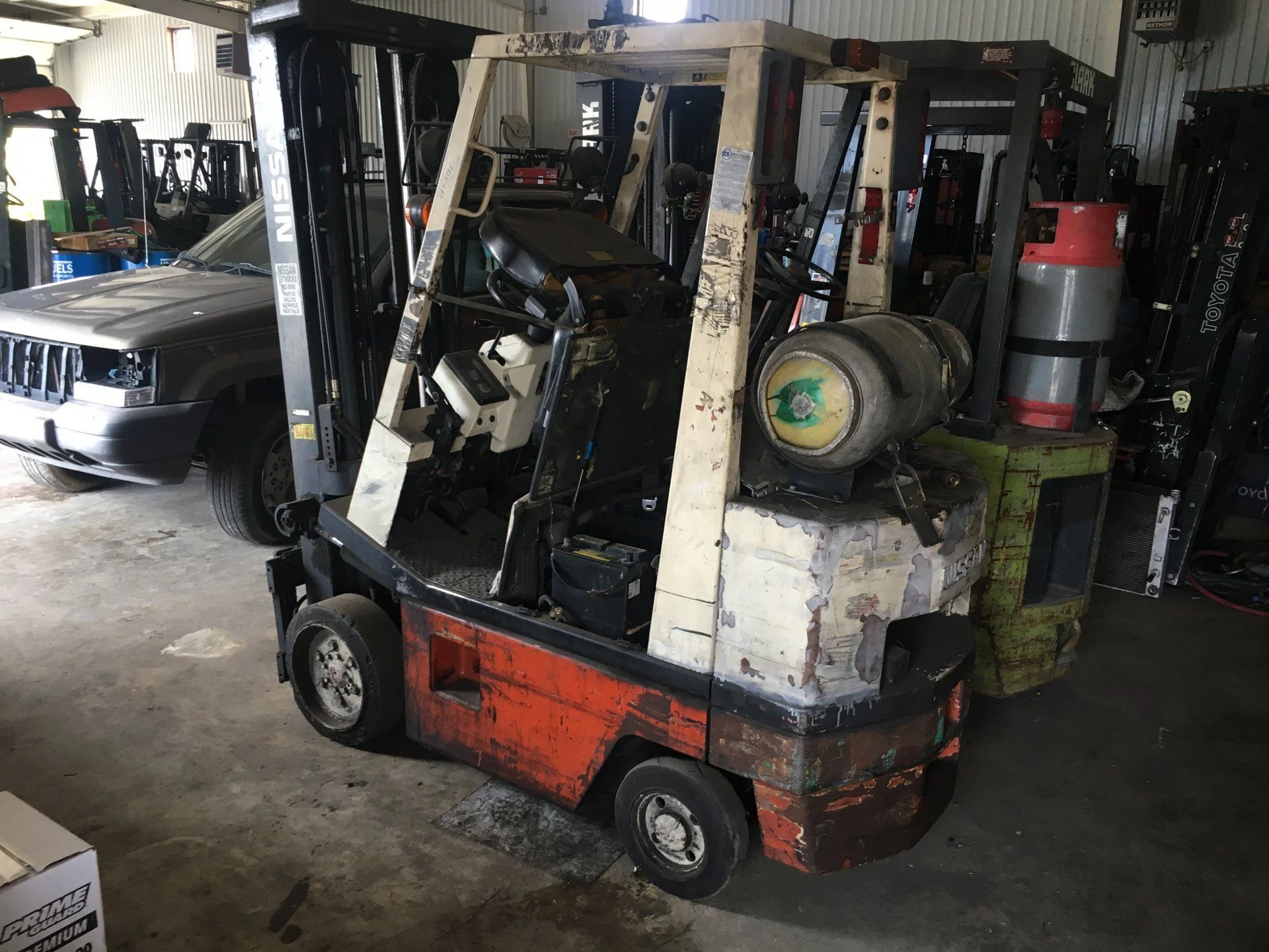

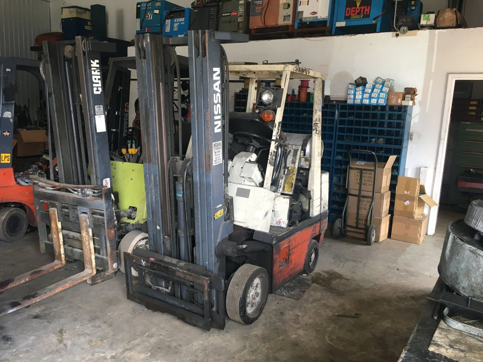

Last but not least, I went to see a man about a forklift today. He had one of those Nissan’s @dnp was talking about:
This 3000lb beauty is from one of his service accounts that recently upgraded to something newer. This needs a new water pump and leak check before it’s ready.

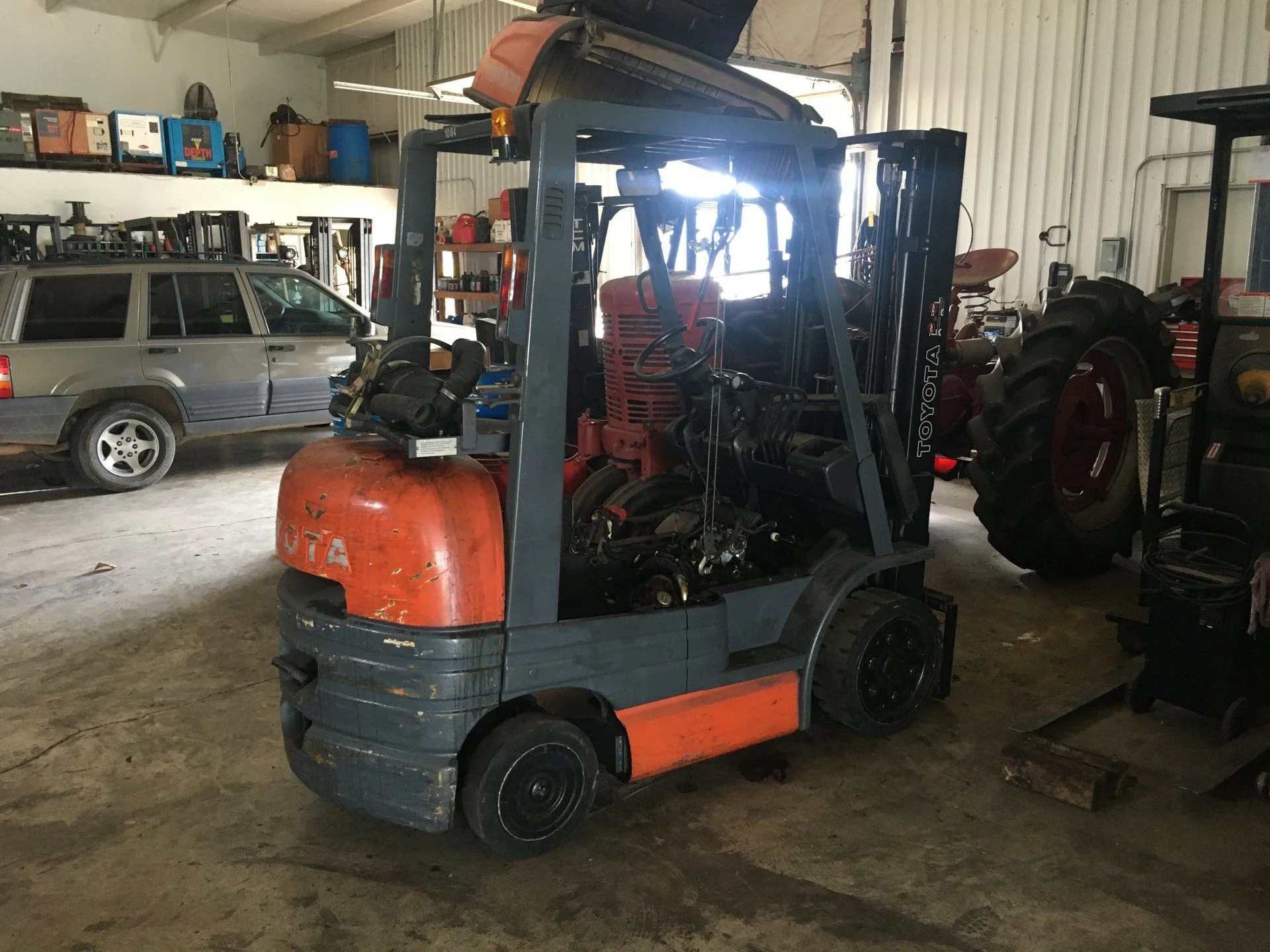

While that is pretty cool, he also had a few Toyotas :grinpimp:
They’re putting a new motor in this guy, but it should be ready soon.
We’ll convert it to an EFI’d 4.4L 2F down the road.

Yeah, I gotta say, even though my Nissans work great, and even though the Toyotas are usually more expensive (sometimes, a LOT), I'd really like to have a Toyota. Just because.................(then again, I haven't checked to see if they're @jrob-approved)
We had a Nissan liftruck at work for years and years, total workhorse.

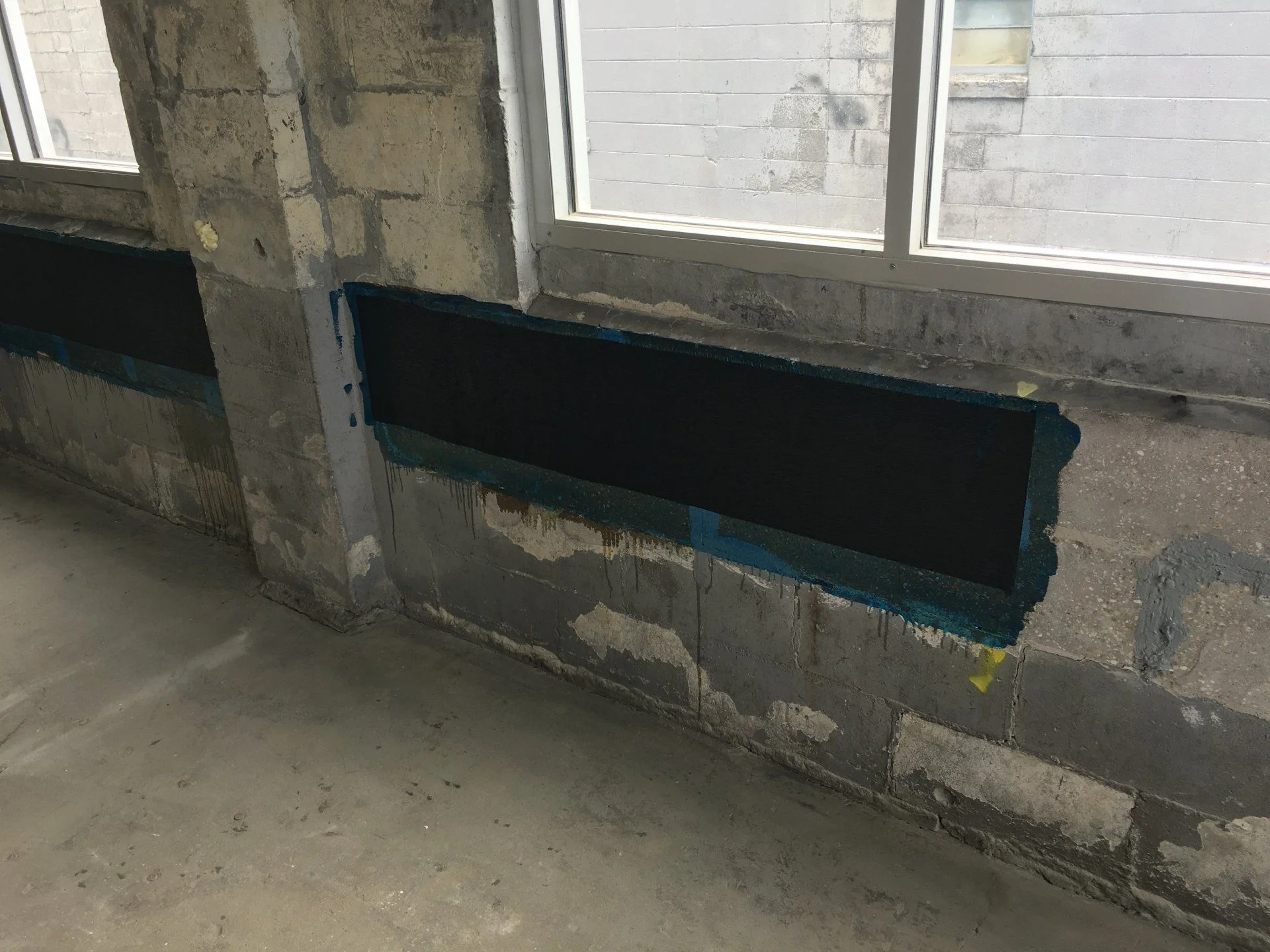

Wall repair has begun.
I almost bailed on this building when I saw some of the settling cracks in the wall. I wasn’t worried about it falling down necessarily - this is an old building, they’ve been there a while, and nothing is leaning or out of square - but I definitely wanted to do some sort of reinforcement.

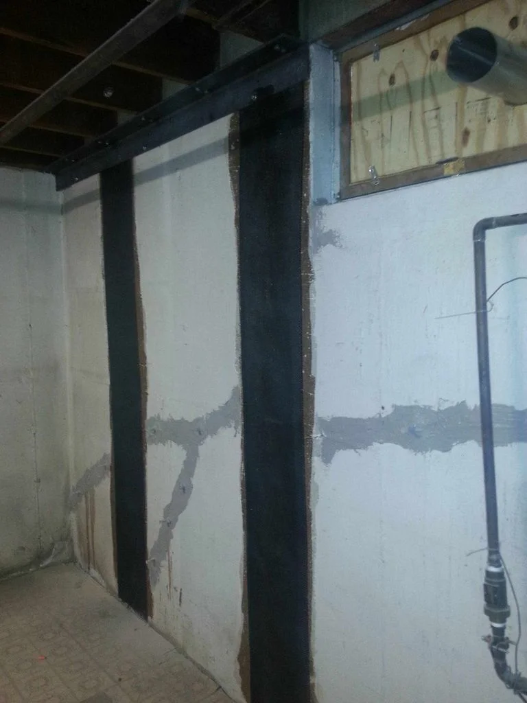

When doing some research, I came across a carbon fiber reinforcement system that is used to strengthen and shore up damaged overpasses, columns, and other concrete structures. Carbon fiber is stronger than steel, light weight, and is fairly easy to apply, so I was intrigued.
These days it is heavily marketed for the residential application of bowing and cracked foundation walls. All of the foundation repair companies seemed to be promoting it.
The process is fairly straightforward:
- Grind wall down to fresh material
- Fill cracks & mortar joints with two part epoxy
- Apply two part epoxy primer with a roller
- Roll on two part epoxy bonding agent
- Apply carbon fiber sheet and roll out air bubbles
- Roll on a top coat of the expoxy bonding agent.
- Peel out
I didn’t take any pics of the grinding process. Even with a vacuum attachment and a cyclonic pre-filter for the shop vac, it’s a messy and time consuming part of the process.
Fast forward to the end result, though, and it looks simple:
Since it’s strength is in tension, you want to apply it perpendicular to the crack. It is structural, not visual, so it is not meant to be applied over the entire crack.
Stairstep cracks get a sheet in both directions.
