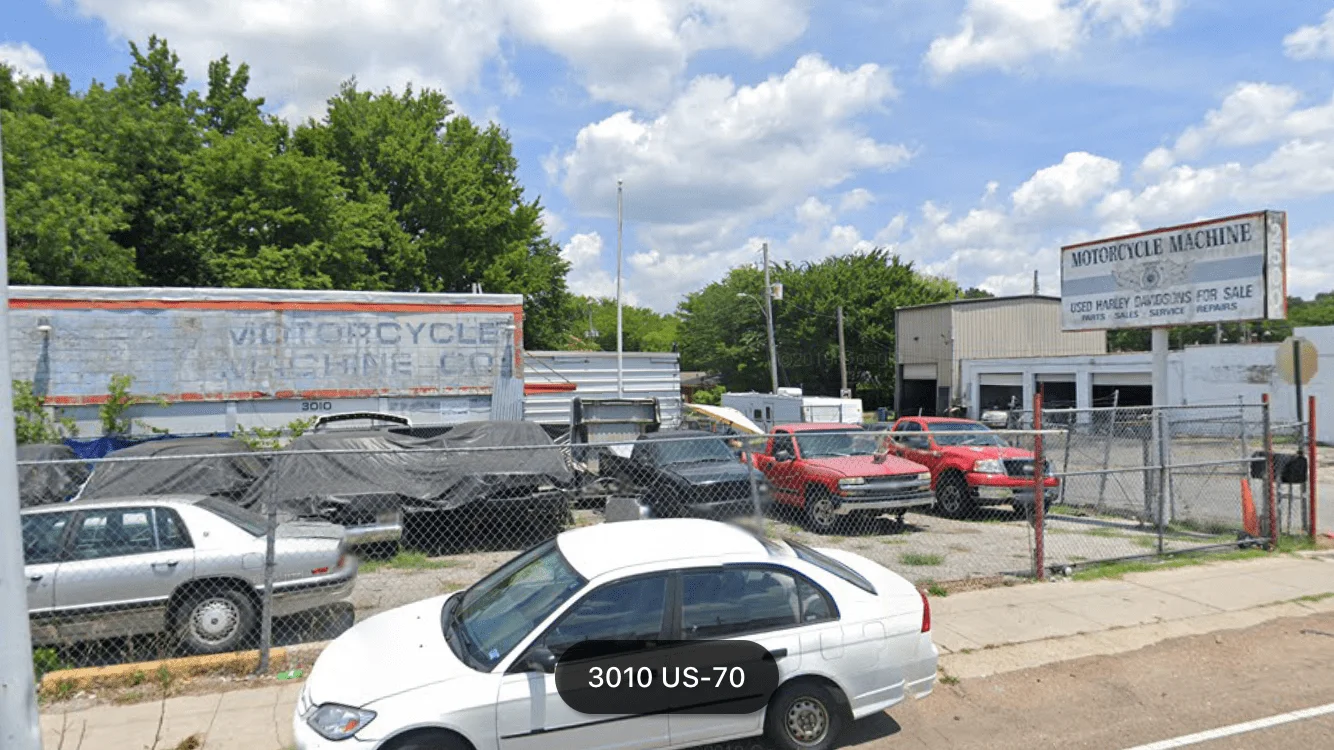

On the other side is the Motorcycle Machine Co...
(found this on the Internet from back of an old motorcycle magazine)
He’s no longer in business, but still lives there. Turns out he used to work at Lunati Cams back in the day (the brains at my machine shop did as well), which was a huge Memphis performance institution before it was sold to Holley, which squandered the vast talent and knowledge and most of the local resources were lost. Lots of Memphis “Mafia”-ish history there (Platinum Plus anyone? That was the most legal of their enterprises). Comp Cams is a cleaner, more corporate descendant of Lunati.

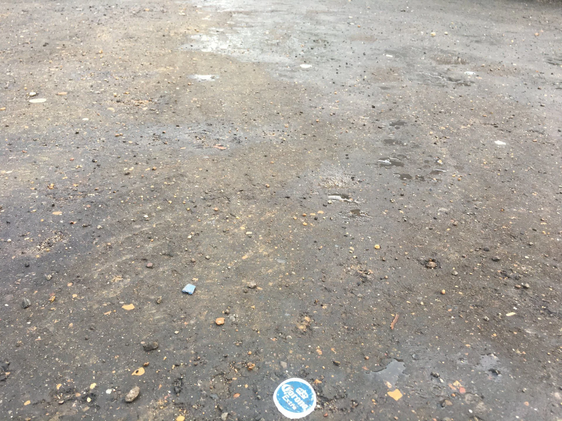

Unfortunately the Coronavirus has been discovered on the property. The soft asphalt is infected with dozens of cases of embedded sores. Maybe hundreds.

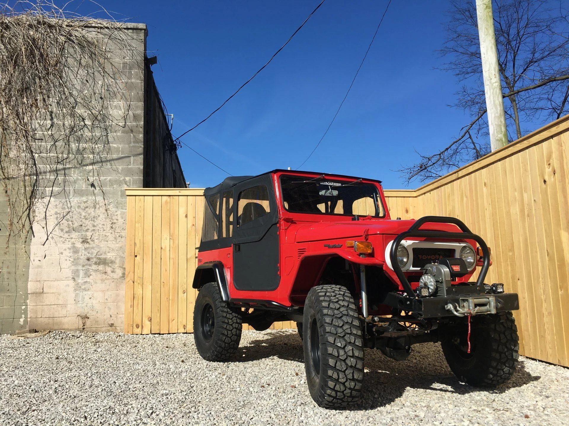

@southff4 ‘s monster FJ40 is moving closer to the Rubicon to live with @MountNGoat in sunny California.
I gave it the once over for Steve and took it by the shop to pose on the new gravel...

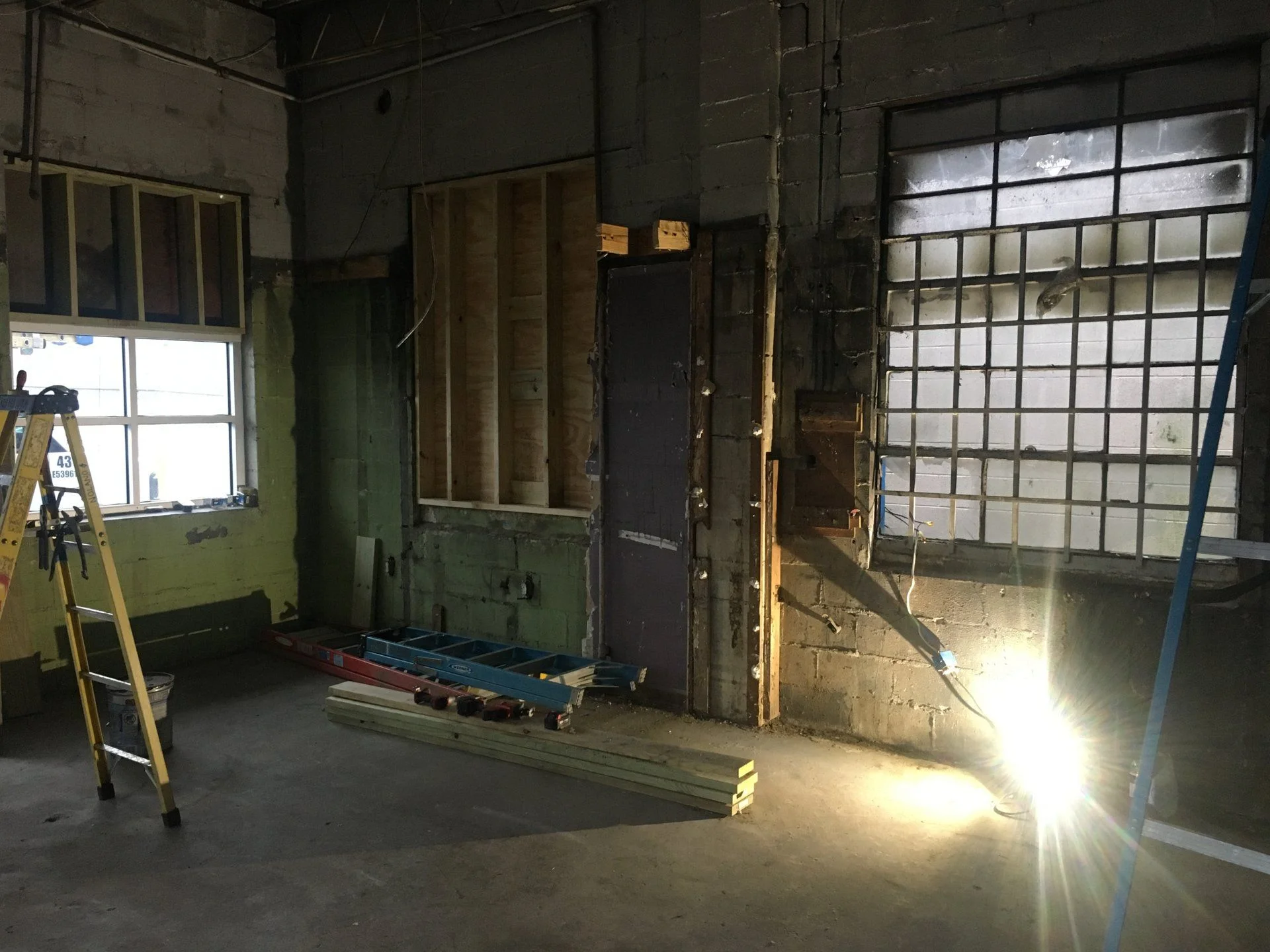

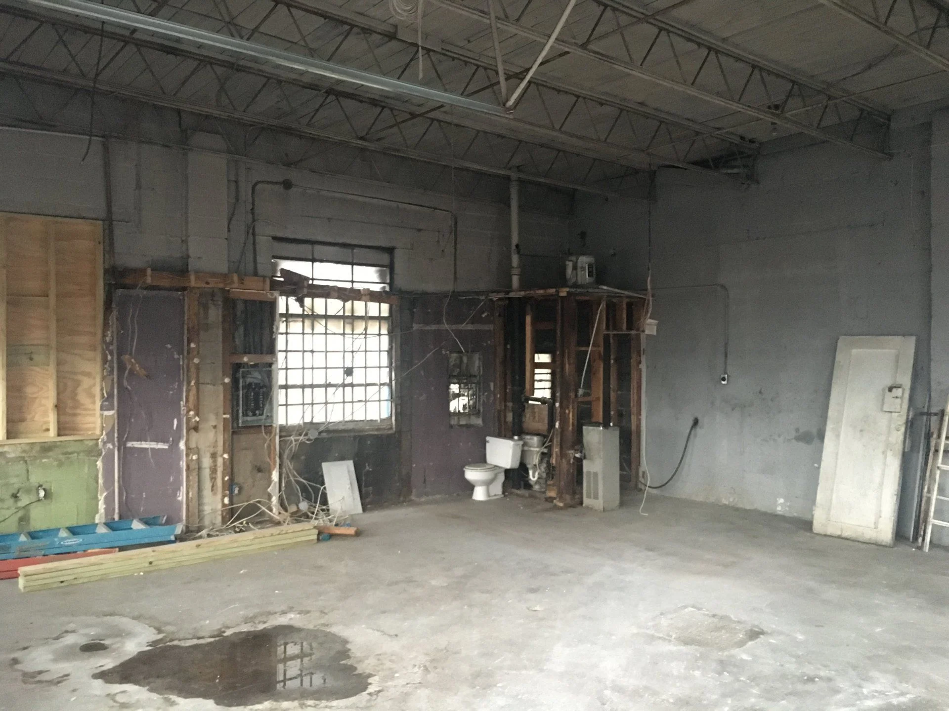

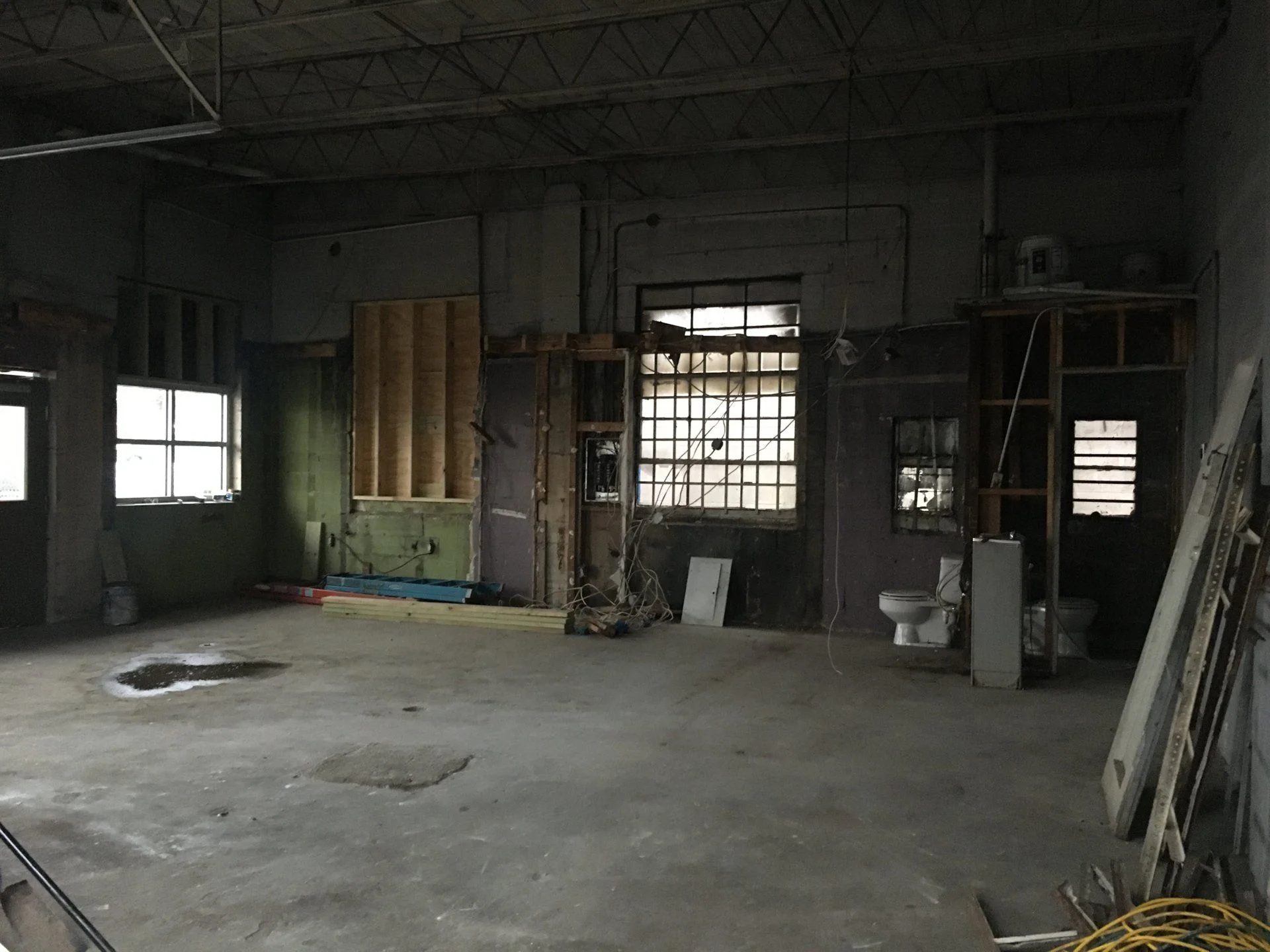

Gloomy weather = shop progress. They got the rest of the office torn out, along with the executive restroom.
We’re going to a species-neutral single restroom setup to maximize floor space. I’ll repurpose that plumbing for a general purpose shop sink.
Roof definitely has a a drip, so I’ll need to chase that down. I also need a more extensive electrical overhaul than I had hoped.
On the plus side, the restroom window is in great shape (relative to the other ones), so I’ll keep it intact.

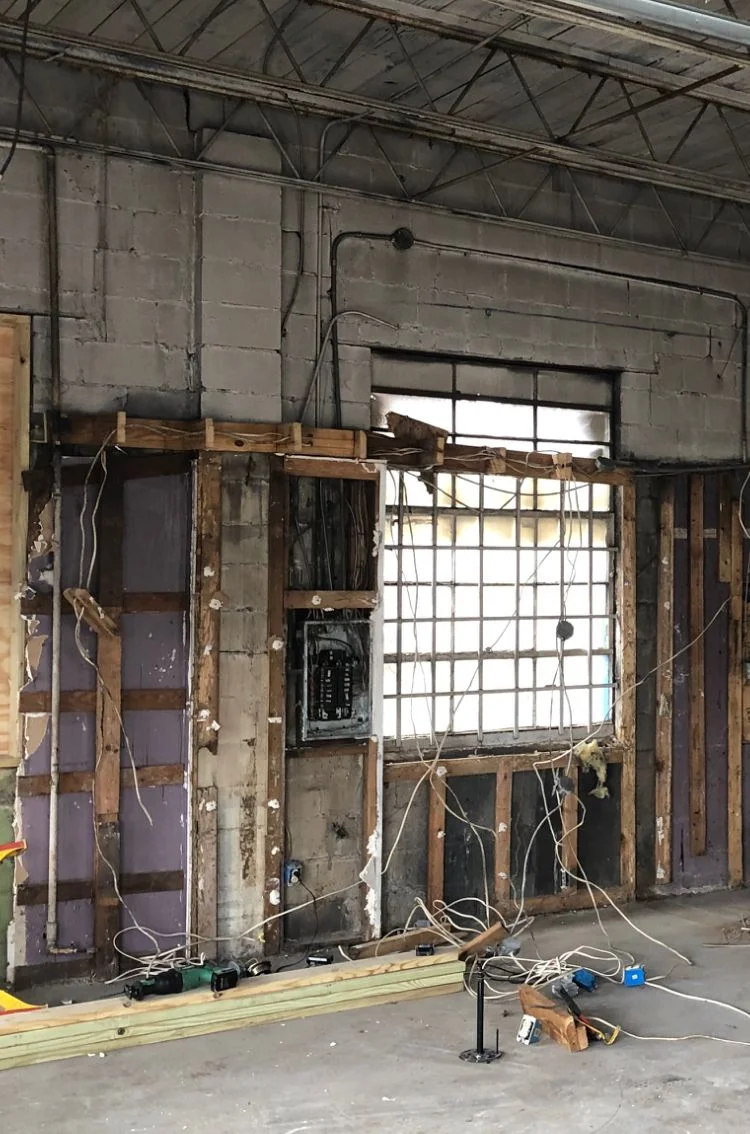

We last left off needing to tidy up the electrical so things could move forward. The more we picked at it, the more it became apparent that we needed to just rip everything out and start over.
The feeder wires to the panel weren’t big enough for what I need, the panel is a POS, the panel in the carport is all wrong,
and all the wiring in the building is sh!t.
So....
I bit the bullet and am spending my lift/forklift/retirement fund on new electrical. Sucks, but it will be right, it will be clean, and can have something to work with when I add stuff down the road. And it will at least bring something on the property up to code.
The electricians got on it this morning. Out with the old...
They’re putting in the bigger main panel, new bigger panel in the carport, and starting on the wires today. I’m having enough lights to rival the sun delivered in the morning.

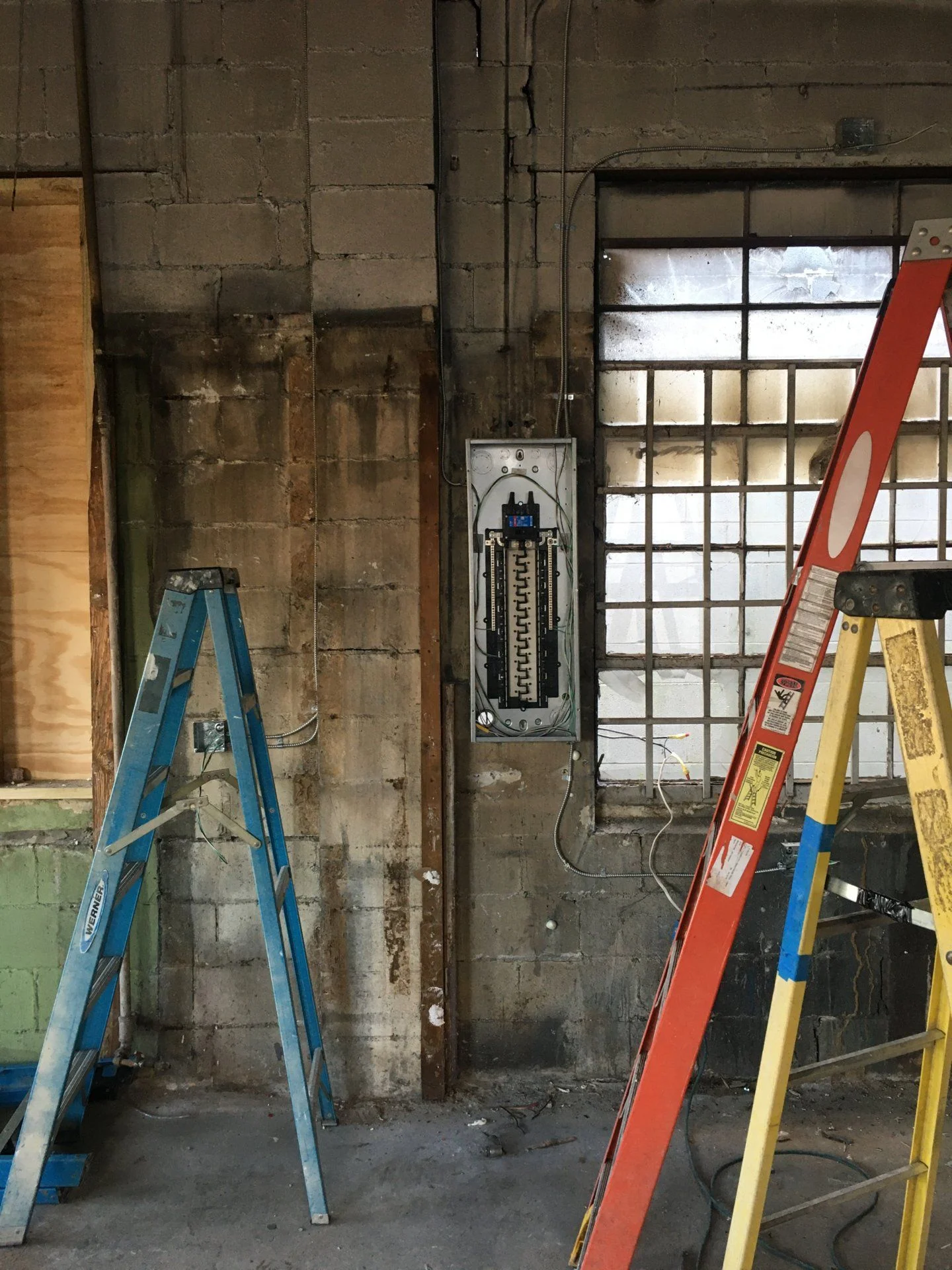

Got the call around lunch that the electricians were done. I went by to check it out, but got called away for something else as soon as I got there so didn’t take many pics.
I got new big ass service wires run from the weather head and upsized conduit from the meter.
And a new 50 amp panel in the carport. I’ll stick the compressor out there as well as a few other pieces of equipment that don’t necessarily need to be inside.

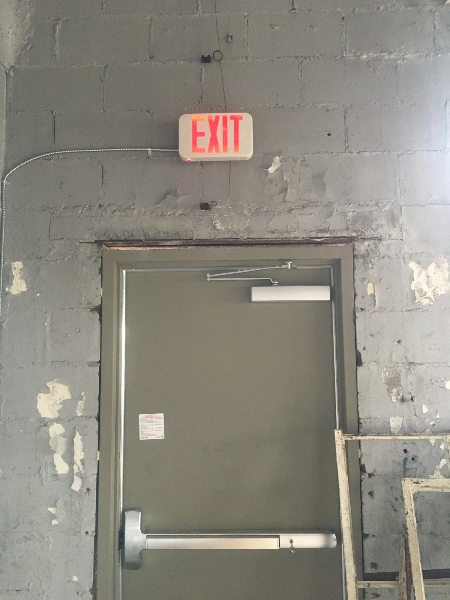

The required exit signs...

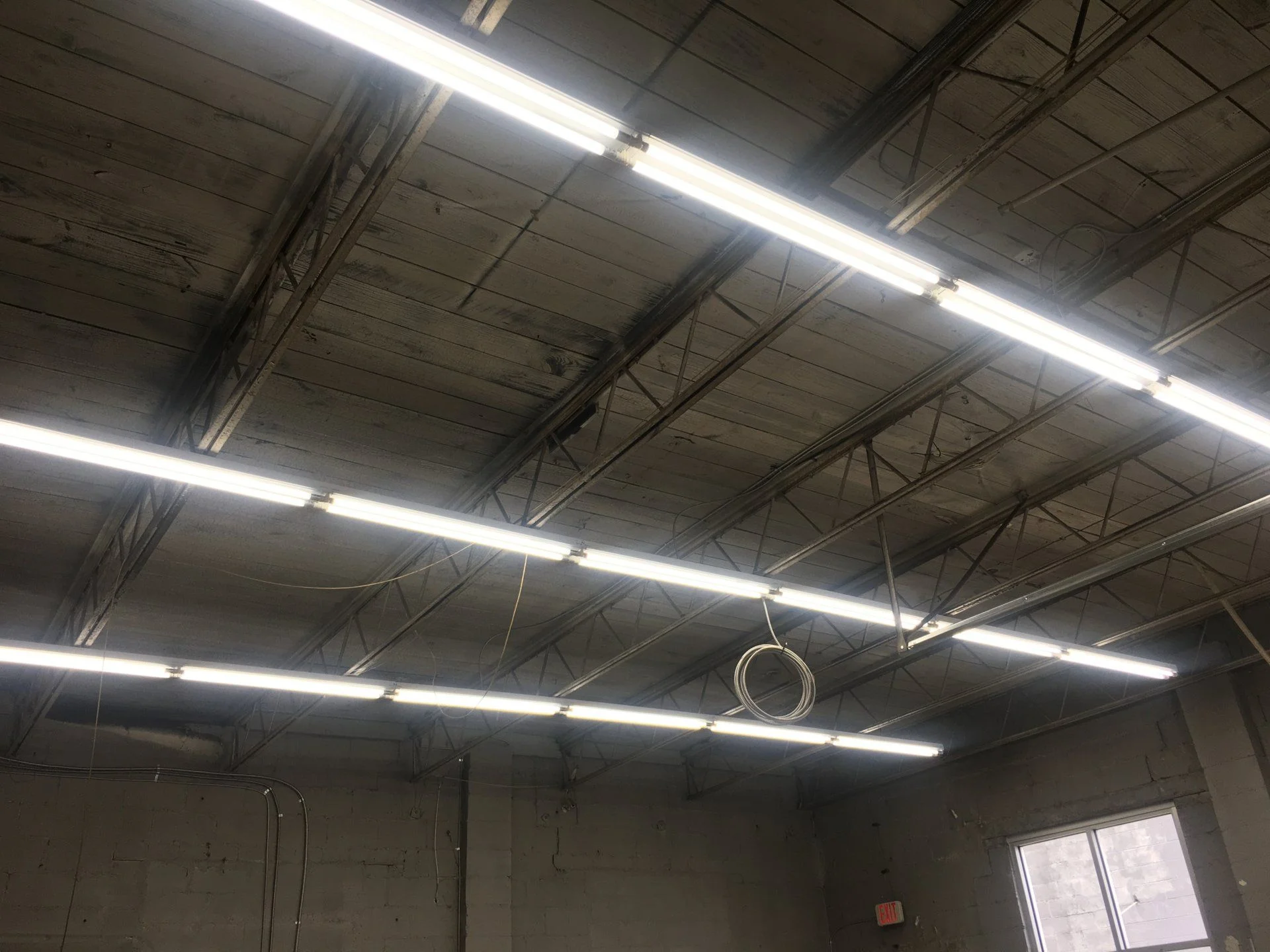

And, of course, new lights. Originally, I was going to use some strip LEDs from Home Depot. I tried a 4’ section in my home garage and it is super bright and has a nice white color.
They start to add up though when you buy a bunch. And I wanted 8 foot’ers.
My electrician recommended an 8’ ballast-less fluorescent figure with tandem 4’ sections, and LED bulbs. Unlike the Home Depot units, these were a lot more reasonable, and the bulbs were serviceable should I break one or one goes out.
I was not able to see one in action, though. The lighting store had just enacted their curbside pickup & delivery-only coronavirus policy. No one was allowed inside.
First thing I did when I walked in was flip on the lights. And it was... underwhelming :D
It was just merely “bright”. I have so much natural light through all my windows that turning on the lights just made it look normal.
With the 3 continuous rows, it is super evenly lit. I’ll add some more local light on the workbench side, but this is perfect for general use.
