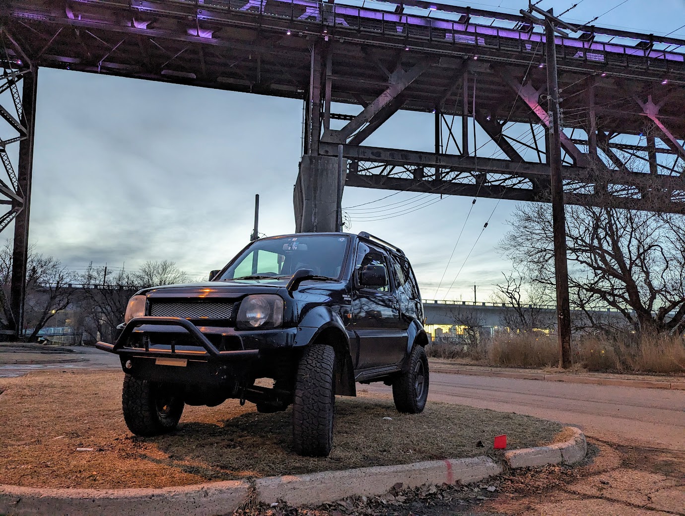

Hello all, I am an Albertan and currently own a 2008 Suzuki Jimny Sierra w/ an M18A swap I imported (pictured below). I've owned it for a couple of months and love it, but it's highway manners are terrible and I've always had my eye on another diesel after getting rid of my L400 delica.

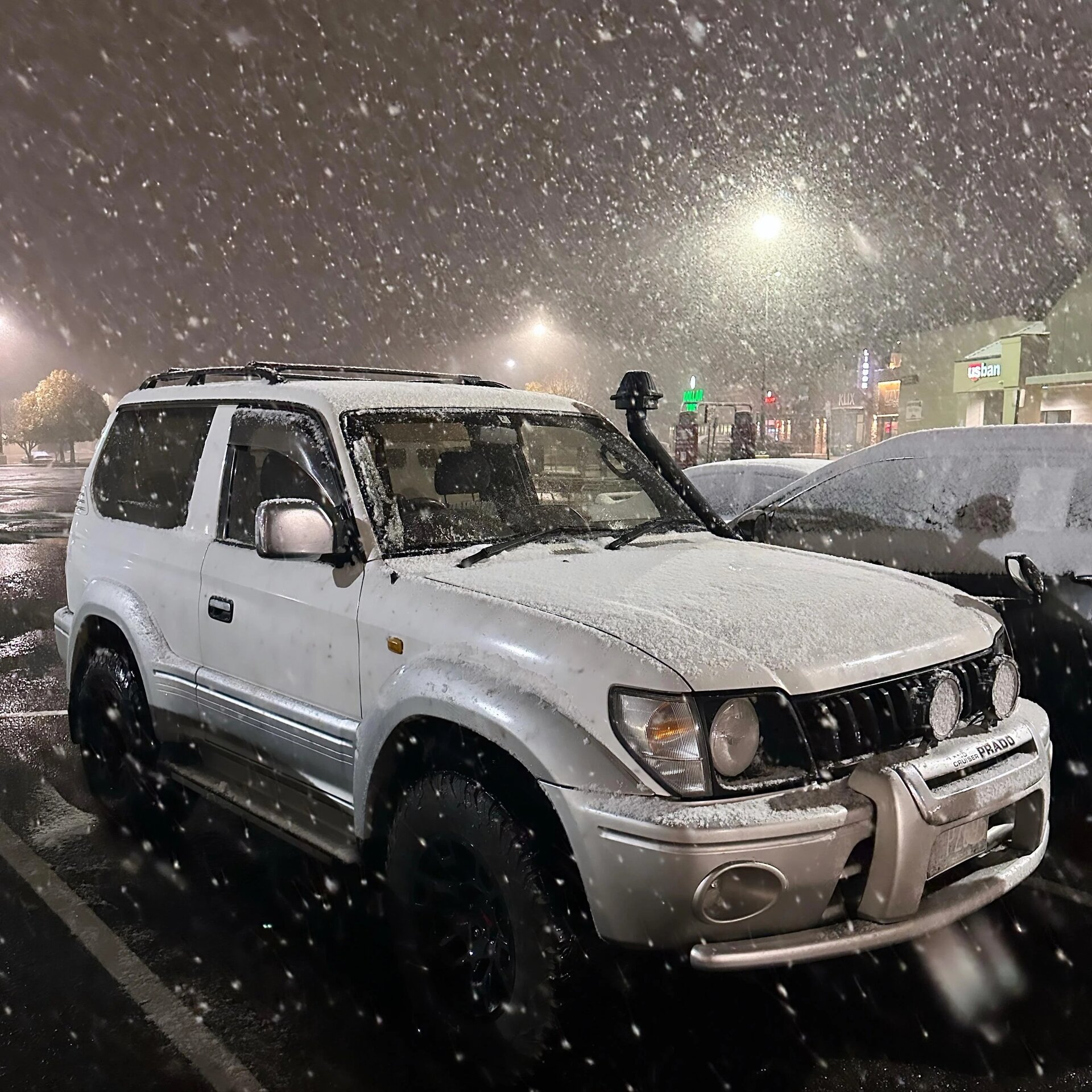

I have been strongly eyeing importing (from Japan) a 5mt 3 door 90 Prado with the 1KD engine, I wanted the more modern DI engine, and the extra power and fuel economy seems superb. I also attached a photo of my ideal spec Prado.
