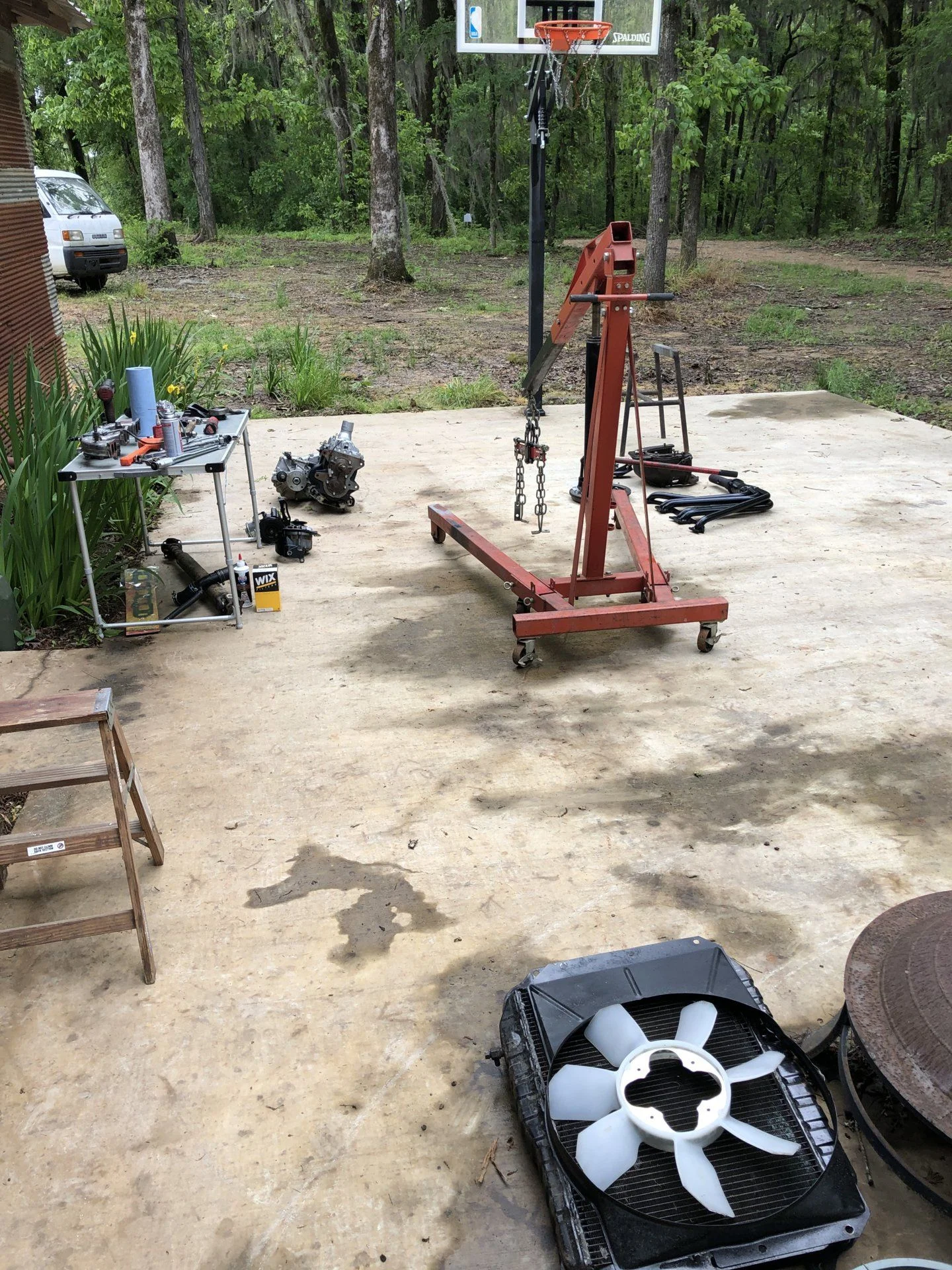

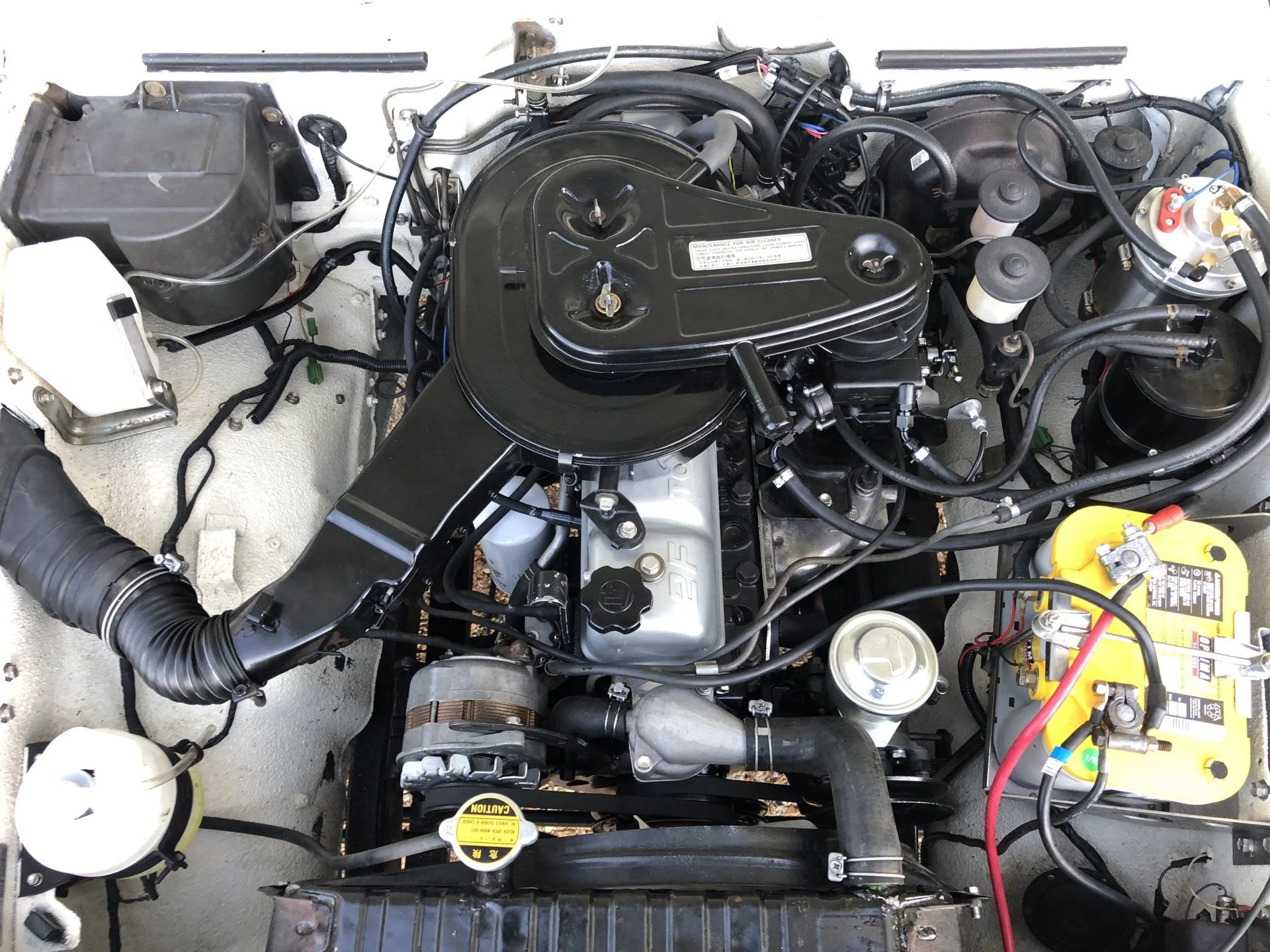

Tomorrow is the big day.
I think I have everything ready for the transplant surgery.

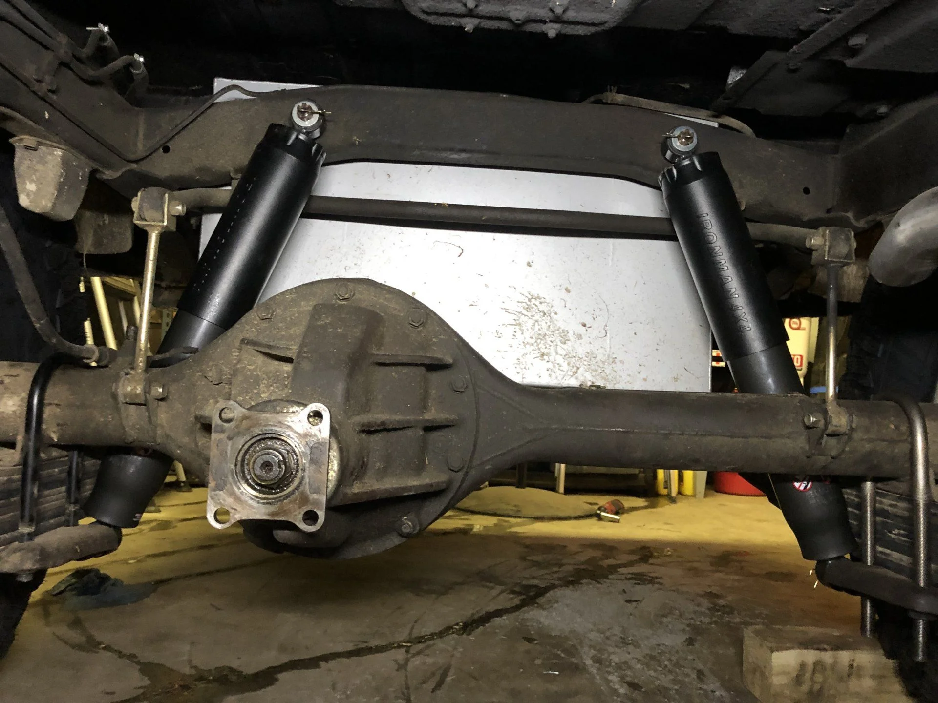

In other news, after looking long and hard at the King shocks like @scrapdaddy did and just decided to go with what I know.

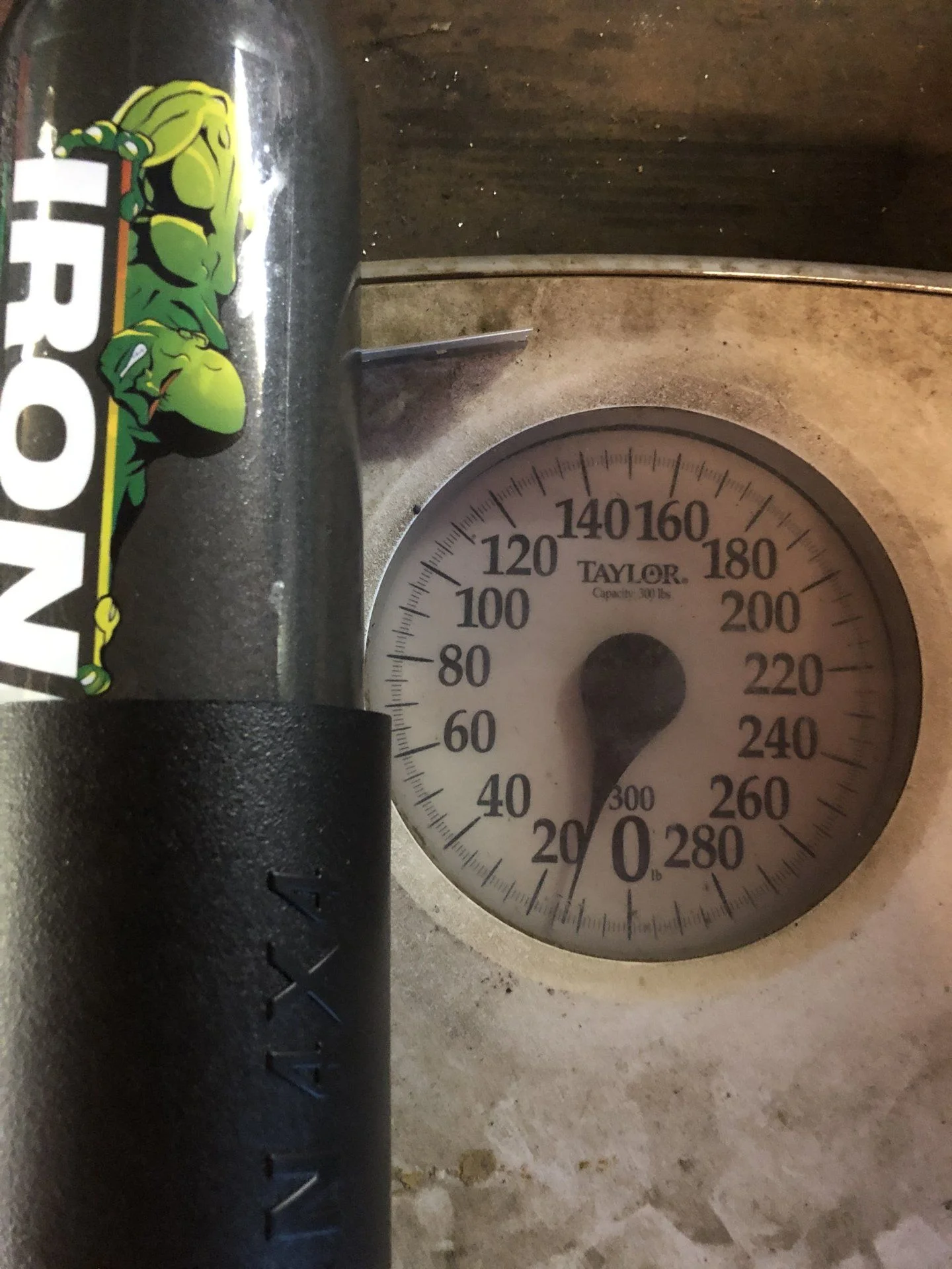

Iron Man Pro Firm 60 series shocks. They are so much heavier than the OME. Not even in the same class.
We are going to lower the top mounts on the crossmember so I can get more droop. These are about 1” longer than Ome but they need more room to drop.
Earlier I had raised them above the spring to the stock location for early Cruisers in the back of the axle but I want to try to keep the geometry the same. That much angle and I love dampening.
You can’t see due to the covers but, at rest and full of fuel (with all the leafs back in) the shocks are about 2” from fully extended.
I’m going to have Shaw Fab add new upper mounts to the bottom of the crossmember tube and extend my sway bar arms. Should be perfect. Not looking for a ramp champ but not wanting to carry tires all the time.
Oh man. I was so excited I staged it all
Hooked it up to the Goat for transfer to the OR

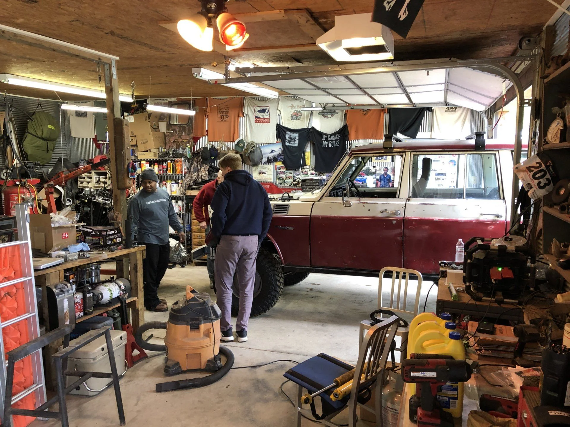

The master at work
Lots of help. Great help. People that don’t need to be told what to do.
The motor fired and ran perfectly. My throttle cable is jacked. So sad but I can only idle it around. Ive ordered a new one but you can bet your ass I’ll try to rig something up to be able to drive it.
Stay tuned.

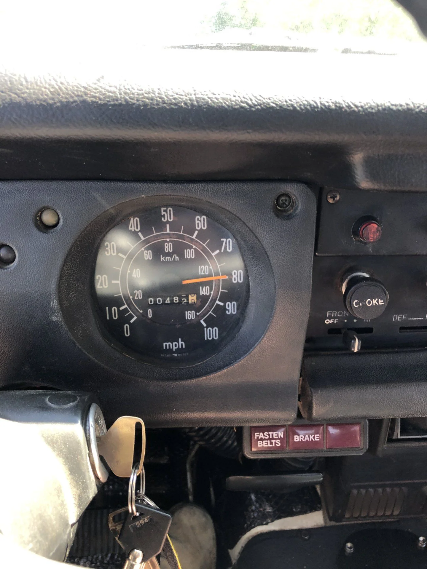

My cable broke on the way home from work one day and I tied speaker wire to the linkage and throttled home a few miles with my arm.
Taking pics of your speedo while doing 80 in a FJ55? Wow dude😧
But congrats tho👍

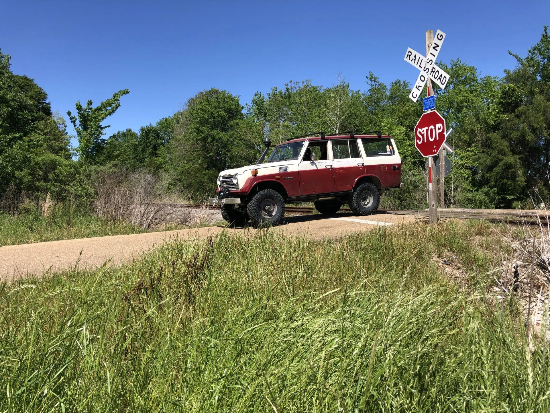

It drives perfectly at speed. It does want to change lanes a bit when I let off a hard throttle

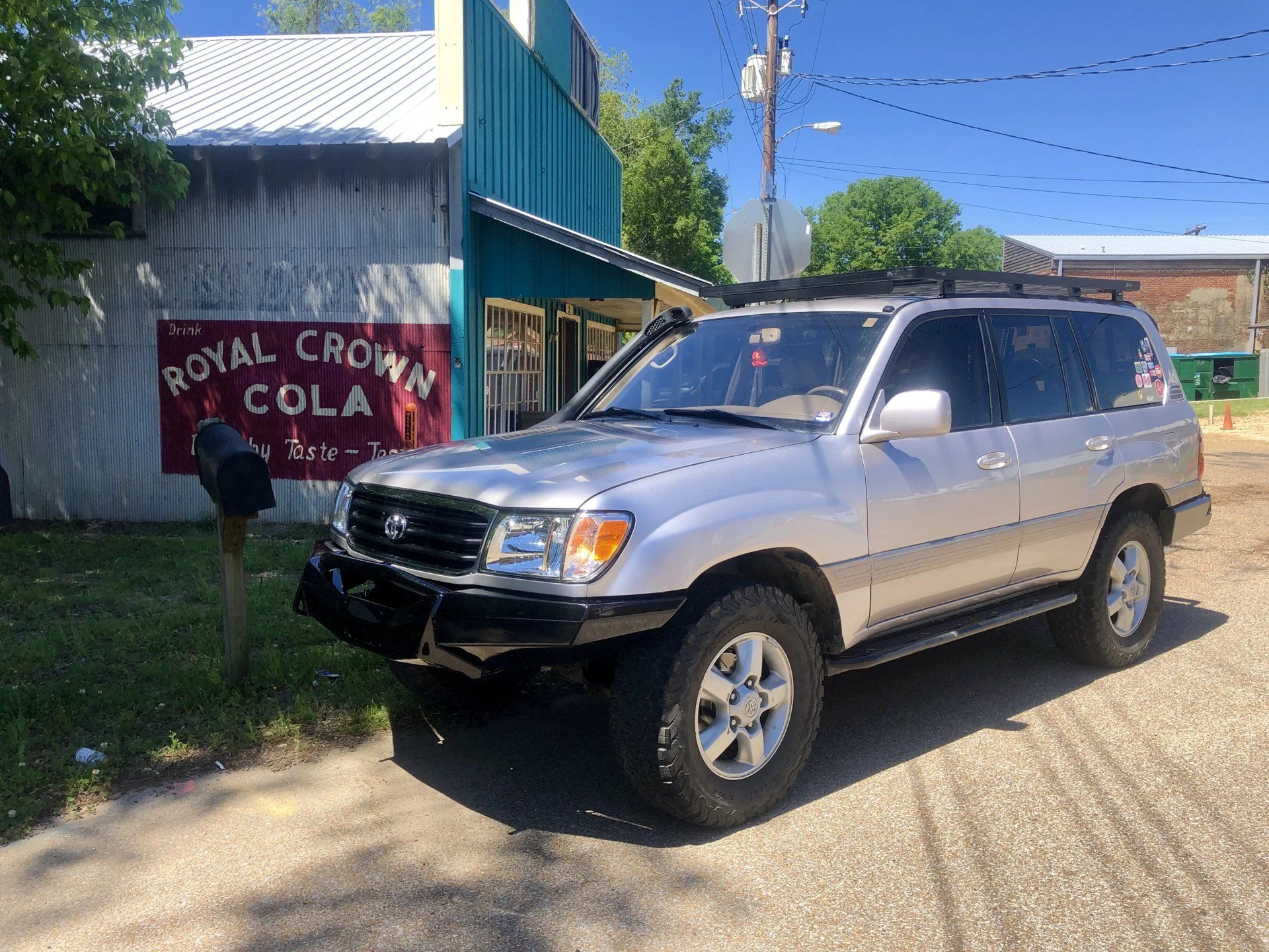

I also picked up my 100 from the body shop today from collision repair. I have a full house again and all of them run!
New front fender? No blend?
Yeah and thanks for pointing that out as I just now see it.
I think I will let her “blend” it by getting it dirty.

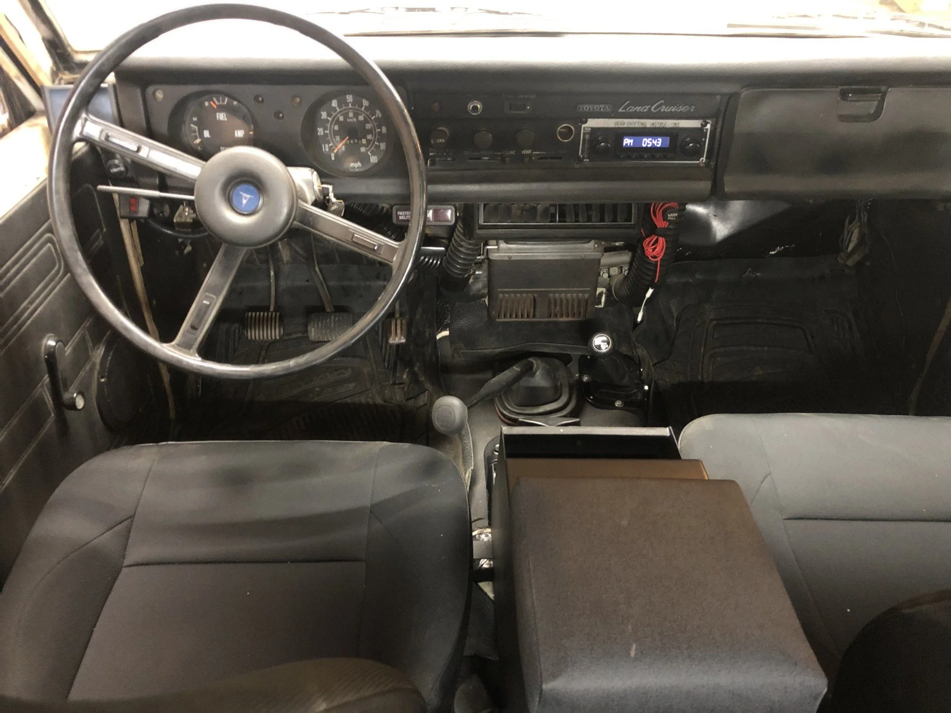

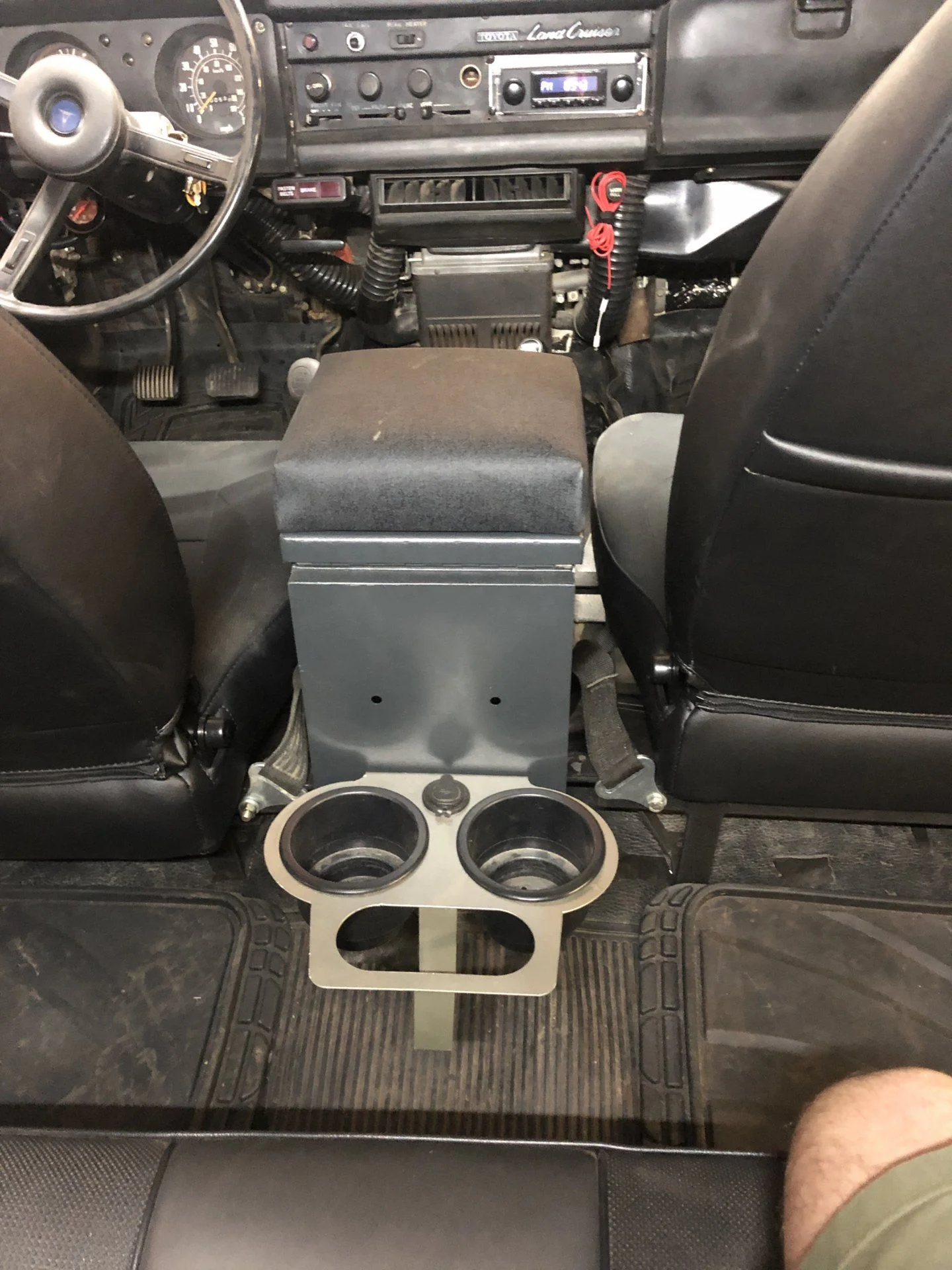

I got the interior all finished. Holes are all filled on the tranny hump. No hot air coming through the floor or firewall. It’s still loud compared to my 60 but it’s 50% quieter than pre-project.
Mounted the Sniper display with a screw in cell phone mount far left. Mechanical oil pressure on the bottom left. Line lock switch. Left. Dopey red wire is audio input for Retro Stereo. Seats are Corbeau Moab and console is Smittybuilt.
My friend Andy had a spare drink holder with dual USB plugs.

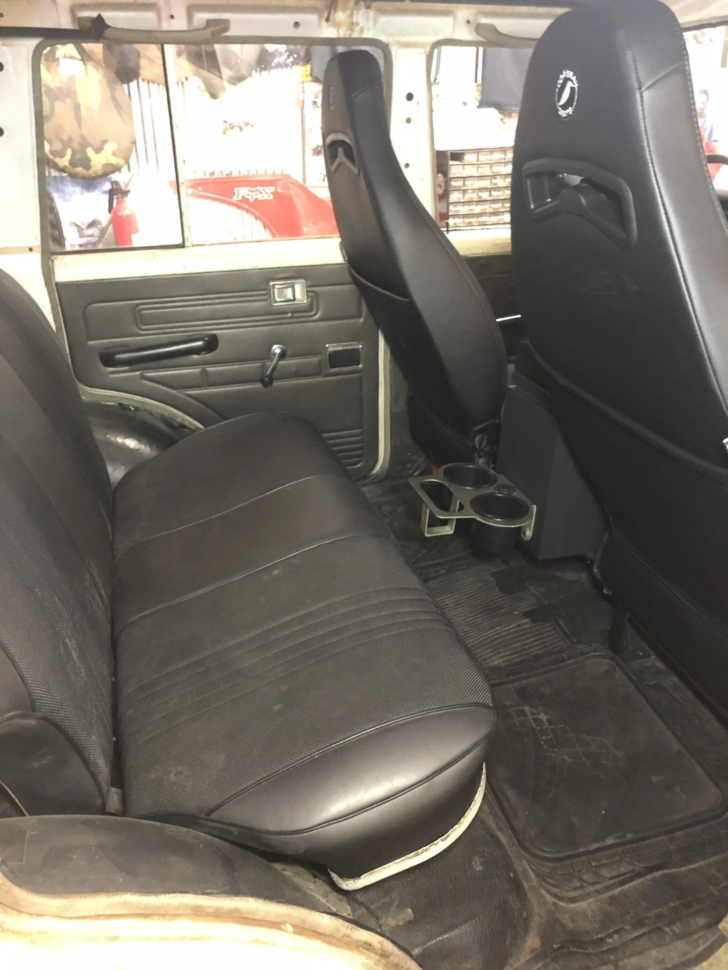

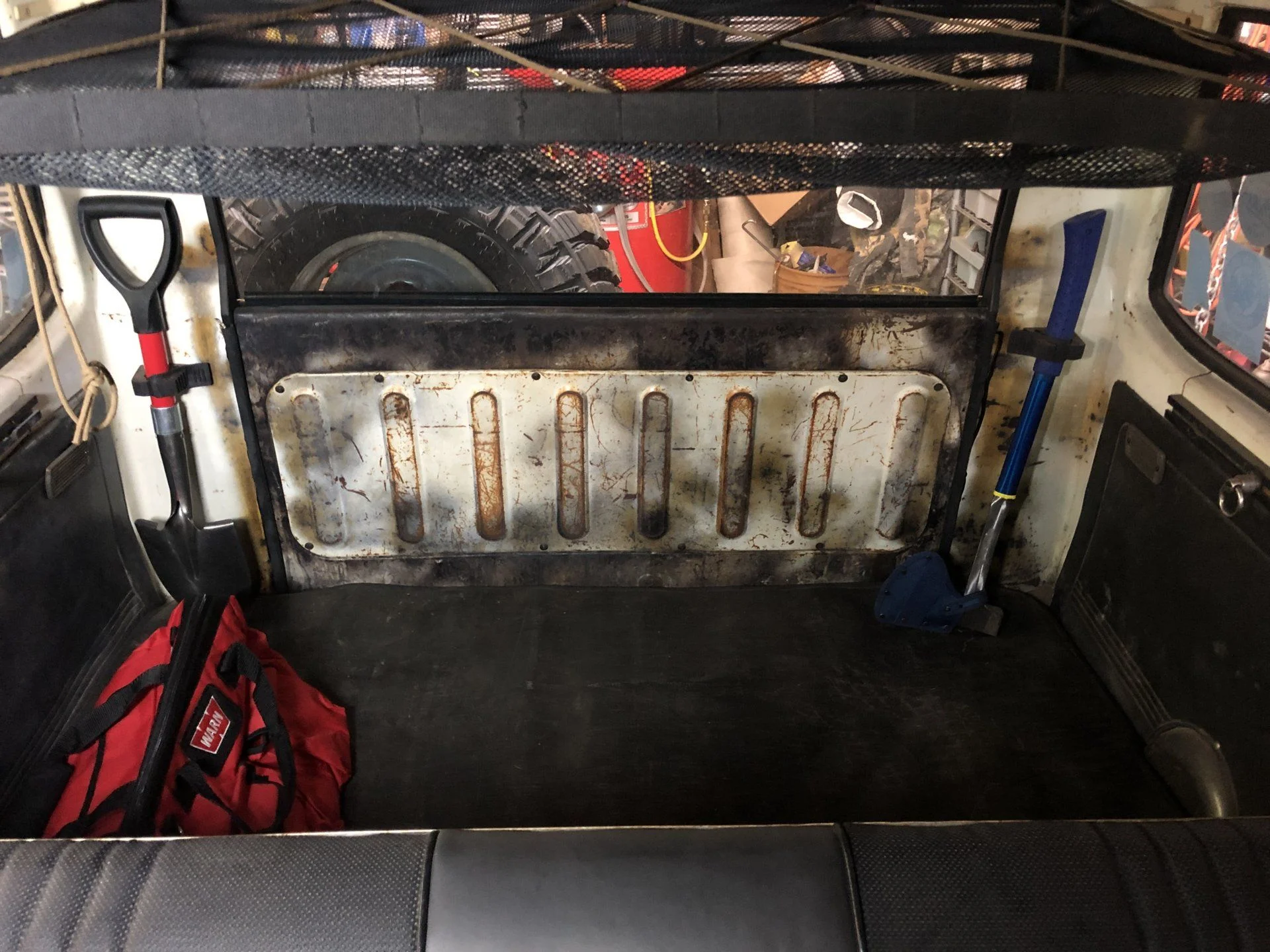

Rear seat it stock
Cargo net via Blue Ridge. Gear rails via HiLift.
It’s tidy.
What’s the scoop on your head unit? It looks old yet modern. Does it have Bluetooth functionality?
