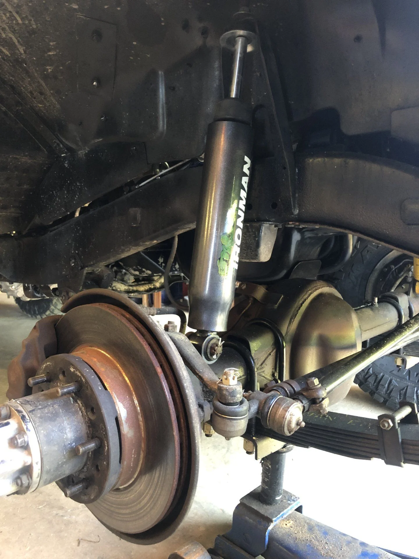

Got the front Iron Man Pros on today.

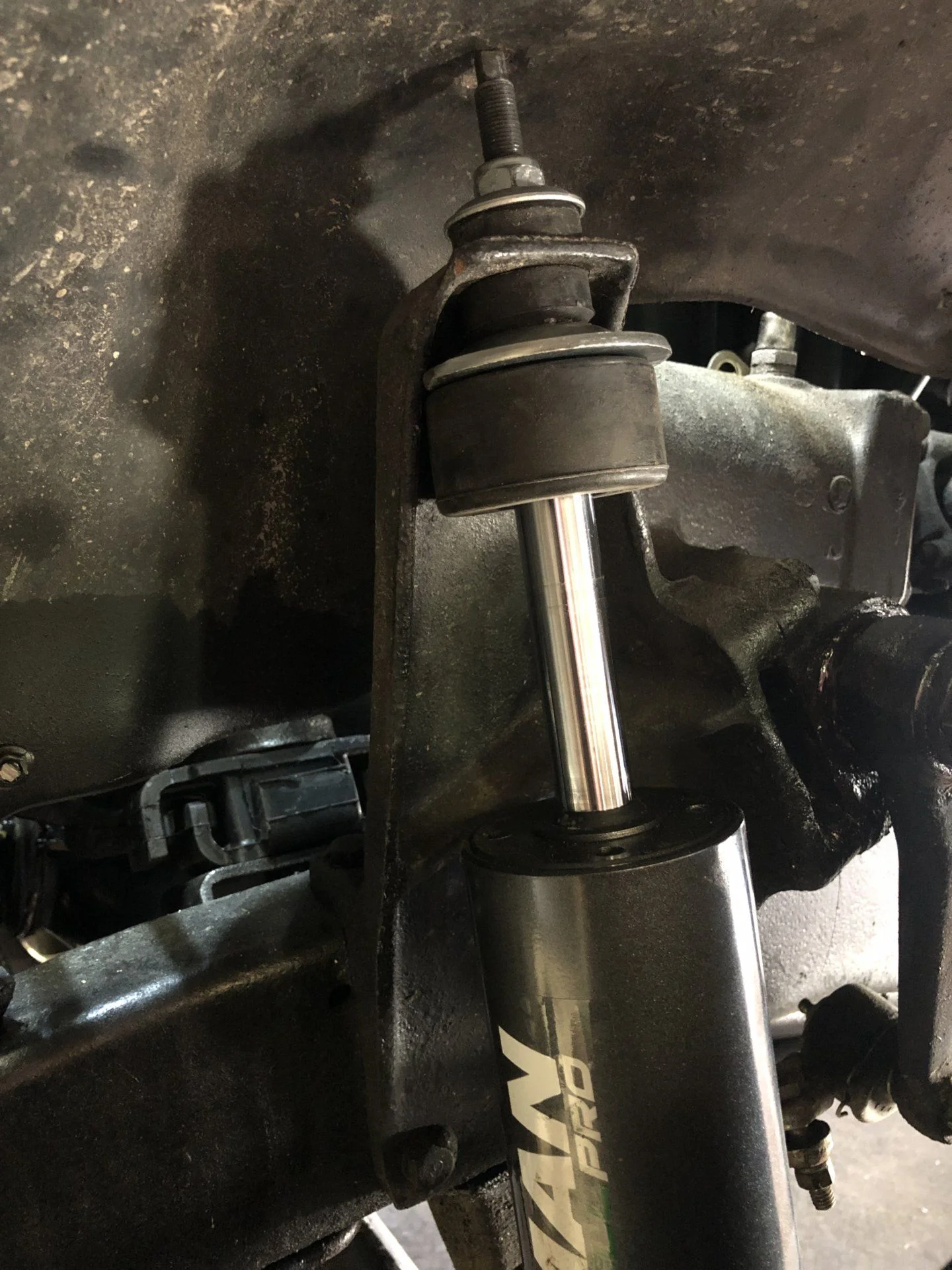

They fit on the passenger side, no mods.
Driver side I had to grind down the plate that the bump stop rides on.
Length on the front are perfect. Plenty of up and down travel.
I’m going to have to outboard the top of the driver shock to make sure it clears the drag link. It hit at full droop but it was just touching. Not bound.
The ride compared to the OME is just too good to fairly compare. They are in a different weight class all together.

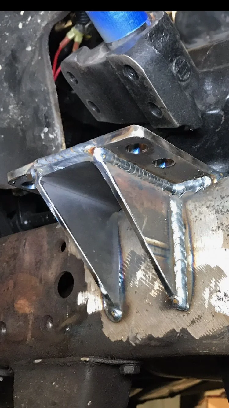

6 weeks later and the Warthog is back.
Justin welded up some things for me on the inside and out. The list was long and he does the stuff at night after work.
The major thing was the PS mount bracket.
I thought I had a 40/55 PS box that I had rebuilt but it turned out to be a mini truck.
Box specs are the same but the mounting position is different so instead of a bolt in PS he had to build a flat bracket.
Since the ps mount is part of the shock tower he also rebuilt that.
This is at full stuff on the front shock. Top of the shock was outboarded a bit to clear the OE draglink with the bigger shock body
