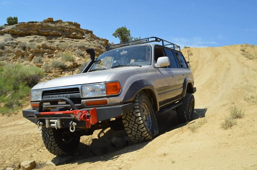

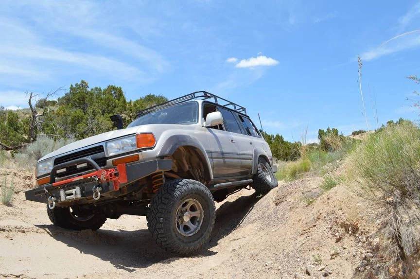

Some Frank flexing shots. We got into a meandering arroyo that really tests your suspension:
I am Way happy with the sway bar disconnects. They really free up the front end, keeping tires on the ground more, and I think that for offroad driving, the ride is a bit better.
The frank did great everywhere we wet, but I just don't have enough power to climb some of the steep sand dunes that are in this area.:hmm:

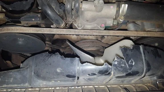

Popped the hood to check thing before going out tomorrow and found this:
I'm guessing I'm in for a new fan shroud and engine mount(s), but I am glad I didn't break any fan blades. I guess this is the downside to the flexy obstacles. Also, I installed my hand throttle. I have not had issues with winching or airing up, but I'm hoping that being able to bump the idle up to ~2K during these times will help alternator output.
Nice, welcome to the club :grinpimp:. Can't wait to see what you have in mind :wrench::wrench:
Sorry to hear about the golf ball...

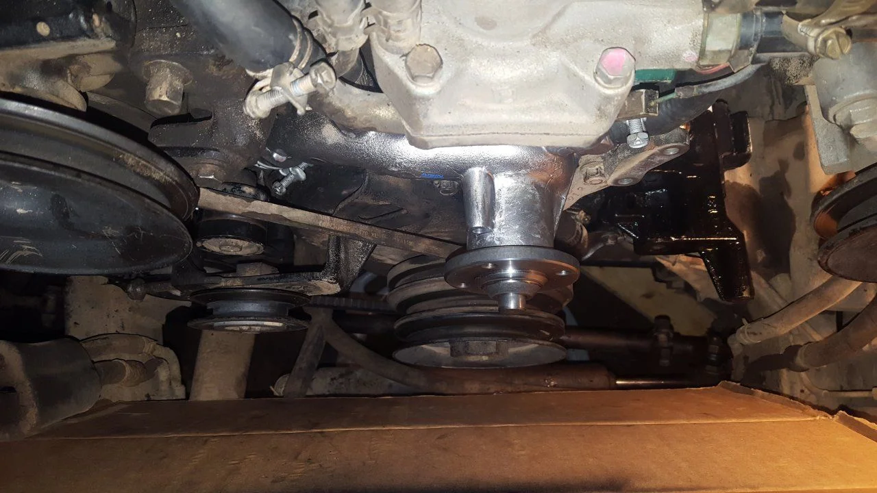

Working to get The Frank back on the road in time for the club run and trail cleanup this weekend. Got new motor mounts installed and replaced hoses and water pump, while I was in there. A couple hoses were pretty soft, so this was good timing. Also, I'm pretty sure my water pump drips were the result of previous lazy mechanic work: i found bits of old gasket stuck on the block beneath the installed gasket...nice.

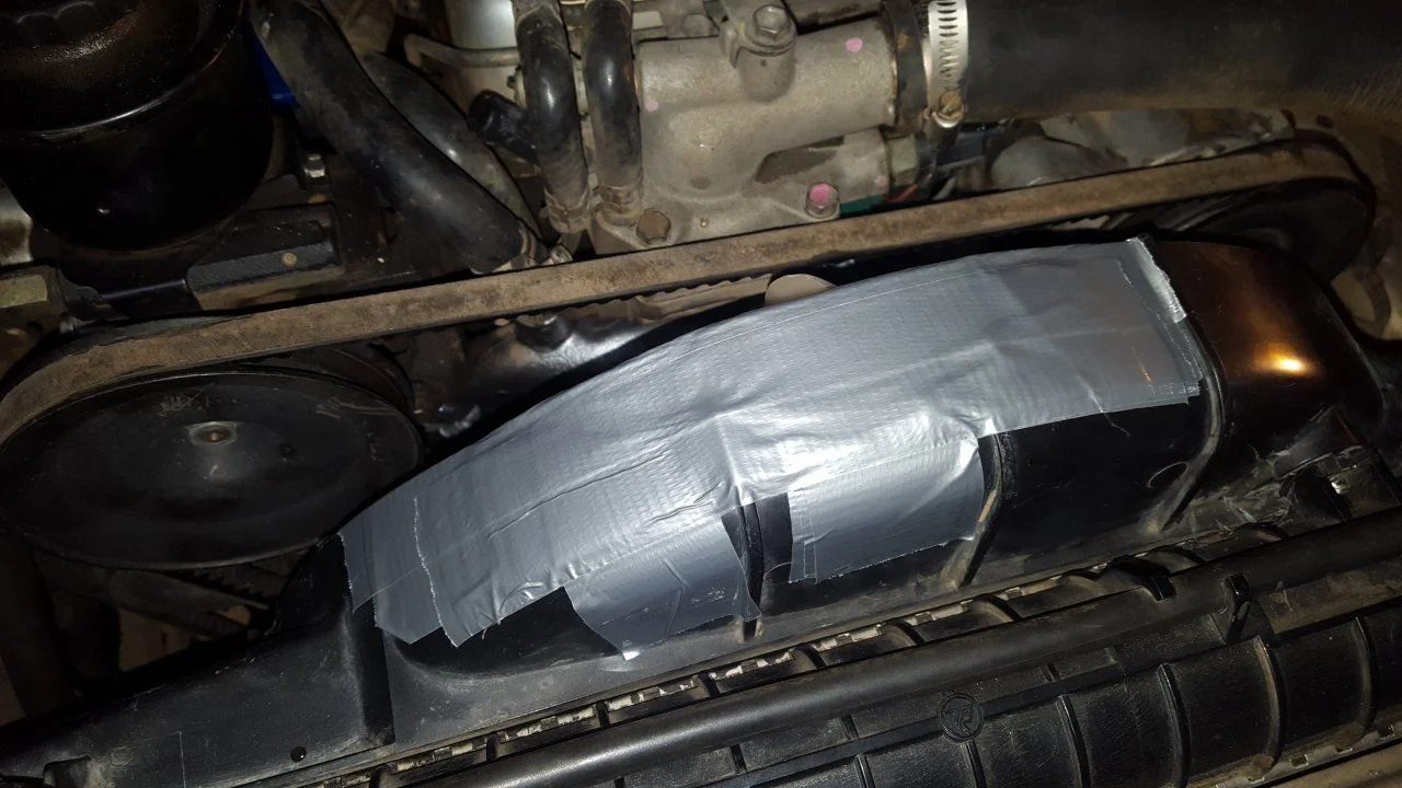

If you can't duck it...
...I will have to pick up a fan shroud ASAP. Duct tape under the hood just makes me feel like the truck is dying a slow death. Will fix soon.
Get your Sharpie, and write "T E Q" on the duct tape. It's good !!!
Looks legit to me.
