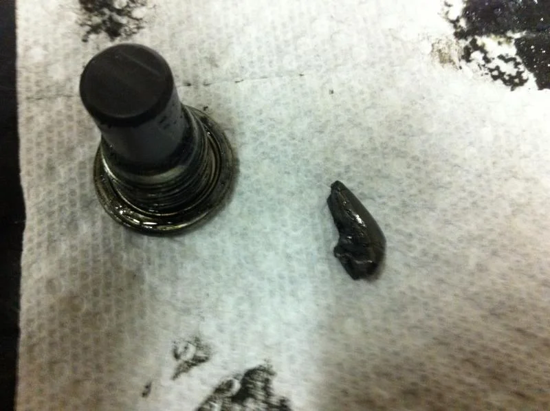

Pulled the third member and the front diff to get 4.88's in today and guess what I found!!!
My front diff fluid was supposed to have been changed at the dealer 5000 miles ago.
This is what was stuck to the magnet, but it definitely looks like it bounced around a bit first. I'll take some pics of where it came from once we open up the front diff.

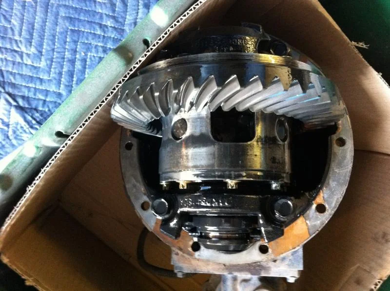

Here's a pretty pic of the third member if you've never seen it as well :)
:eek: That looks painful. I'd be a little miffed if I were you. Not to go off on a total tangent, but man, whats with all of the crap service people have been getting lately? Is the LC/LX platform truly so "specialized" that techs are scared of getting too deep into it? All of these bad service stories are starting to wear on me a little. I guess finding a good local specialty shop that knows what they are doing is worth it!

Def want to know where that came from. Looks like an effed up gear tooth but that prob woukd have been noticed. I cant believe it didnt get caught and seize your diff.
No way to tell if that tooth broke 5 miles ago or 5K miles ago, I wouldn't put to much blame on the dealer ship. But I agree doing your own service is a great idea.
Wouldnt you be able to feel a broken tooth in the driveline?
Not once it hits the magnet. It looks like it bounced around a few times though. I'd think you would feel it when it happened, but someone else (wife, friend) could have been driving the truck when it occurred.
The oil that came out was black as could be, It really looks as if it has been in there a long time. I'm not saying the dealership caused anything, I'm not 100% sure that they did the front diff service...
The back looked golden and new, but they definitely didn't empty it through the drain plug... I had to spend 20 minutes with a pry bar and screwdriver to get the plug surround opened up enough to hammer a socket in there to remove the plug... And I haven't been off road since the service. It looks serviced (did they suck it out?)
The wheel bearing also may have been done, but I assure you they were not torqued to spec and had very little grease in them for just being done. I could put the hub socket on them and remove them by blowing on the socket :)
I'm taking the diffs in today for gears so I'll take some pics of the damaged tooth on the old gears
Agree with this. How do you know it was there when the dealer changed the fluid? However, would they have picked up something is wrong if the lube monkey saw that? Who knows.
When mine broke while wife was pulling me out with a struck snow plow there was no indication. Only when I drove it later that day did I hear a very faint click noise. If you were not in tune with the vehicle you would not have heard it. If it is the spider gear, you might not even hear it.

Got the diffs back in today. All of the gears are fine. All we can figure is that the piece is still left over from the previous owner who grenaded the front end before putting in the ARB. So that means the tooth has been floating around for 10,000 miles at least!!!
