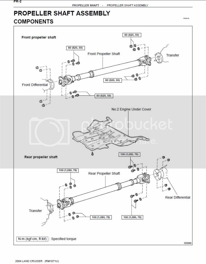

Looking for insight as to where the slip joint is located on the different year trucks. Our 98 has the slip joint at the rear diff side of the driveshaft, but my in-law's 05 (which has a clunk that I can't get rid of) has the slip joint at the t-case side of the driveshaft.
Was there a change in the newer trucks or has this 05 been put back together incorrectly at one time?

Anyone who has greased their slip joint want to chime in? Was the slip joint for the rear driveshaft at the rear diff or up at the t-case? Trying to determine if this '05 was put together wrong at one point as it has a clunk I can't seem to get rid of.
rich
This image should answer your question.

I'm a newbie to Landcruisers and the site, having recently purchasing a 1991 fj80 with 160K mileage on it and in excellent condition. It does have the clunk and especially when shifting from D to R and vice-versa. I was under it greasing the slip joints and U-joints and I noticed that the rear driveshaft slip joint is positioned at the front, near the transfer case and not near the differential. Is it fact that ALL fj80 slipjoints are positioned like the drawing a few posts ago? That is, that the front shaft slip joint is at the front and the rear shaft slip joint is at the rear? I know this has had transmission replaced about 5k miles ago, did they reverse the rear shaft? Should I put it back the right way? And, how can I tell if it's in phas or not when I change it over? Thanks in advance and glad to be an owner of this great truck. Bob in Michigan.
