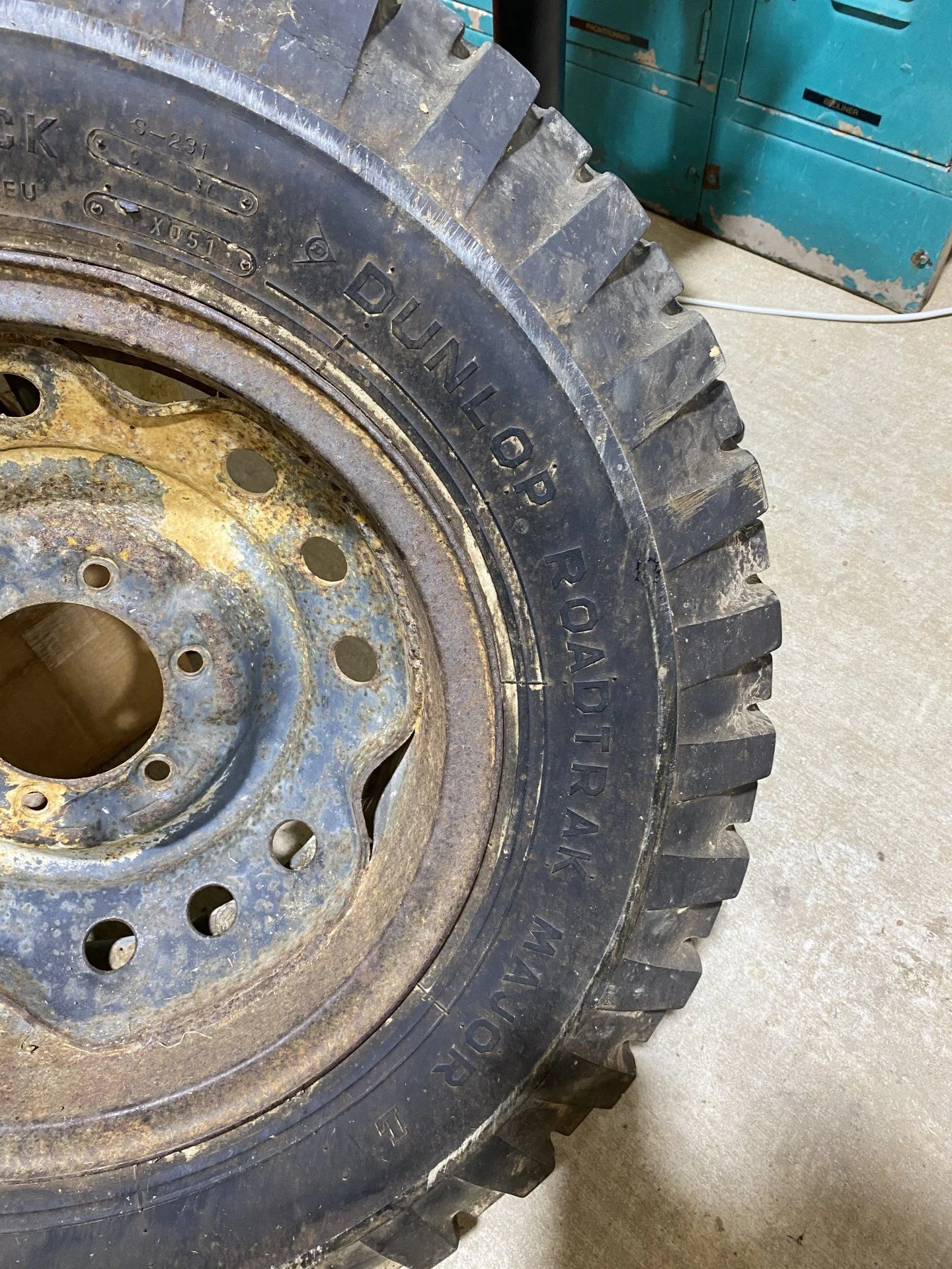

Close but not quite. The Tacoma wheel doesn't have the raised sections in the center and is a 16x7. The other wheels are 16x6 and are the Chinese brand, you can see the item number YA610 on the boxes.
Below is the early Tacoma steel wheel.
They look like Tacoma wheels to me
750-16 on a Split Rim just like I figured
7.50 r16 is a very common size in the middle east.

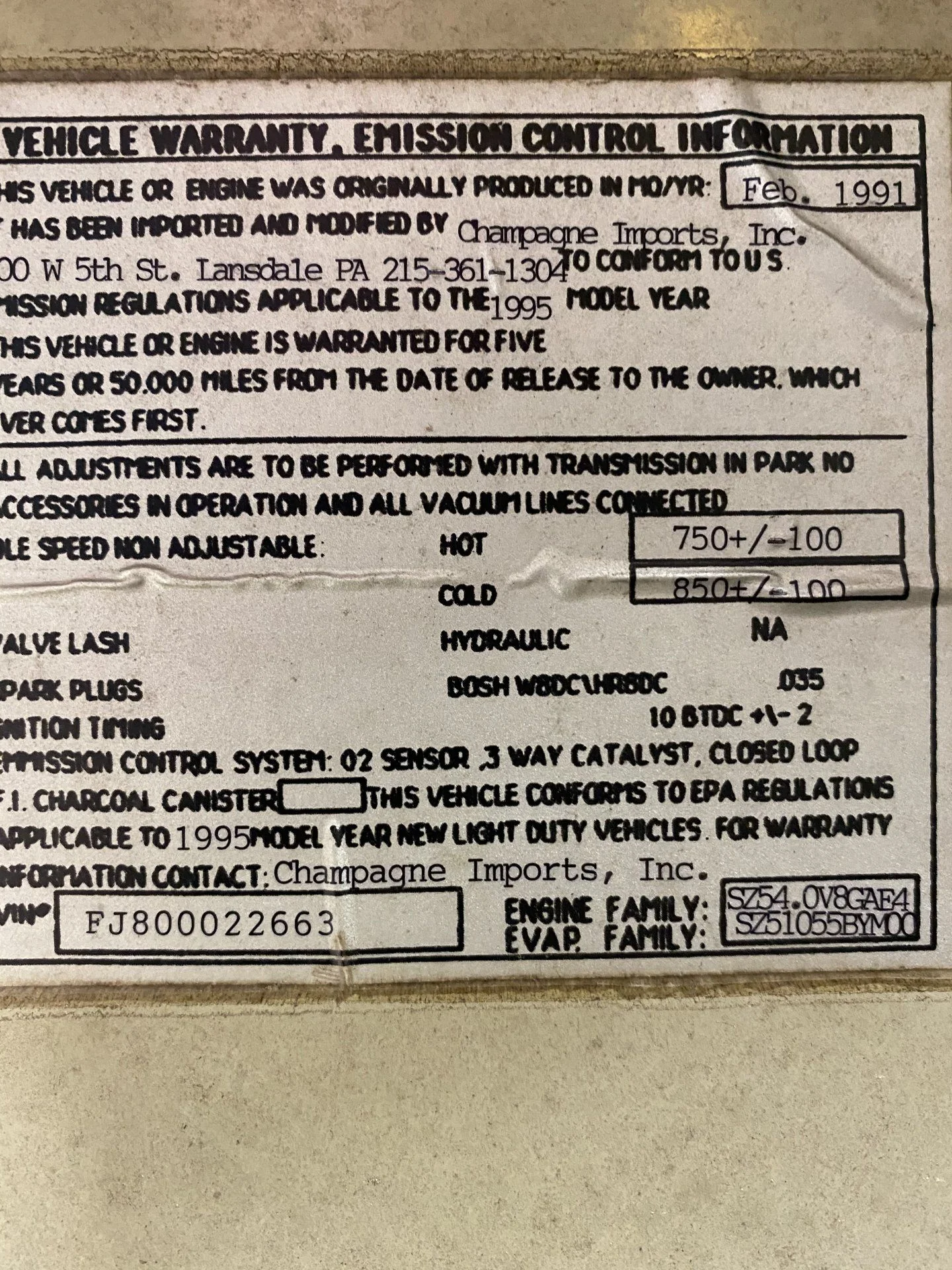

And then I found this sticker.
Holy hell, it looks like the importer converted this thing from a 3F to a 3FE .....
That explains the fuel pump setup......
I’d love to hear more about this if anyone knows. @SteveJackson ??
yes looks like a registered importers certification tag, this must have been imported before it was 21 years old and was converted to meet epa standards? sorry I haven't followed along with the thread. but the vin is a GCC truck with 3F carb, 5-speed and barn doors. Cool!

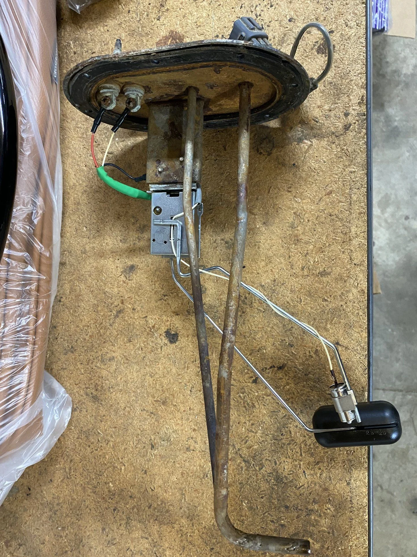

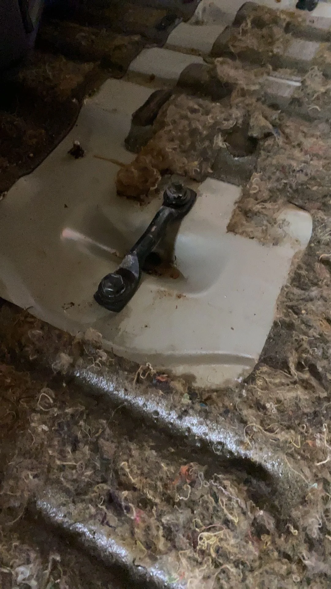

Got the middle seat pulled and was hoping to find a dead in tank fuel pump but it seems the 3FE swap only got the crappy in line pump.
These things are Not all bad as long as the tank is designed for gravity and it’s not pulling up a hill like this one is doing.

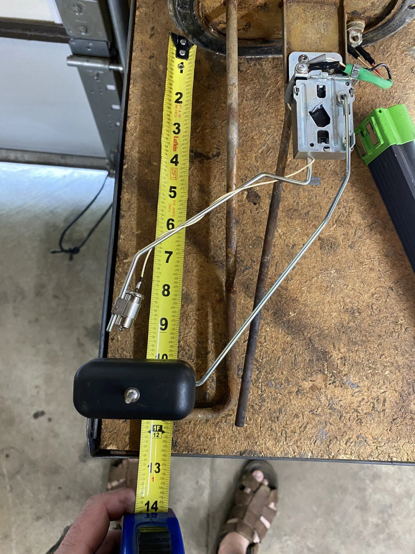

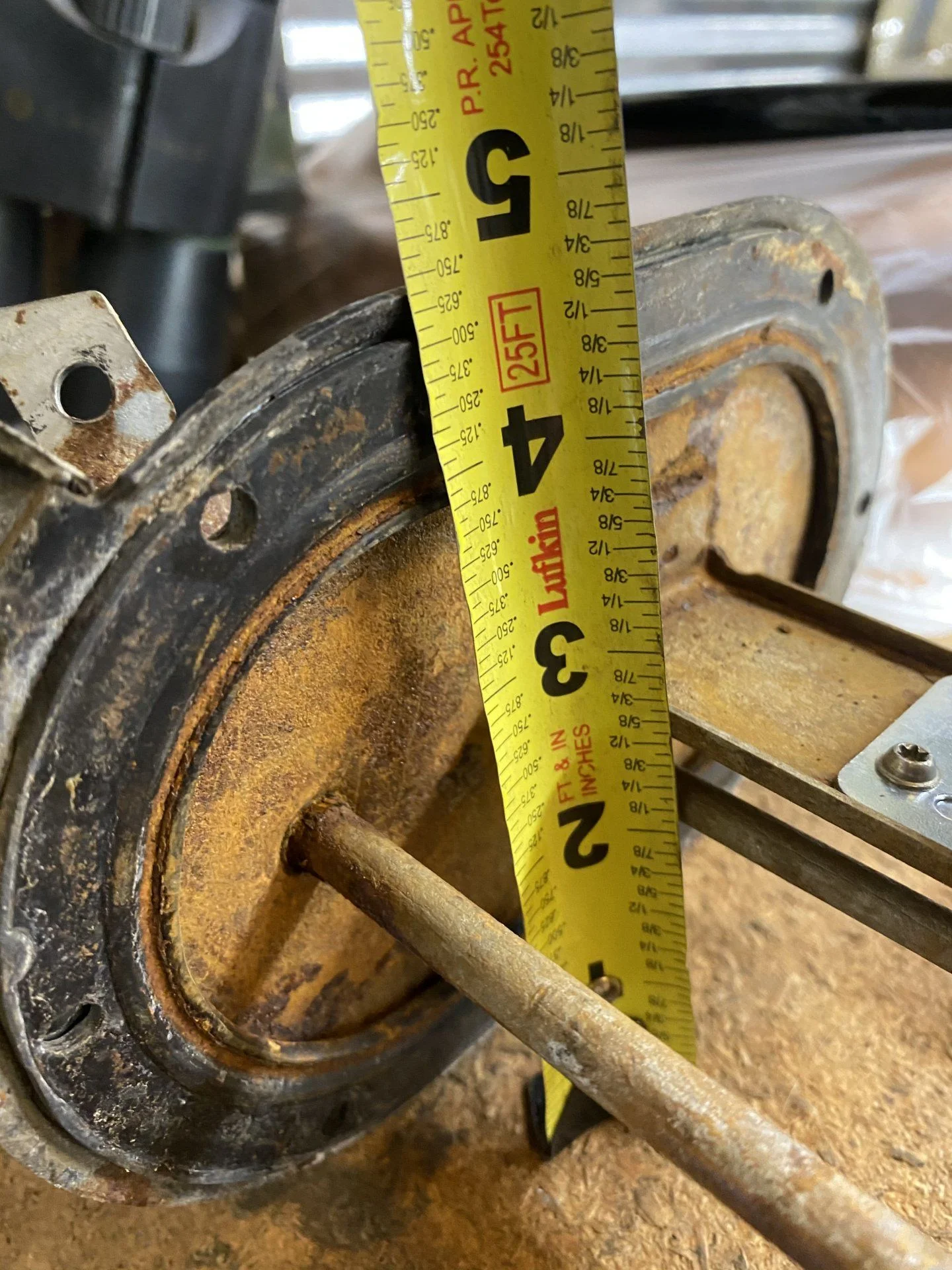

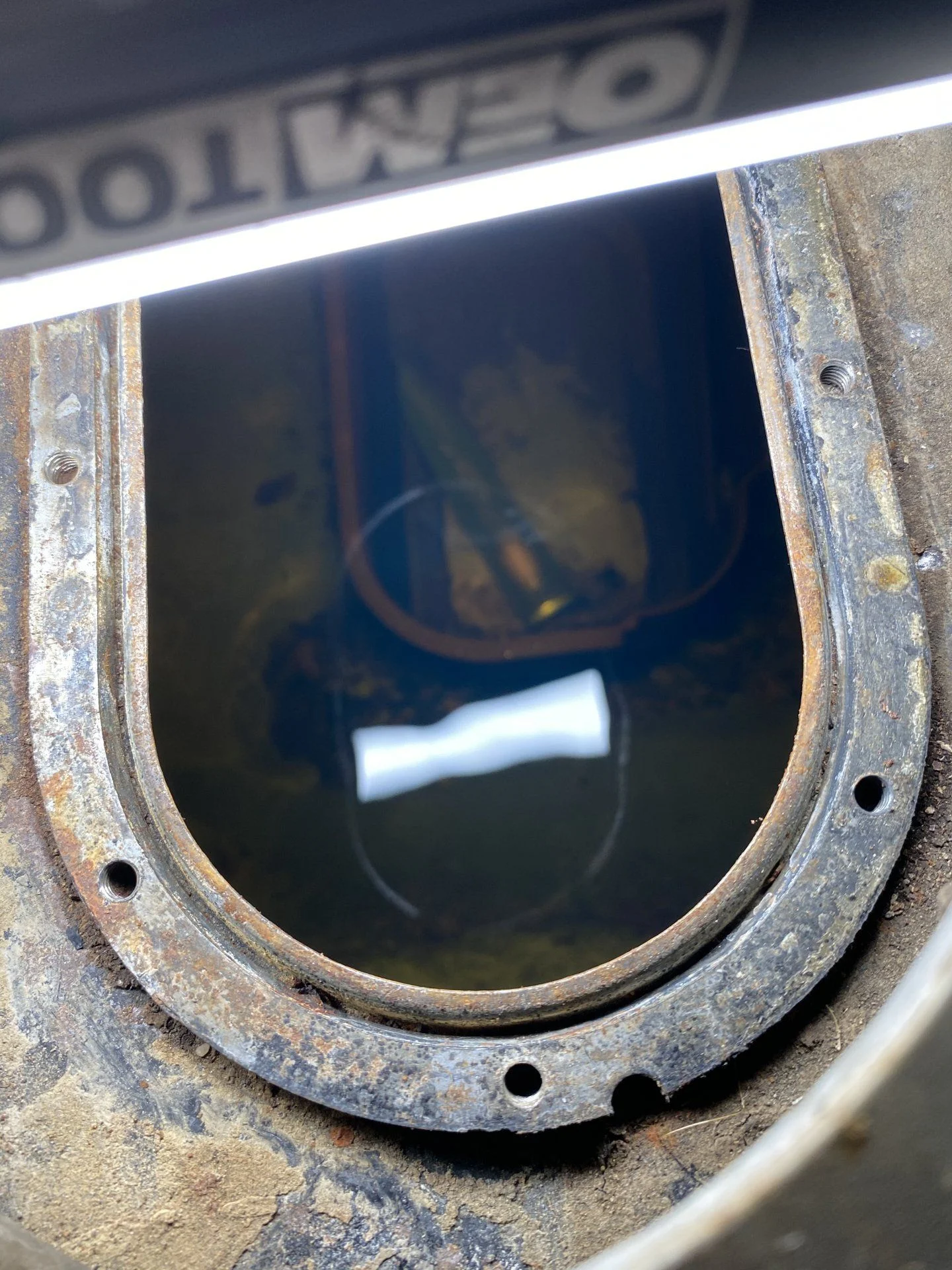

Man, bummed. This thing has a manual pickup. I’m hoping a US FJ80 pump assembly will fall right in.
Thoughts?
Tank has some rust but I think I can handle that with a drain and vacuum.
He should.
Yeah. Gotta. Just have to see if it’s a drop in or if I need to put the whole US tank in.
There are so many hoses for the Aux tank transfer I’d rather just drop in a pump and figure out the wiring.

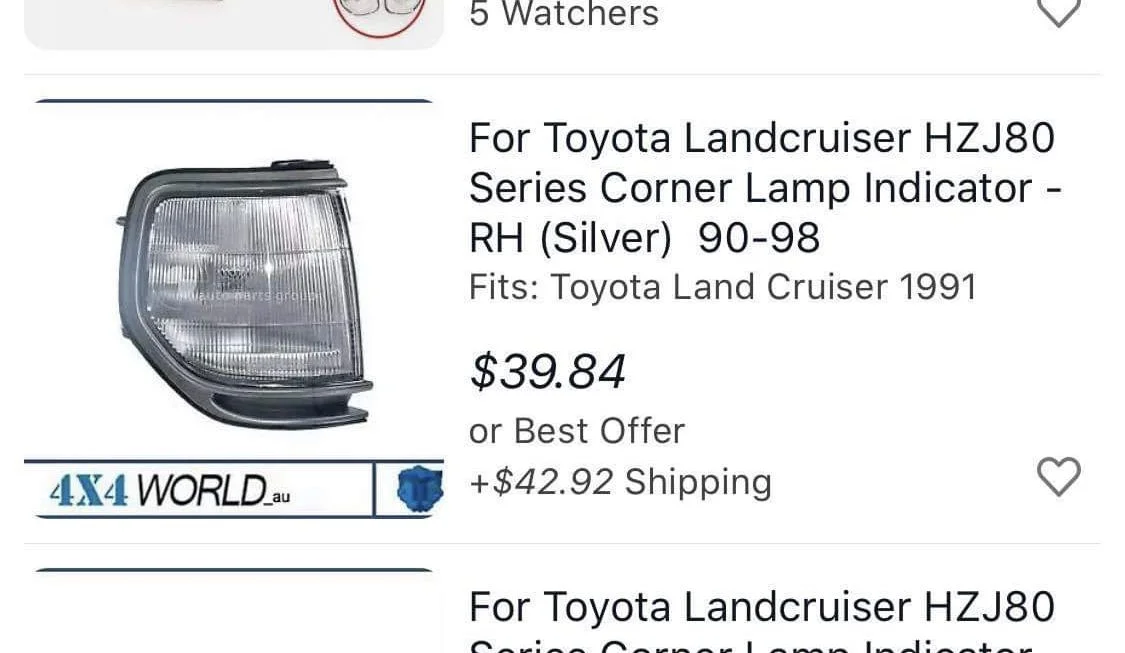

Thanks for the offer. These are all in great shape. I just need a non US front right flasher housing
