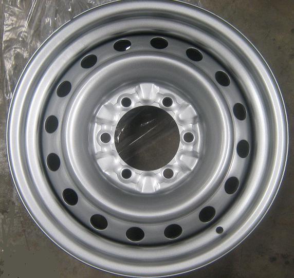

Question......these wheels you put on your 80 at first before the 70 steelies......
These look almost identical to the split rim that came off this truck.
Any idea what wheel this is from?
Those look like Hi-Lux rims.
