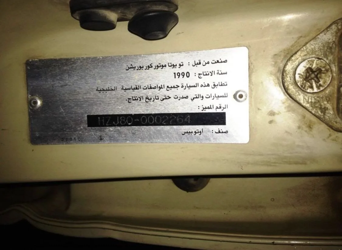

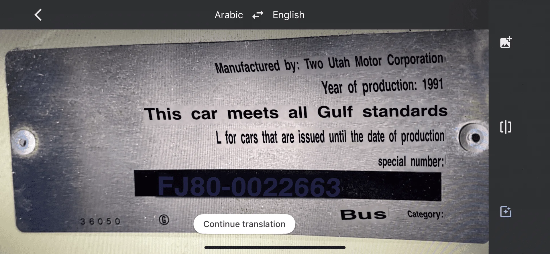

Translation
Needs a little work. I don't think it was the Two Utah motor company but I think you get the gist. lol
Pretty spot on.

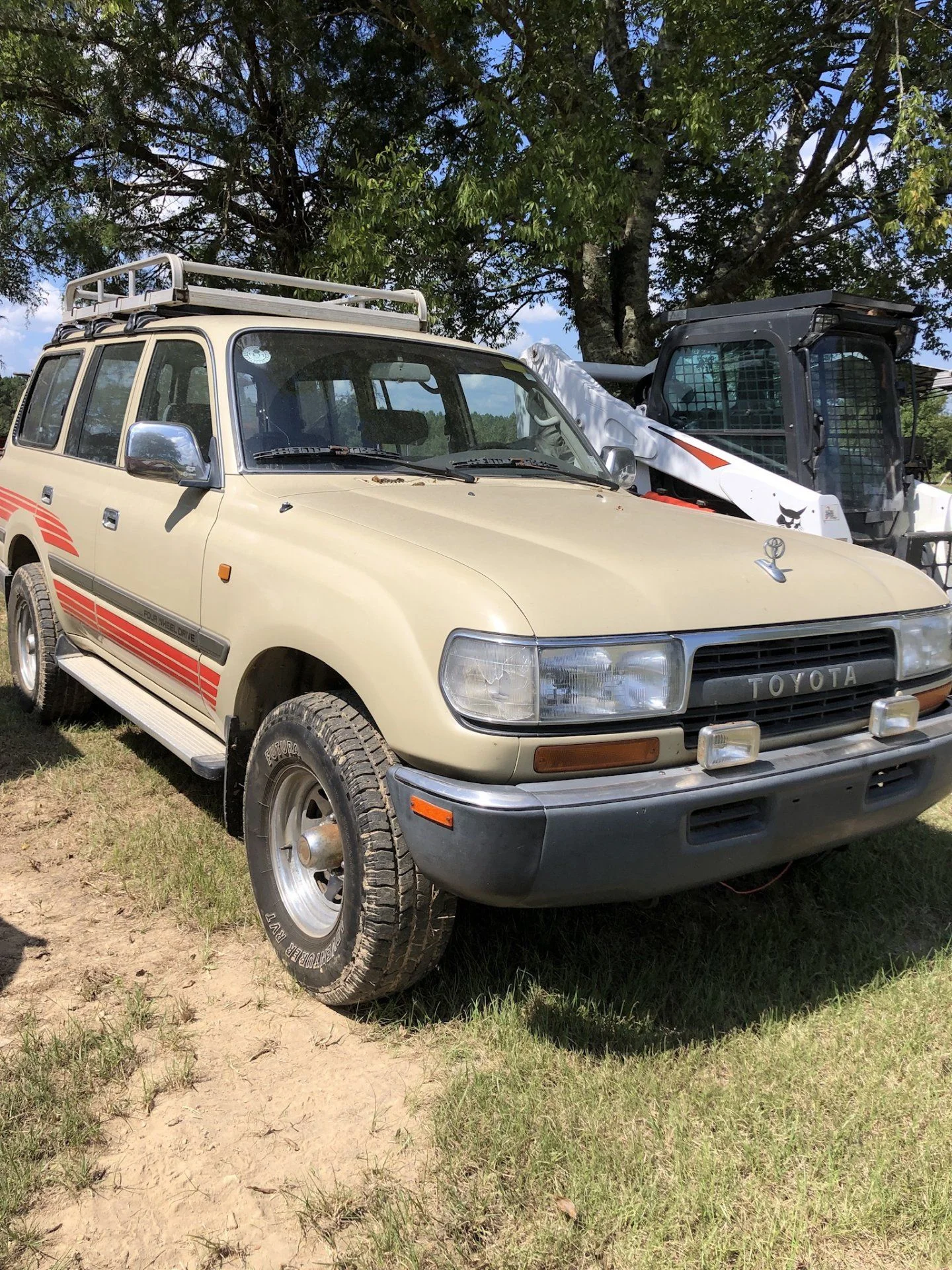

Way back in September 2019, I was told about a “weird looking” Land Cruiser at a shop in Brookhaven Mississippi.
I use Toyota of Brookhaven for all my new Toyota sales and service because it’s worth driving 80 miles to deal with a dealer that cares.
While I was down there getting my TRD Pro 4Runner serviced, I bounced over to the said location of this “weird looking Land Cruiser”
Turns out it was not there but the owner of the shop was a follower of my Mississippi food and travel Instagram See and Eat Mississippi and was kind enough to take me to his brothers house to see it
I snapped a photo of it, but since his brother was not home, we could not get a good look at it

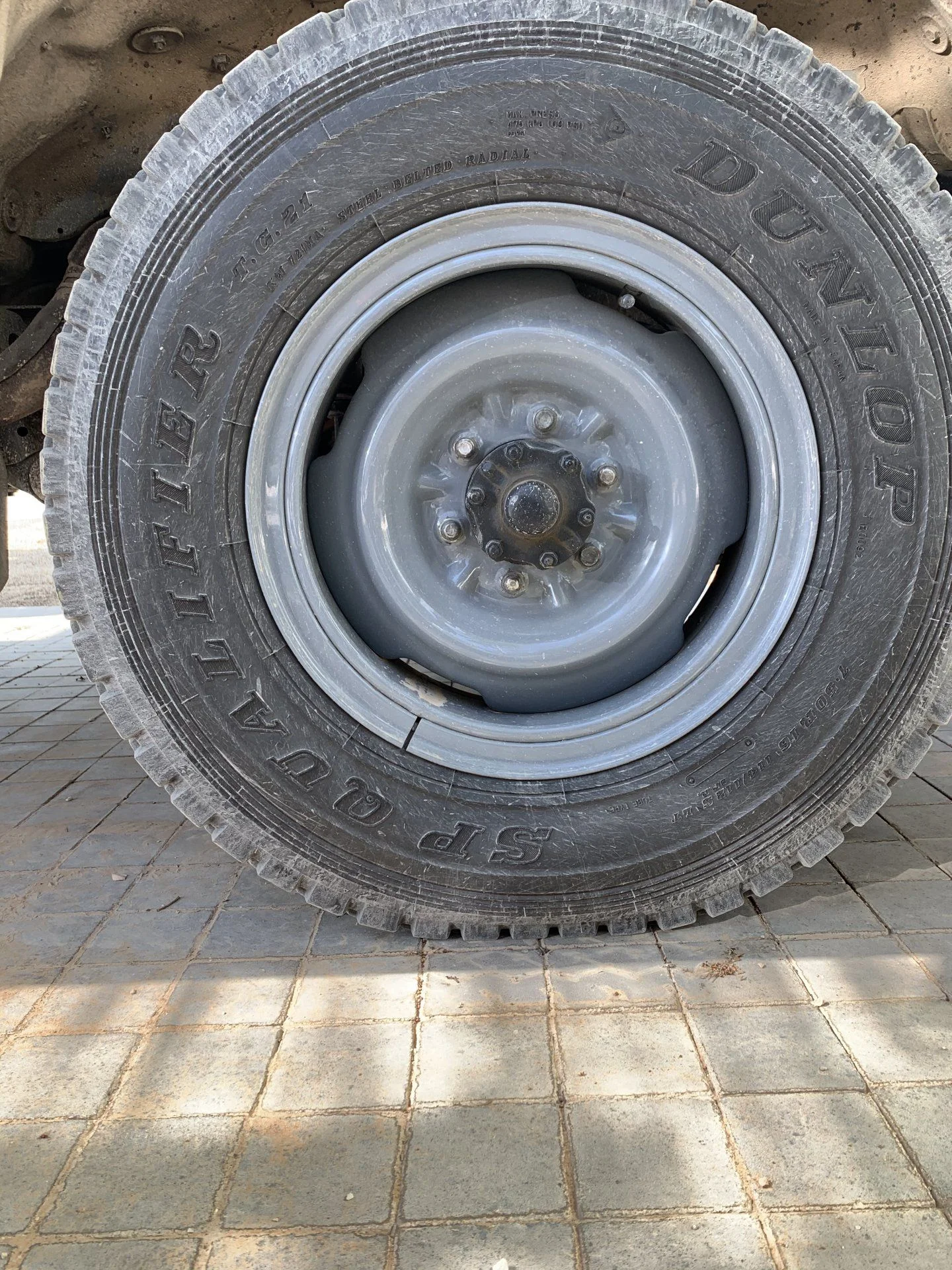

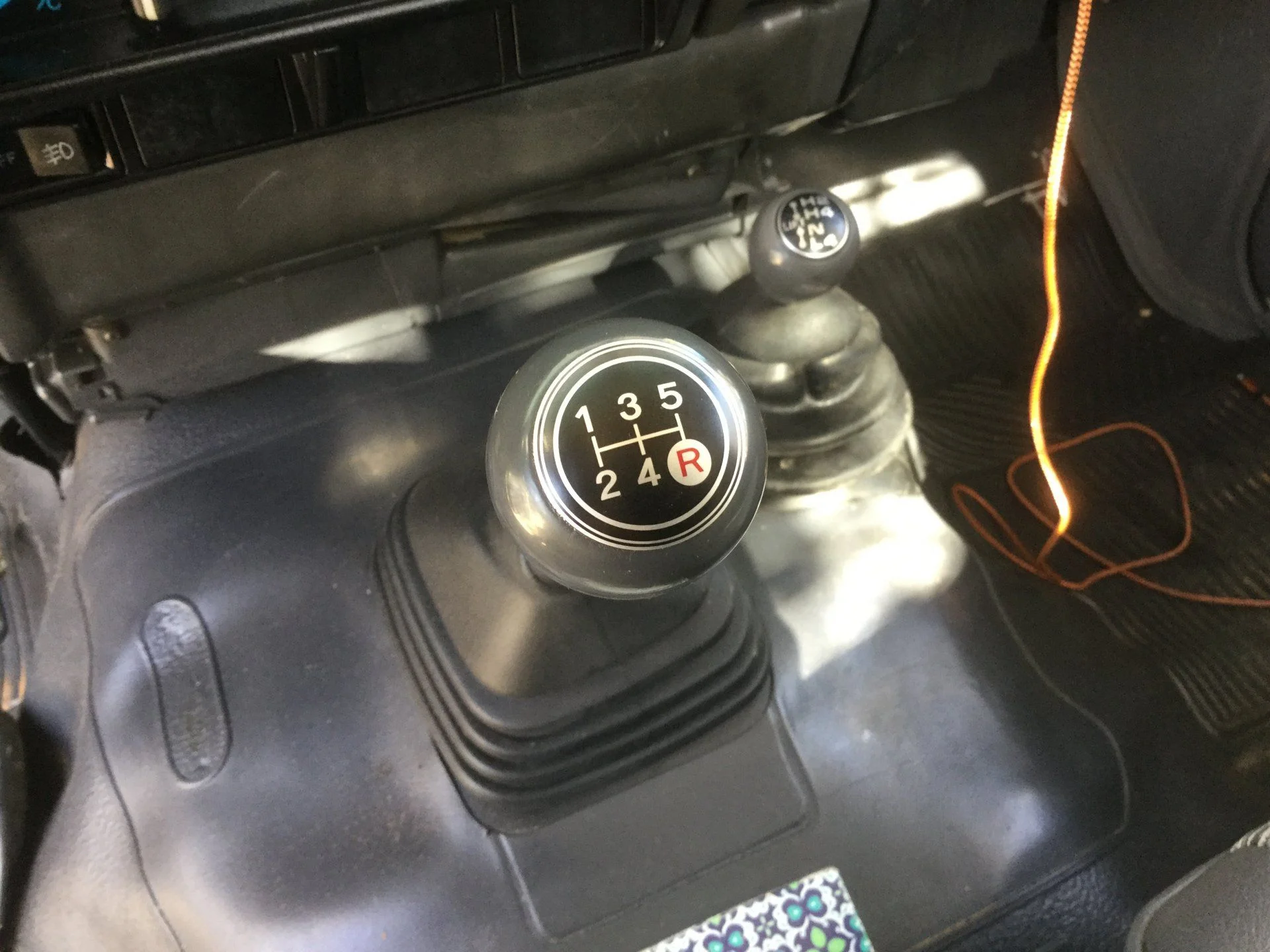

No hubs on the front.
Transfer case is 2H to 4H at any speed then lift the handle for N then 4Low

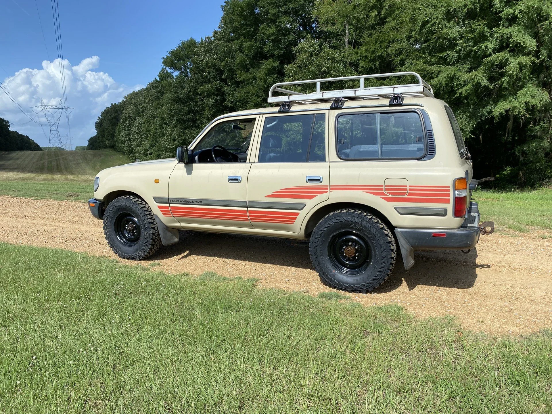

Heck yes. First thing I did was snatch those chrome rims off.
The fit is great. I’m painting up some Summit steelies today dark gray that will get some Yokohama MTs. Stay tuned
Ive never seen one.
I think it has the same drive train as my '94 FZJ75 but it's still carbed. Front is always locked as far as I can tell on mine.
edit: pic of front hubs

Similar to the earlier 1st Gen Tacoma ADD setup with a manual transfercase, but a straight axle. Axle is live at all times but just not under power until in 4Hi/Lo.

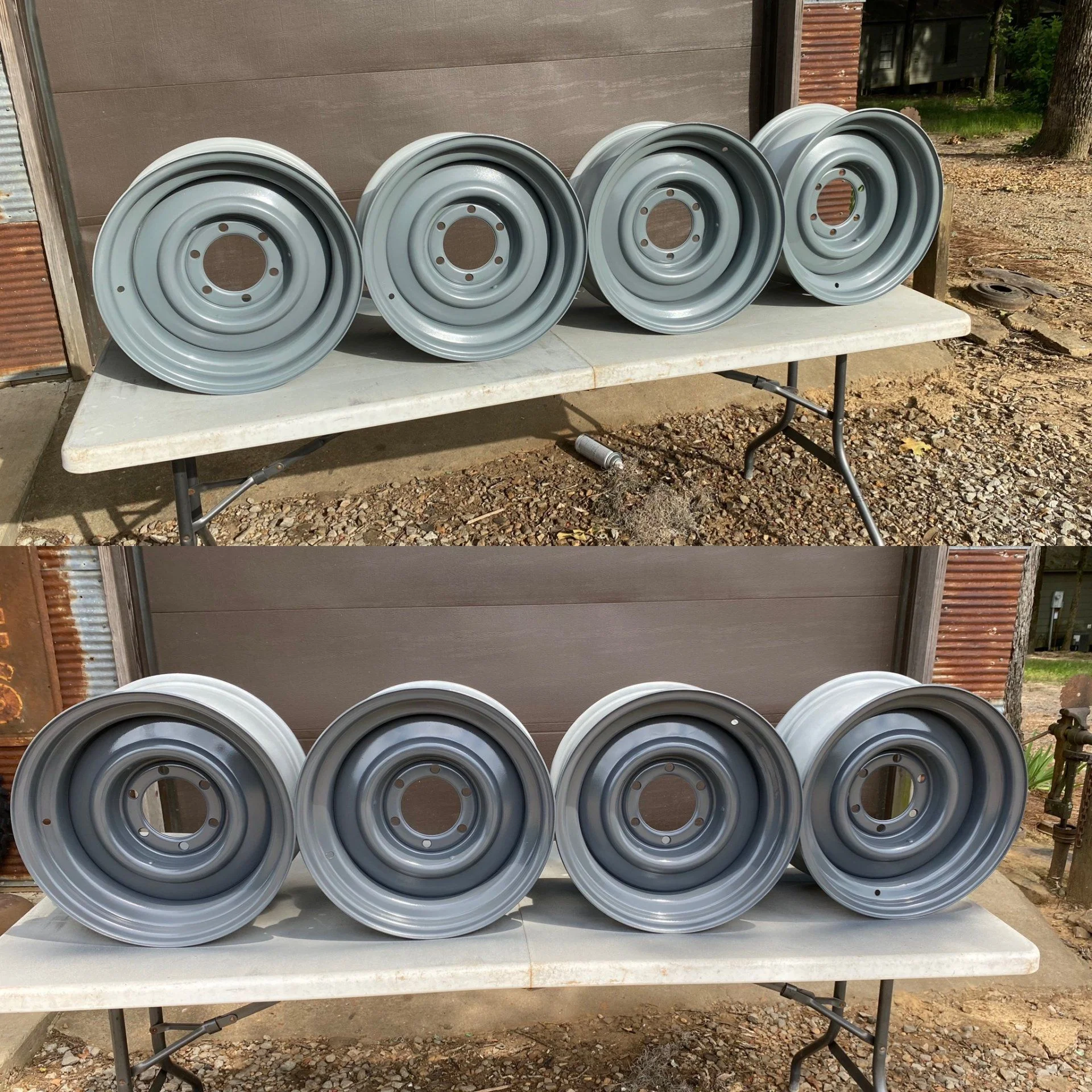

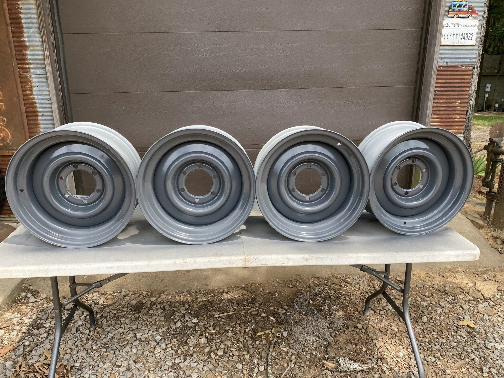

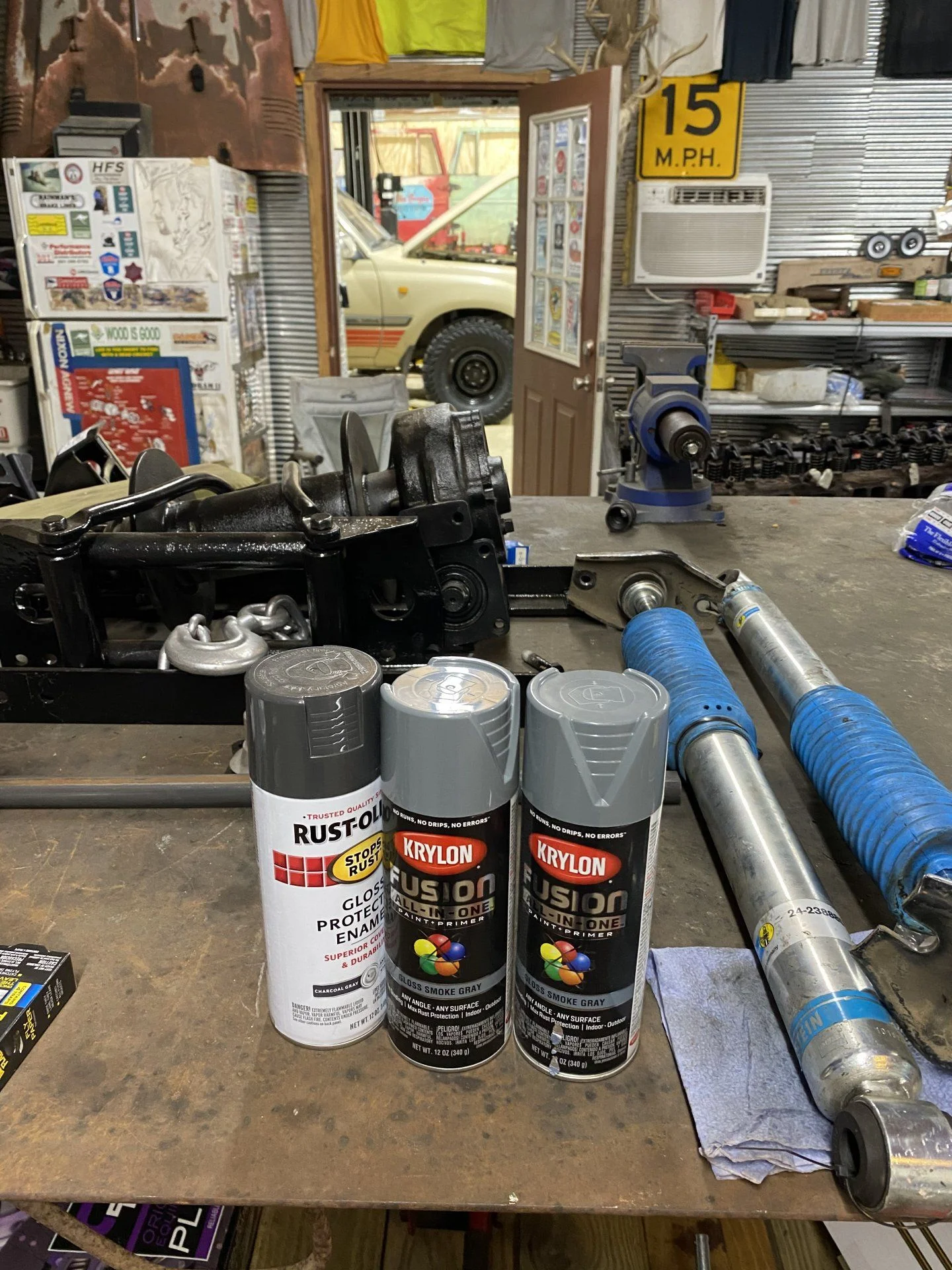

My summit steelies came in and I decided to go darker that the Rustoleum Industrial Gray that I use to match the color of 40 series steelies.
I bought Krylon Smoke Gray because the cap looked way darker than it ended up being so today I got Rustoleum Gloss Charcoal Gray and I think I have a good match to the color of the split rim that’s under the truck
Taking them for tires tomorrow
I'm stoked that they fit then. I think they're the best option for my 80! We don't have the accessibility of spare tyres here in aus, because I'd love to get some of the YA610 wheels one of the other guys have, I just cannot find a supplier for them here (or anywhere internationally either to be honest).
Excited to see what it looks like with summit wheels on it too!

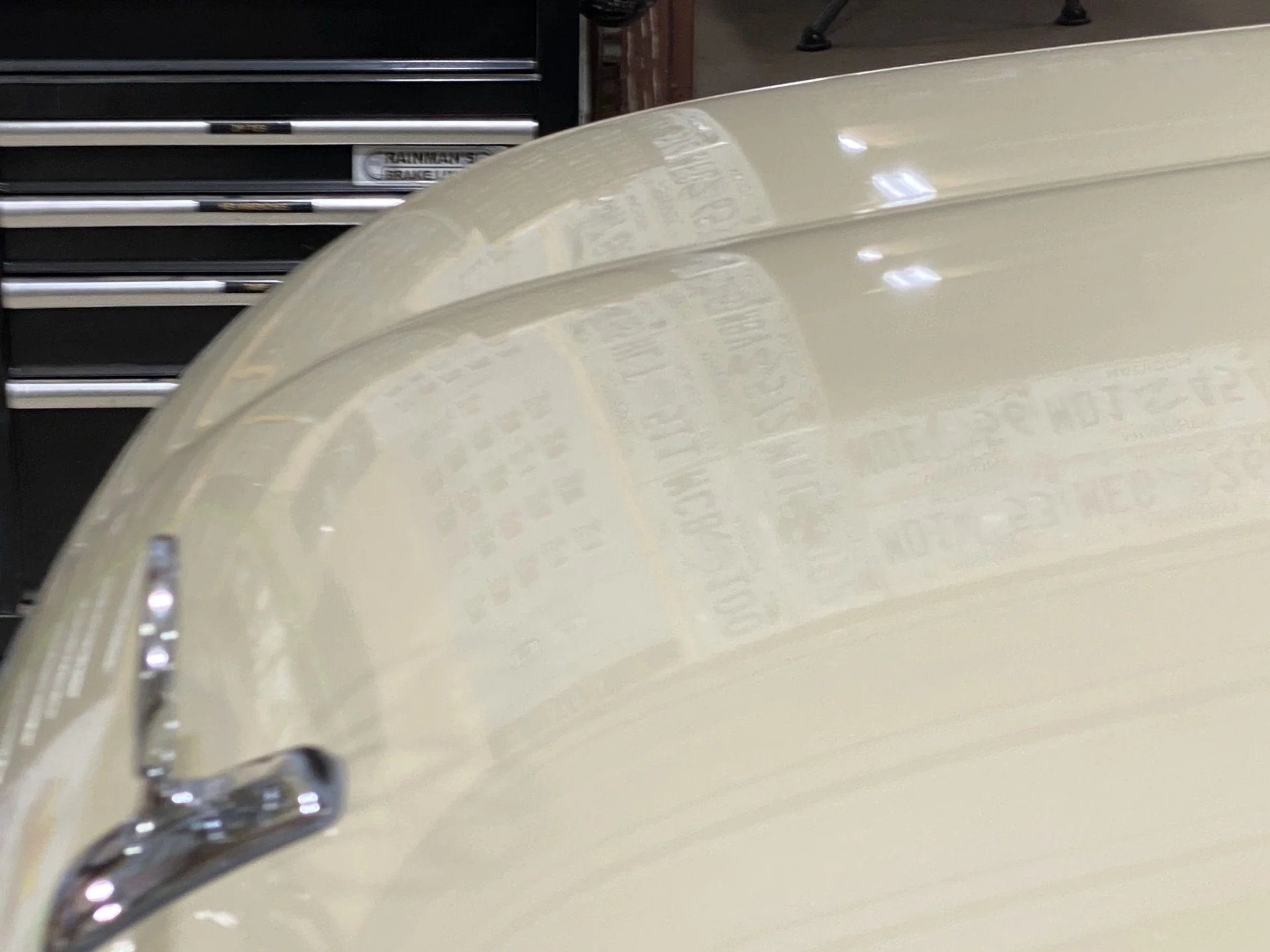

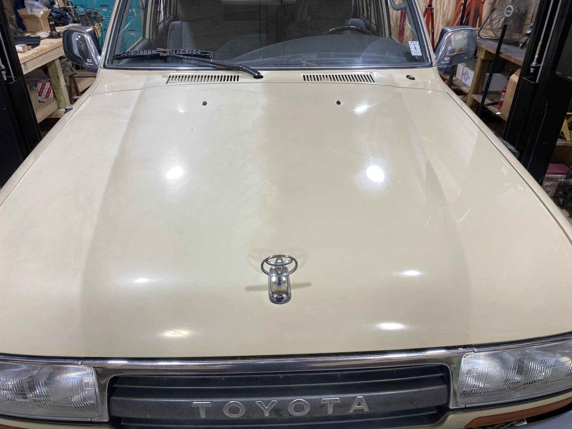

Those of you that follow my Patina Preservation stuff know how big of a fan I am of Toyota paint. I know this truck was never garaged in Saudi and since it was purchased in 2009 it’s been sitting outside.
Time to bring this paint back.
Griot’s Complete Compound is amazing stuff. I can’t wait to see the final results
