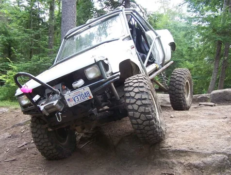

Anyway, I think the truck droops too easily in the rear which allows too much roll from side to side. Here's a picture of the truck from the front later in the day. Nothing to drastic here, eh?
Now look at the rear at the same time. Extreme extension while the opposite shock still has travel, I don't think the springs are too soft.
Here's a closeup. The spring is well out of the bucket.
I think I need to limit the droop be either attaching the coi to the top of the bucket, adding a limit strap or adding a plate on the centering pin that catches the top coil before it drops way out.
The shocks have 14 inch travel. By the time they limit the droop the rear is way high and the momentum yanks the axle off the ground on that side.
Anyone have any constructive suggestions?

Anyone got any constructive advice on the rear suspension?

I'm not much of a buggy guy but with that much travel maybe little winches to suck in the slop for off camber stuff may be ideal?
I do see that there is some sort of limiting strap there already.

There are a few ways to control this. Essentially the suspension is too soft for the weight of the truck. So you can:
can make truck lighter.
get stiffer springs.
revalve dampers to be slower(will still be floppy just less sudden)
add a sway bar
ditch the 3 link for 4 link and mess with your roll axis.
limit straps are meant to be used as hard stops when suspension droops rather than relying on your damper to stop the travel. Running a shorter limit strap will mask the situation by limiting your articulation.
A suckdown winch is a cheap($50-100 Harbor freight) masking solution. Ie pull truck down when you don't want it floppy or let it out to allow it to articulate..
also. without the top of the spring attached your spring rate is zero when the axle is trying to droop. When its attached the truck is trying to extend that spring. So it will stiffen the articulation and help it be less floppy.
my $0.02. hope it helps.
Also if he captures the top and bottom of the coil it will stretch it. This will weaken the spring I believe. As coil springs don't like to be stretched.

I appreciate everyone's input.
The limit strap in the center was Rick's idea since he has one on his rig. However, his is only there to limit down travel to the point that the ujoint angle doesn't get too high on the drive shaft and then bind. That's not my problem, but I humored him anyway since he's a good friend.
A center strap actually really doesn't affect how much the end of the axle can droop unless it is very short. That only makes the center a pivot point. I'll be losing that strap soon.
I'd definitely like to have limit straps on the shock mounts to prevent abuse to the shocks so they can't limit out at full extension.
The shocks are about 35" extended and are angled toward the center of the rig. They sit at about 3-4" exposed rod on the level. They are 14" travel, but the angle of the shocks makes that closer to 20" or so. I could limit them at 32" and still have about 16" of travel.
I already have the winches that I need to do the suck down, but I would rather cure the problem first rather than just addressing the symptom.
I don't want to go from the 3 link with the Y to a 4 link. This isn't my personal build and I don't want it to become a huge project. I bought it to go wheeling out of the box instead of sitting at home and lamenting while Minnie is laid up because I have zero time to work on her. Minnie is crying in the meantime.
I don't think this rig is too heavy at all, especially in the rear since most of the frame rear of the axles is gone and the body is hollowed out back there.
I considered stiffer springs, but the ones I have never seem to bottom out. The rear does sit about 1.5" higher than the front, so maybe the rears could be lower and shorter.
