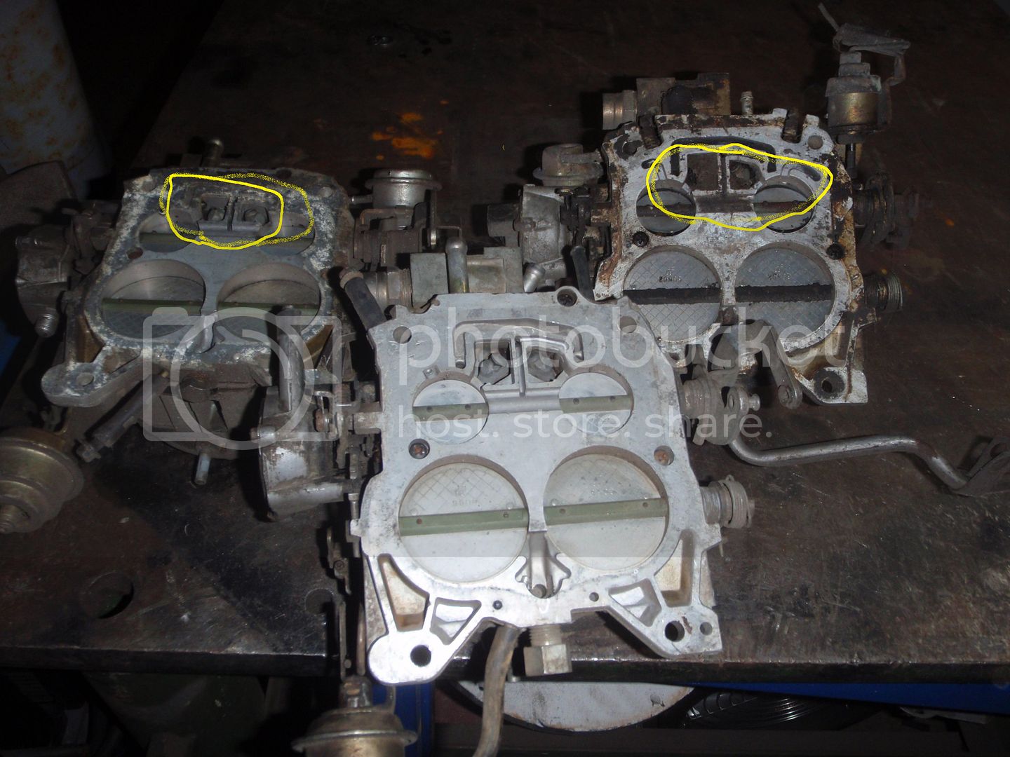

I think I have a couple carbs that I can demonstrate the issue (the leak could be internal).... too be continued tonight.

alrighty
you'll see where the carbs are circled - one has additional vacuum channels compared to the other 2
and actually, that's not the one that I was looking for - I had a cadillac one that had a vacuum channel by the brake booster that ONLY a cadillac gasket would cover (it had the other half of the channel in the stock, cadillac manifold).... point is, be sure you got the right gasket.
oh, and note there is no difference between the chokes - on the right is an electric choke, and on the right a heat-riser choke
