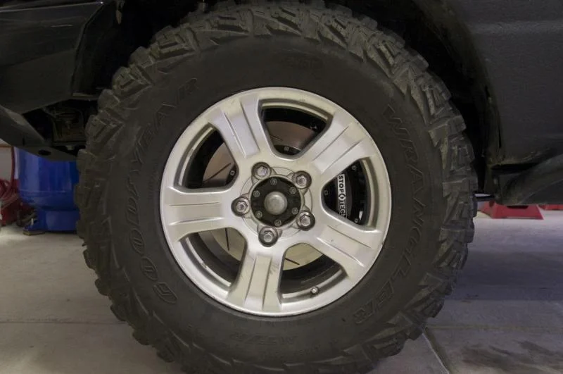

it's been done already
attachment.php
Nice setup. That's doing it right! I think I see rotor to hat fasteners. Are they floating rotors?
