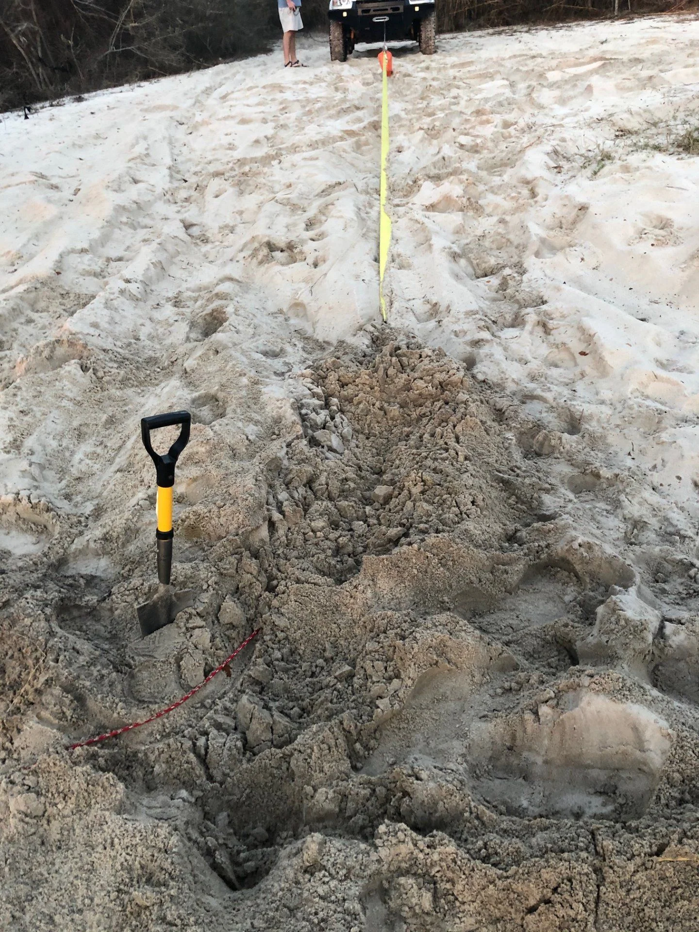

Here are pictures we took of test 2. I realize that we don't have any pictures of the anchor, but google "14 pound danforth anchor" and you will see one.
The set up. You can see the truck is a good distance away so that we didn’t pull up on the line. The sand is soft, but not the softest I’ve seen. We both went in there without airing down and didn’t have a problem.
The bury. The anchor is down there. The red line is to pull it backwards to retrieve it in case it got buried deep.
The pull out. You can see the trough it made.

Interesting test and about what I expected. I would imagine for your scenario in the sand, recovery boards like Maxtrax and a shovel would be wise investments.
Agree. We have those, but wanted to see if this was another option.

Thanks for the interesting test. Looking at images of a danforth anchor the results aren’t surprising. There’s not enough surface area and the angle does not encourage the anchor to dig deeper when pulled at a shallow angle. An internet search of “off road sand anchor” returns several options better designed for the task.
