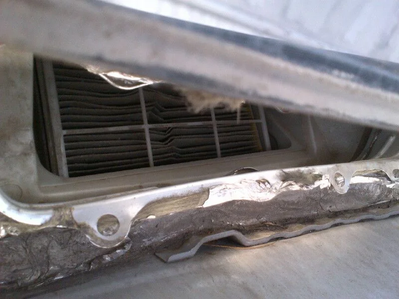

I looking under my cowl top ventilator louver and the blower is completely exposed. Was something supposed to be here that was removed?

Ill take another pic tonight. It requires removing the cowl louver vent, the black thing between the hood and the windshield. Appreciate the effort.

The previous pic is of the hole. This is the location of that pic, underneath the cowl louver vent cover. (black plastic piece with vents)

If picture #1 is directly under picture #2, then something definitely is wrong. Water would pour in.

I think the cowl should re-direct the water away, is there any sort of moulded duct on the underside of it? What's required to remove the cowl, I'll try to pull mine off tomorrow and see what's under there
Thanks for all your help guys. The Toyota of dallas parts department hooked me up with the pn. if any of you are in a garage right now unscrewing your cowl to get me a pn, Ill keep the deal going for two hrs from this post. just to be fair. send me a pm with the pn

Didn't have time to pull the cowl off today, I've been meaning to in a long while as I usually find dried leaves in the ac filter so I'm sure a bunch must be stuck under that cowl.
Also did you try using toyodiy to check for the part numbers? You can enter your vin and access the full parts catalogue like the parts shops do. I managed to find the cowl p/n fairly quickly on there but the image in the diagram looked nothing like what the cowl looks like.
If you haven't used the site give it a try, it was a huge help to me in finding part numbers
