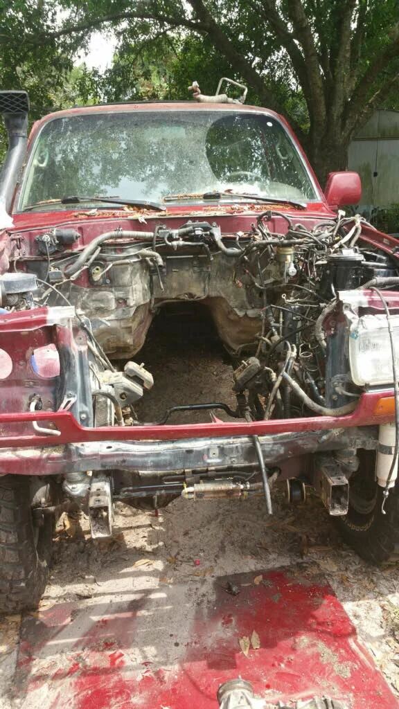

Alright. Some of you know my original motor had a horrible knock after ingesting some h2o. I was going to rebuild it until I heard TRD superchargers are all gone. So I opted for a gm ls swap. I have marks 4wd adapter kit with engine mounts and tranfercase adapter. I recently moved and have no tools and no place to work so I've been storing and working on my truck at a friends house. He broke his back recently and is unavailable indefinitely. I can tow the truck and parts someplace if Anyone is willing to do a tech sessionsession day. I am only available this weekend and alternating weekends... Please let me know...

Do you have the wiring harness yet? How much is done so far?
Custom stand alone wiring harness is all set to go! Computers are unlocked and ready to go.
Motor is a complete pull 2012 6.0 cast iron v8 with vvt. Motor code is l96 truck motor
Came out of a 2012 2500hd. Has 10k miles on it
Trans is a 4l80e out of a 2007 2500 HD has 25k miles on it
Custom computers to keep vvt active
It is drive by wire throttle body and the corvette gas pedal is ready. Maf is included in the custom wiring harness
I've been chipping at away at this project. Y pipe and first cat are off. Both drive shafts are off. AC condesor, radiator, transmission cooler and radiator support bracket are all off. power steering is disconnected. A lot of the oem wiring harness is disconnected. Battery and tray are out. Fan and clutch are off. Captured the freon and AC compressor is unhooked. Washer resivour is out. And I'm sure more I'm missing
I think we can handle this in one Saturday. Fastest eustom engine swap ever?
Oh come on! You have to give us more than that!
So how's it going? This is the last pic I have from you!
Any updates at all? Are you going to make it?
