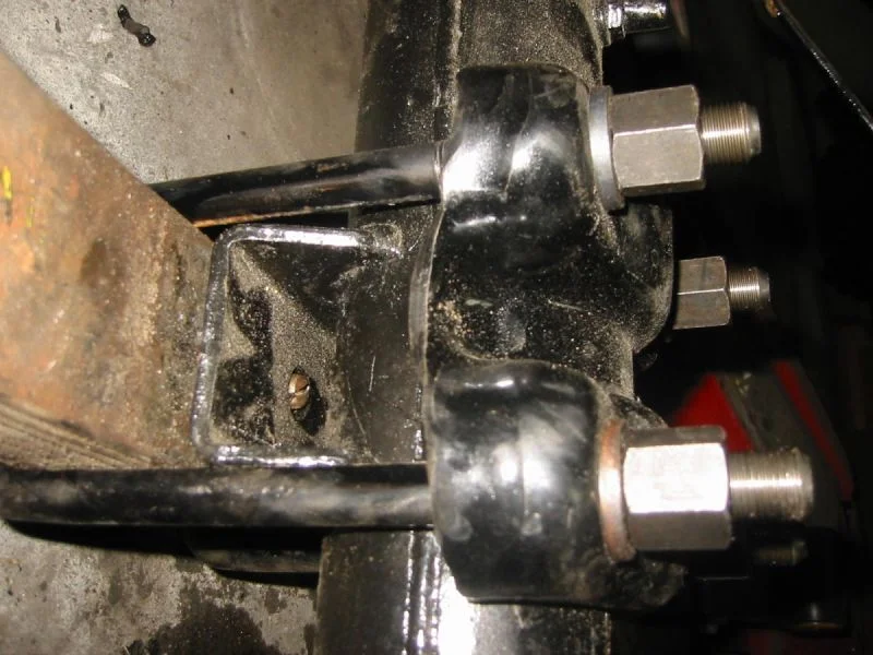

I think we'd all benefit even better from a U-bolt flip kit. I'm sure you all know how much those cost. I've given it a lot of consideration, and I think that the old Pirate4x4 DIY solution is the best. I mean, for under $15 a piece plus some plate and bolts, you can have your only using very nice GM parts. I WON'T buy those U-bolt Flip Kits from you know who, only because I think they are outrageously priced. Anyway, if you all are interested in fabricating something, I say we at least look into using the GM axle stuff. It's very nice and proven. Here's a pic or two of the GM parts. BTW, they are $14.14 a piece from GMpartsdepot.com at this very moment....also, the last pic is the "Old School" way of doing it...this link to Pirate is pretty Old: http://www.pirate4x4.com/forum/showthread.php?t=214334&page=2&highlight=ubolt+flip

Will the GM versions work for us??? What about u bolts? Make em?? O/W you're praying that they fit the hole pattern obviously.

You'll need different u-bolts with the square end on the bottom of the spring to run those so don't get the ubolts in your kit.
Will have to look at the OME springs... if they are close to the stock ones I have now... the U bolts will have to be 4 foot long.
