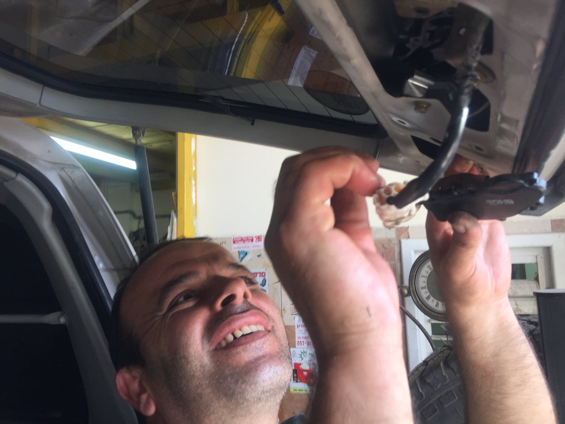

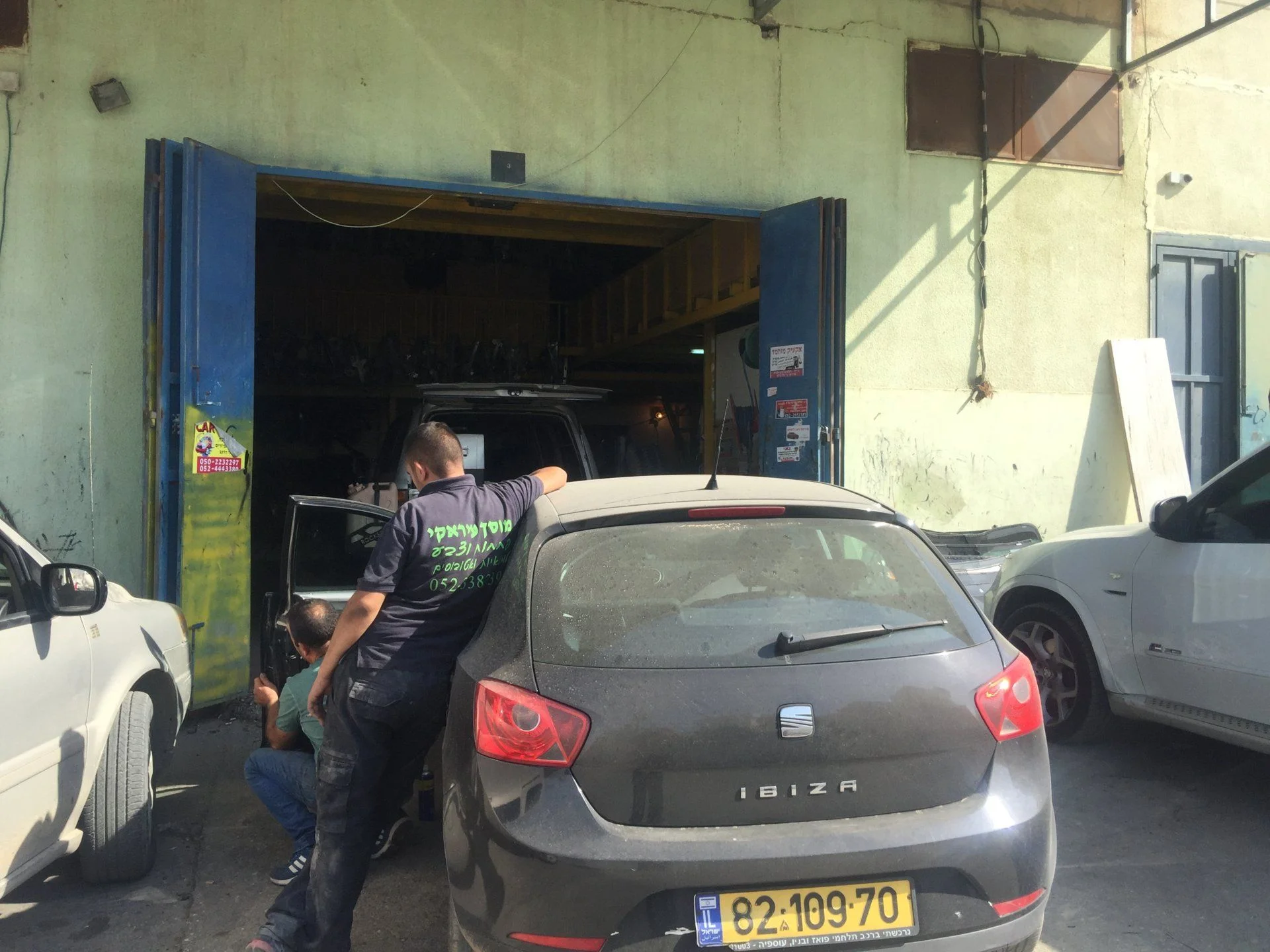

I have a problem with my tailgate power lock it didn't work the day I bought the rig. So I drove to an Arab village to fix it. For many years I fix problems like this I go to this small shop that dose power locks, power windows and Glass work, Israeli mechanic will pull the bad part and will install a new one and take a lot of money, you don't have new part? Then piss off and he will charge you for diagnostics.
This guy fixes a thing that he can salvage and charges very little.
So I went there

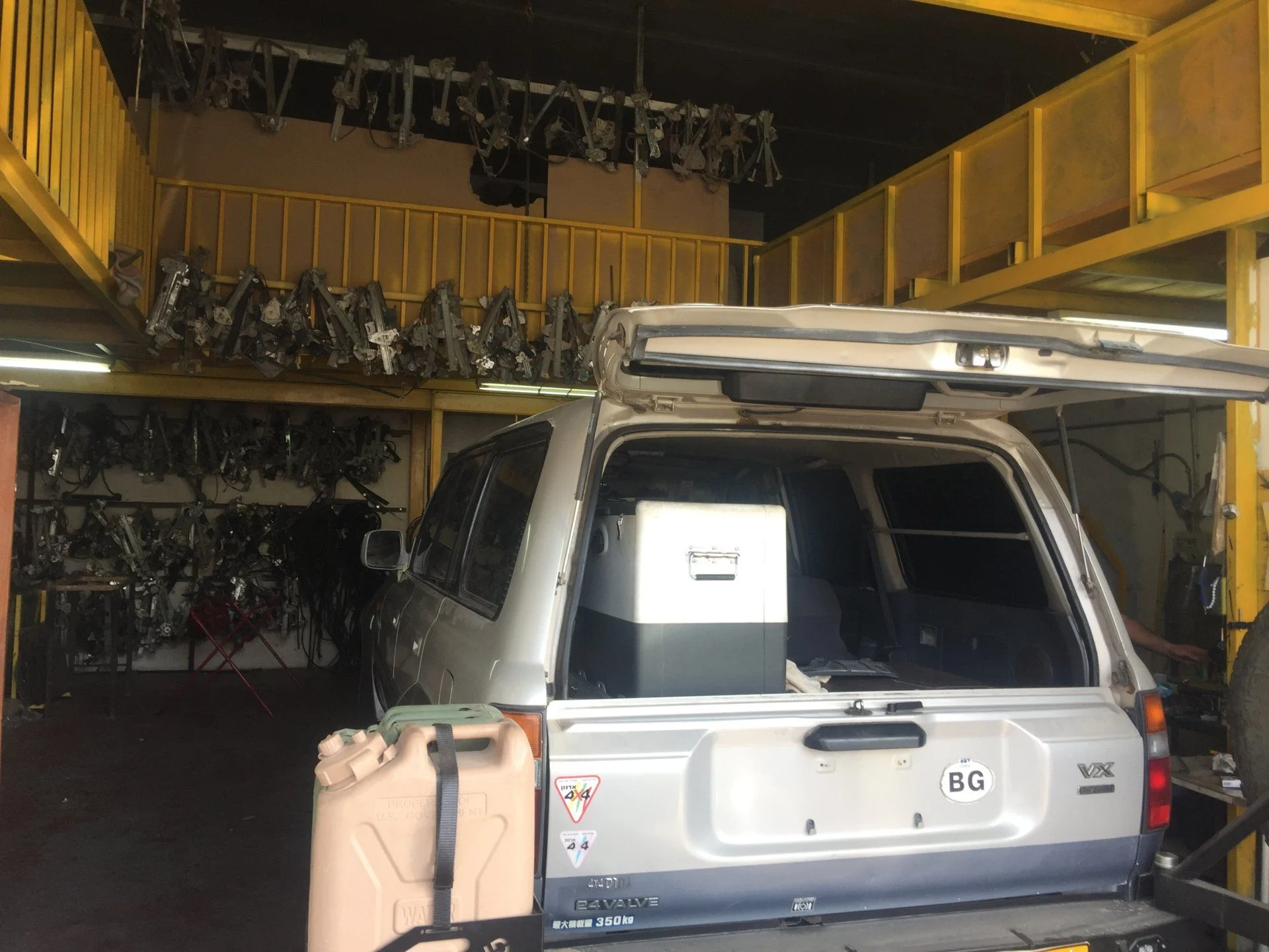

After that we went to work he worked and I watched and he opens the actuator and he was tost :(
The plastic gear was dead. Then he took care if the passenger side window that always was doing imitations of the turtle he cleaned the mechanism but told me that we will need to attend this in the future, then I showed him the absence of rubber seal on the driver window from the inside and he told me I better bay new OEM parts for the tailgate and driver window.

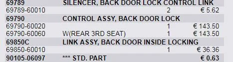

Here is the problem went to the EPC and it gives me 2 options
69790 - CONTROL ASSY, BACK DOOR LOCK
69790-60060 CONTROL ASSY, BACK DOOR LOCK W (REAR 3RD SEAT) (01/1992 - 01/1998)
Or
69790-60020 CONTROL ASSY, BACK DOOR LOCK
How can I tell what was the rig originally?
My guess, and that's all this is, is that the 3rd row version includes the child safety lock feature. Flipping a little switch on the underside of the lift gate makes it so you can only open the lift gate from the outside.
this would be my guess too. The child lock.

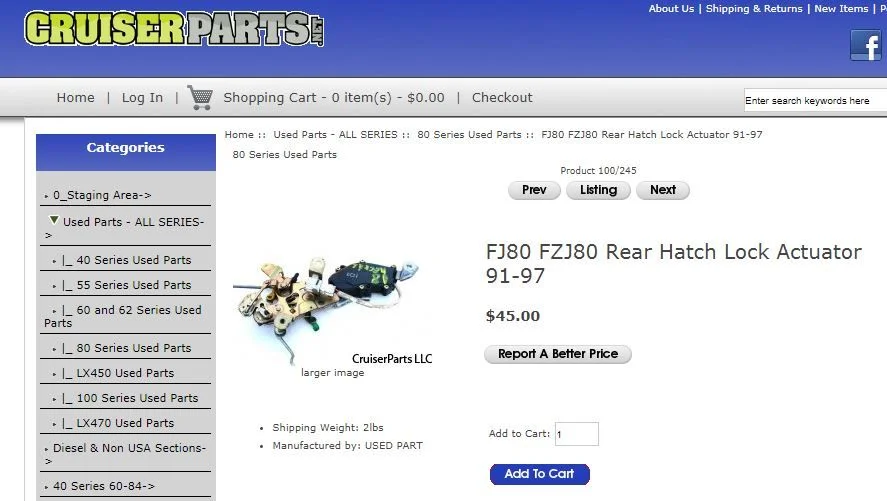

You can try this site: ToyoDIY.com
and enter your VIN number or just the trim level. It's a great resource for part numbers on non-US rigs.
You're saying 80's with 3rd row seats have a child lock toggle that disables the interior handle so the upper tailgate can't be opened from the inside? Interesting, I've owned 3 of these trucks but all had no 3rd row seats.
If the above is true, that's the OP's answer right there.
Do you have a tailgate child safety lock feature on your rig?
My 95 has the toggle and 3rd row seats. I just replaced my lock actuator and had to get the correct one, but I knew my rig had the 3rd row.
Dino- did you enter your VIN? That should tell you if it came with 3rd row or not. Or, since yours does not have a 3rd row now just get the 60020 unit and you should be set. The 60060 unit should have the toggle on it. Mine did.
"Dino- did you enter your VIN?" yes, I always do use it, it gives the best match
The confusing thing was that the title papers declare it 7 seats (and in Israel you will pay more customs than for the same car with 5 seats)
With old SUV in Israel it happened to me that the PO didn't need the extra seats, but needed the space and dispose of the 3 row seats.
If your truck was delivered to dealer with seating for 7, you'd have the 3rd row seatbelts and floor brackets and catches for the 3rd row seats fitted in place.

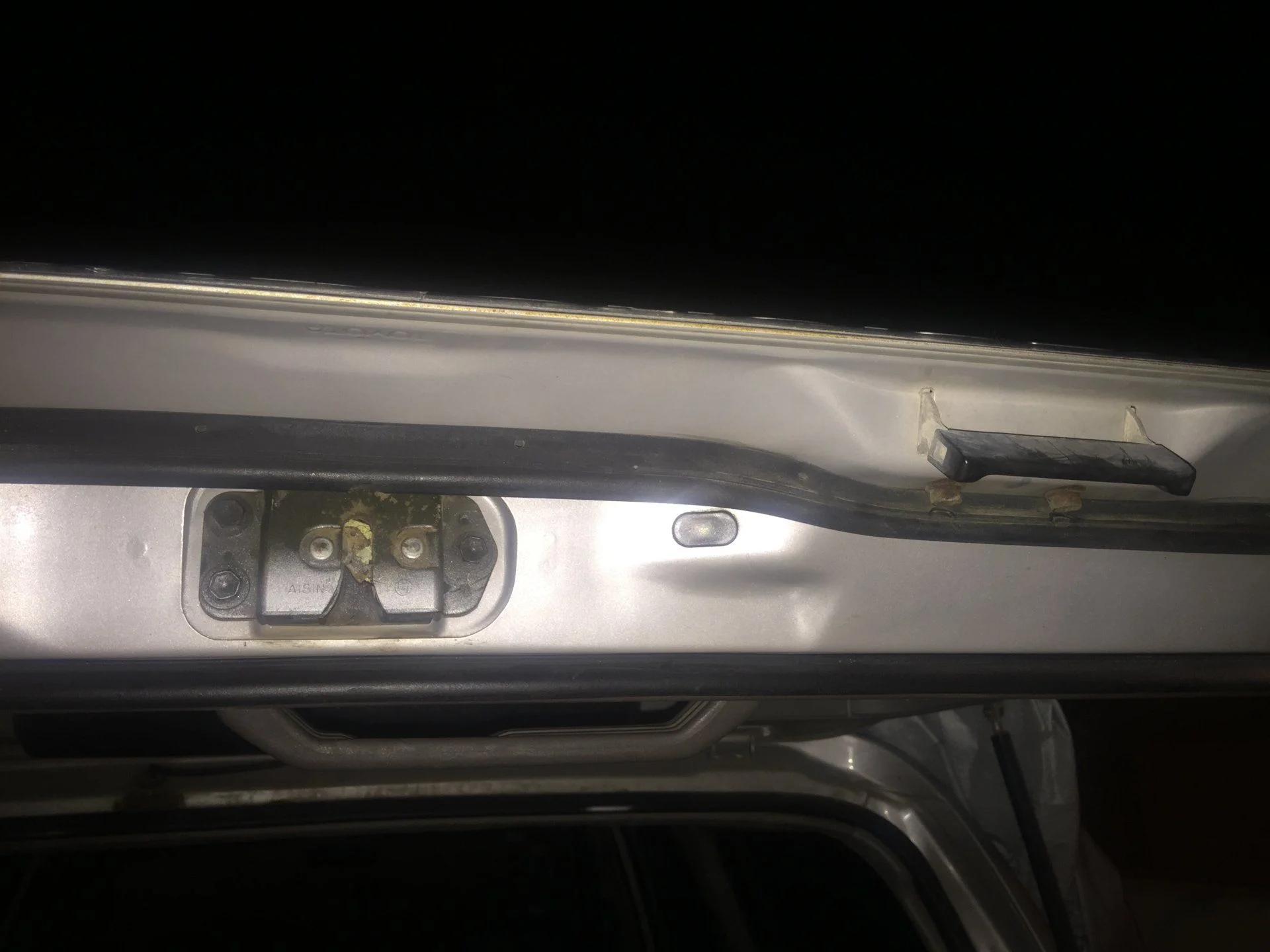

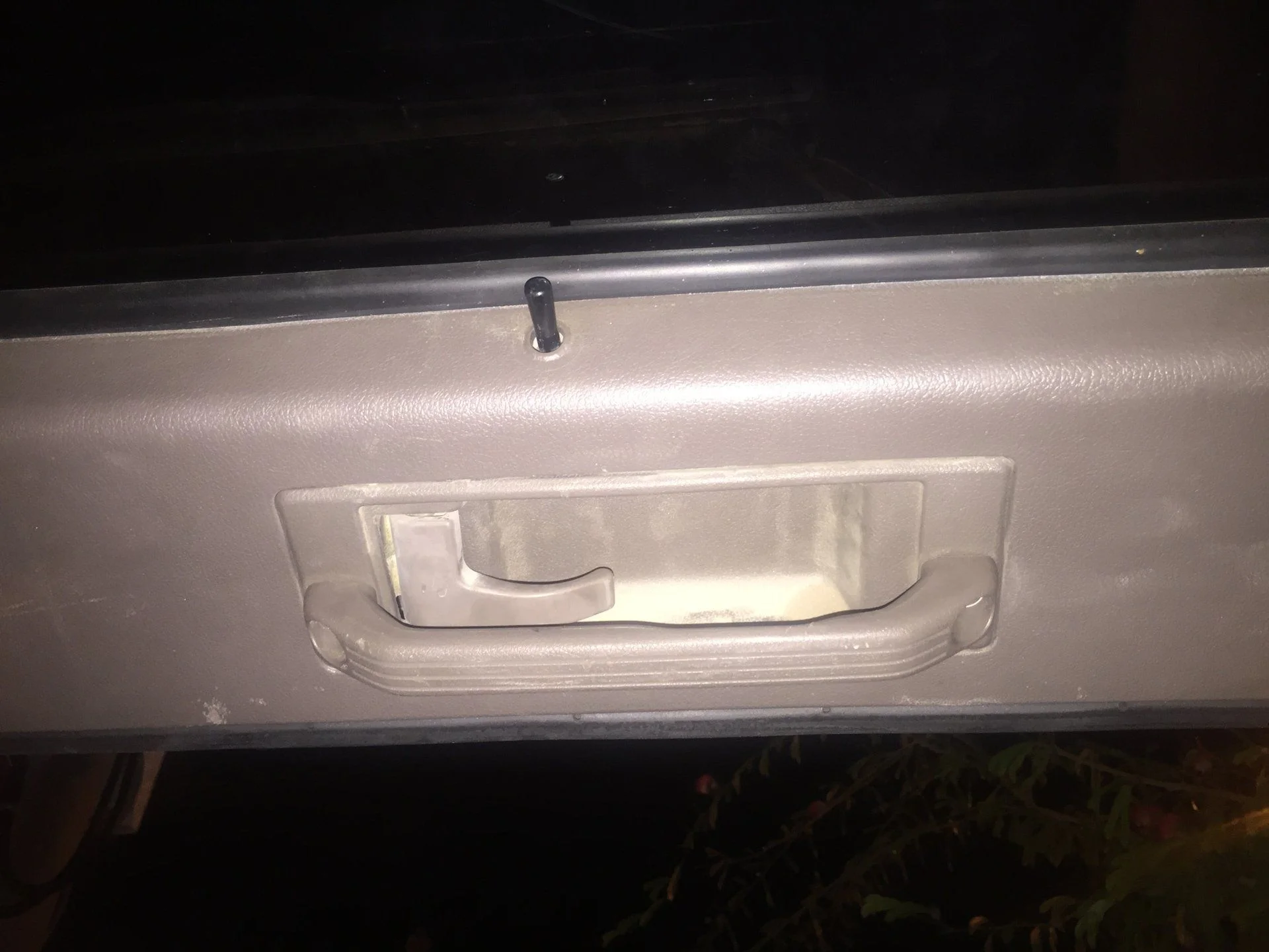

Went out side now in the middle of the night in and took a pic of what I have on the tailgate upper door
I was hanging around outside the local Curves gym, as you do, and took a shot of my US-spec '94 that had 3rd row seating. Ignore the red and black wire in there (power wire for future LED lighting). You can see the black, plastic toggle switch for the child safety lock. Yours seems to have some kind of protrusion covering the same area. I'm guessing that you could put either lock mechanism in there. The switch doesn't move very far, and it looks like the protrusion on yours would clear the switch.
