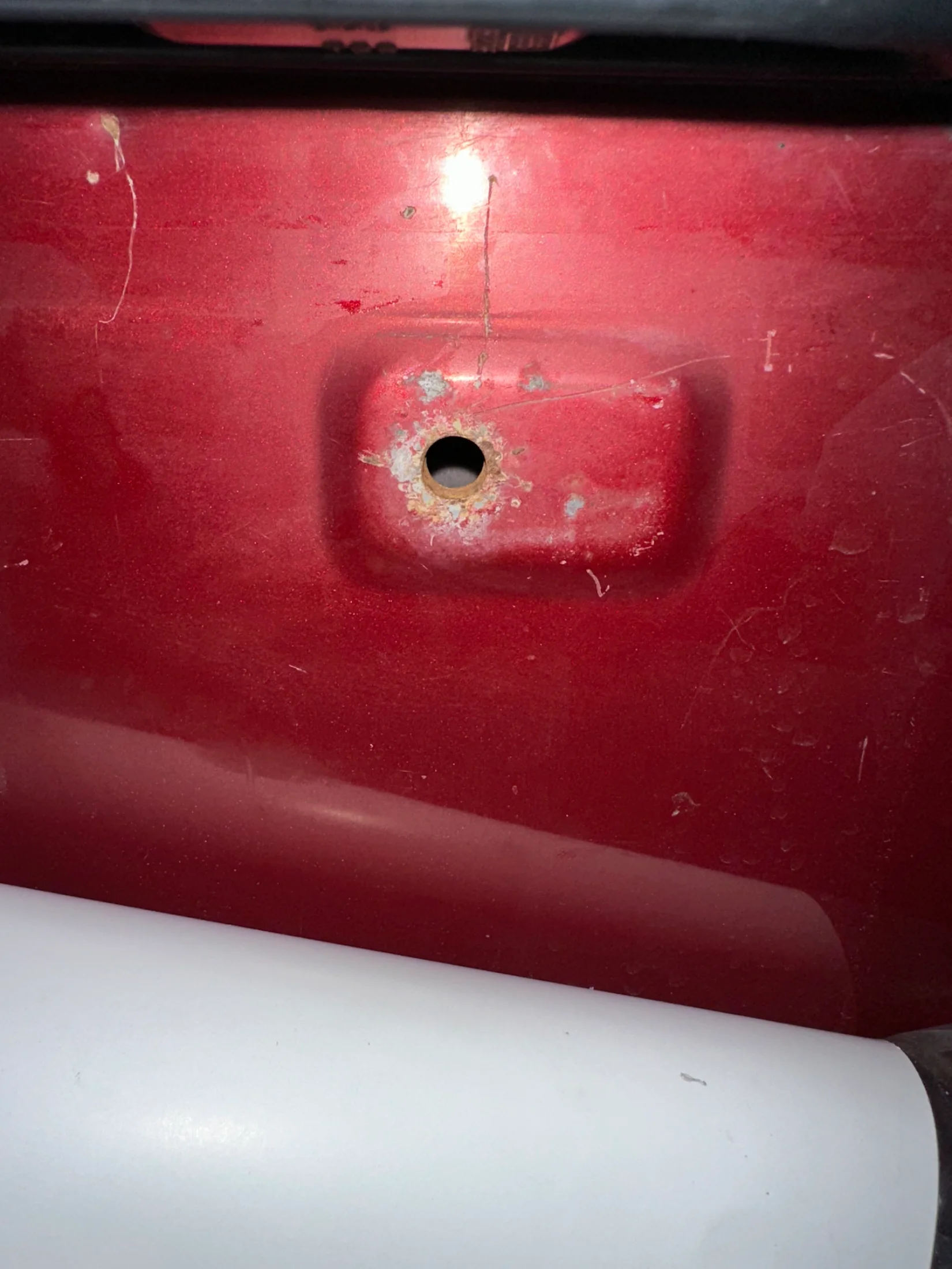

Hello, I am new to the forum as I have just purchased my first 80 series land cruiser (1994 FZJ80). Apologies if my etiquete is off as I am pretty new to forums in general. I have a question regarding tailgate license plate mounting. From my understanding they came from the factory with some sort of threaded insert to screw into. My tailgate does not seem to have those anymore so I was wondering what the best way to mount a plate is? I thought about adding some m6 rivnuts but it seems like they are too big for the holes and m5 is too small. It looks like someone tapped the holes previously but I’d prefer not to do that again to eliminate any more corrosion. Let me know what you think! Thanks.

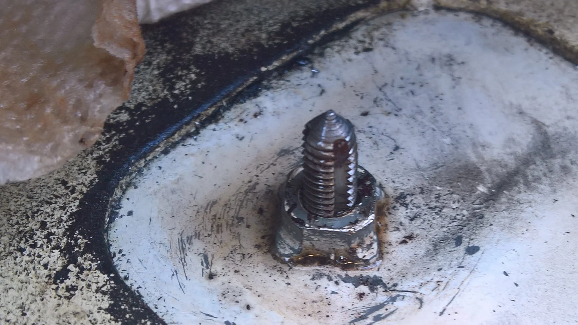

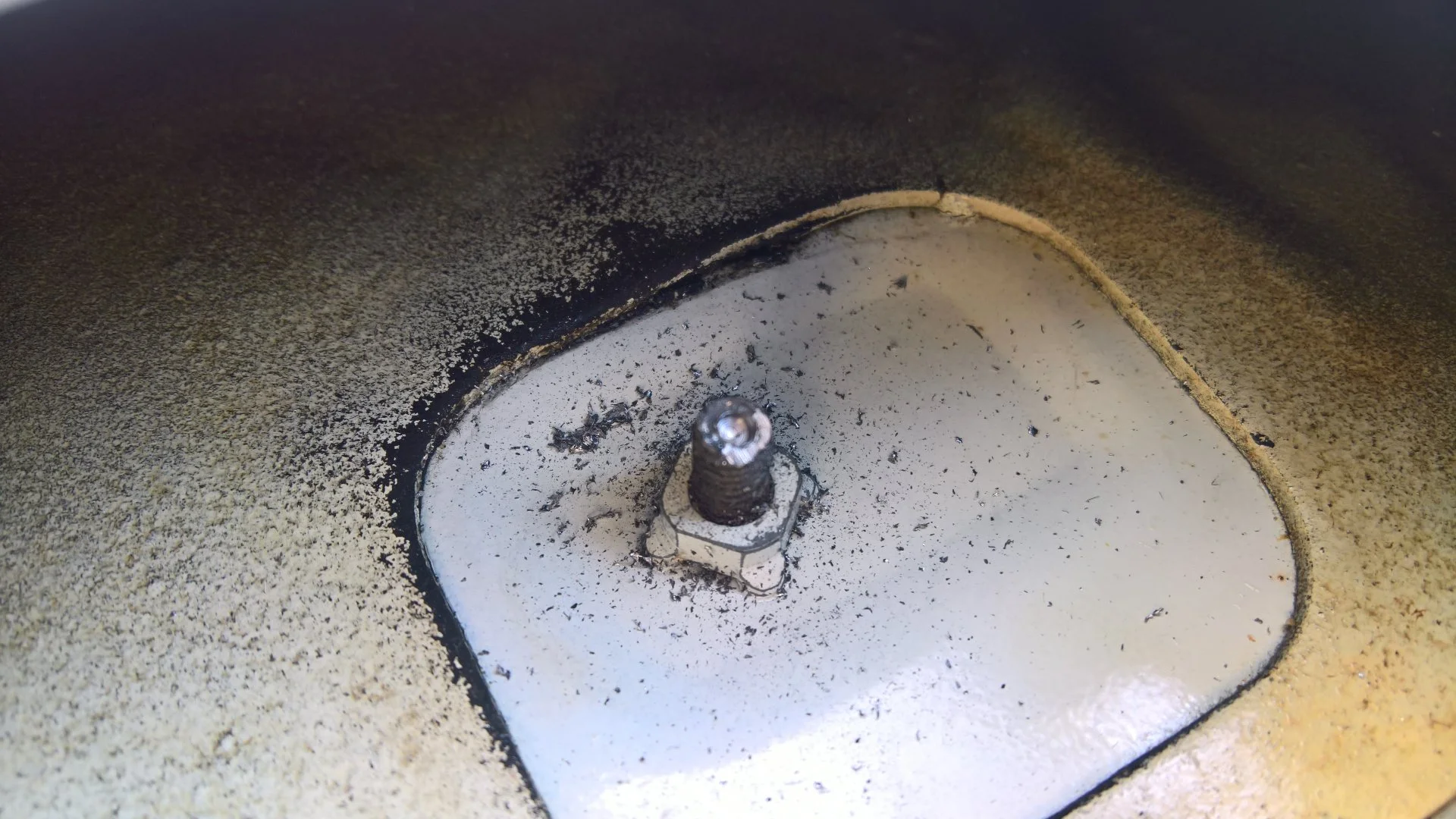

The original threads were M6x1 so assuming the original nuts are still there you might try running a (larger) metric tap into what's left to cut new threads into the factory nut that's welded into place.
Here's what one factory nut looks like inside the tailgate. It shows a snapped off screw/bolt, after a lot of fiddling, drilling, etc got the broken shaft out:

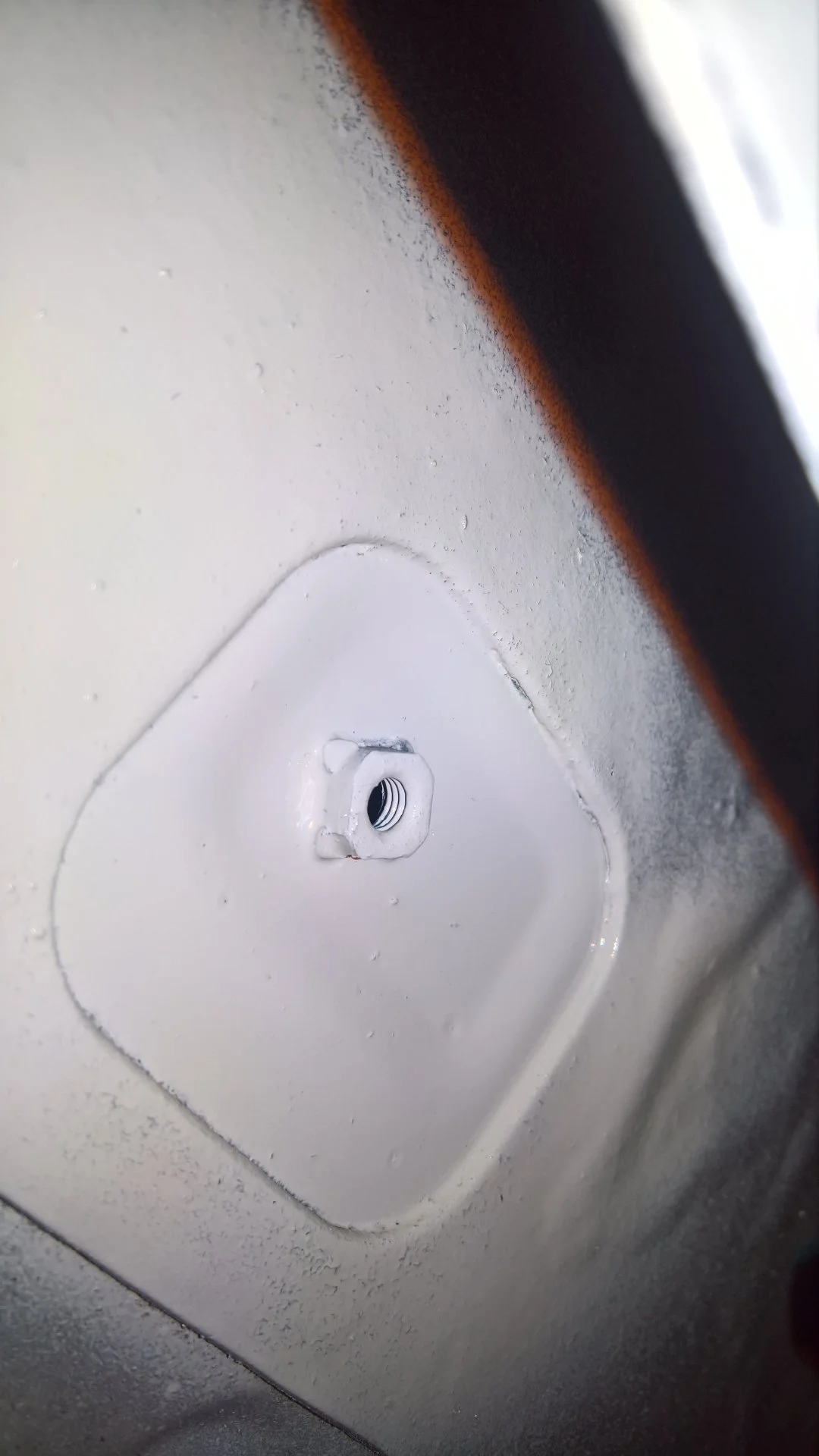

The threads were not gone so I just ran an M6x1 tap (original size) into the threads to clean them up:
After cleaning and painting:
TIP: once you figure it out consider installing stainless steel screws/bolts and apply a thread sealer to the threads to help prevent future corrosion
Thank you all for the advice. After accessing the back, It does look like the nuts are still there just drilled out like Mandrake said. I tried tapping them to a larger thread, but it seems like they were drilled out quite large. I was able to get some bolts to stay in there for now but they can easily fall out. I think I am just going to thread nuts behind the bolts and use some sort of grommets or rubber washers to make it as watertight as I can. The plate won't be as quick to take off but I never really have to and it isn't that much worse taking the carpet off the tailgate. Thanks again!
You could use a rubber washer on the outer surface of the tailgate ie: between the backside of the plate the body (liftgate) or even just a button of butyl rubber around where the new bolt goes through the body then the license plate will squish it down. FWIW
