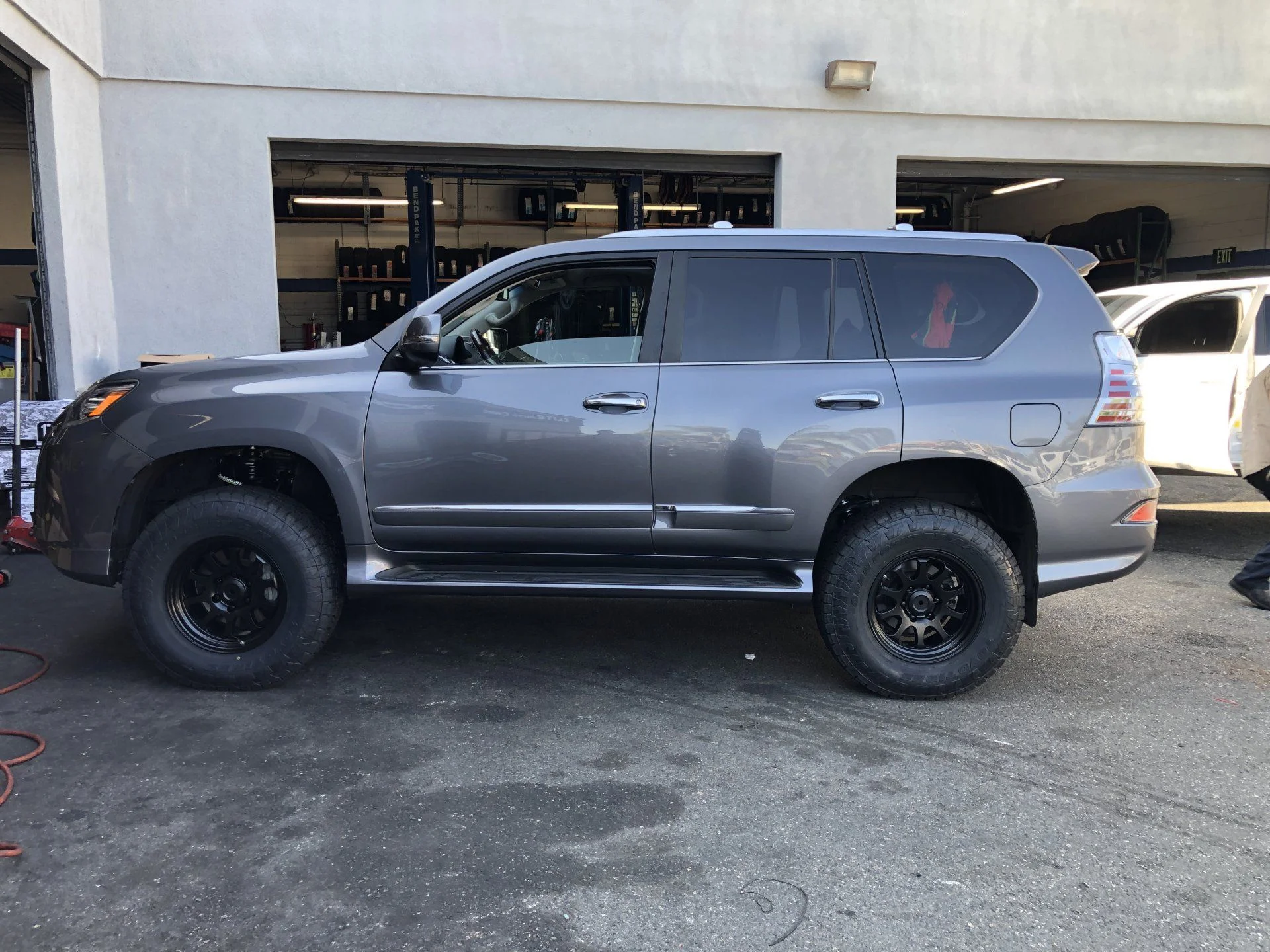

I just finished raising mine with an OME medium lift kit from Rocky Road. It rides great so far. Didn't cost an arm and a leg. Came with 4 shocks, rear springs, front springs, the hats for front struts, and new Upper Control Arms. I bought the KDSS spacer kit from Treaty Oak as well. Also purchased Metaltech air bag deletion kit. Money well spent - I'm not hardcore rock crawler just average off roader. Everything seems well balanced in my vehicle now. Would recommend to average wheeler.
Edit - I also purchased a Dobinsons panhard bar for rear axle.
