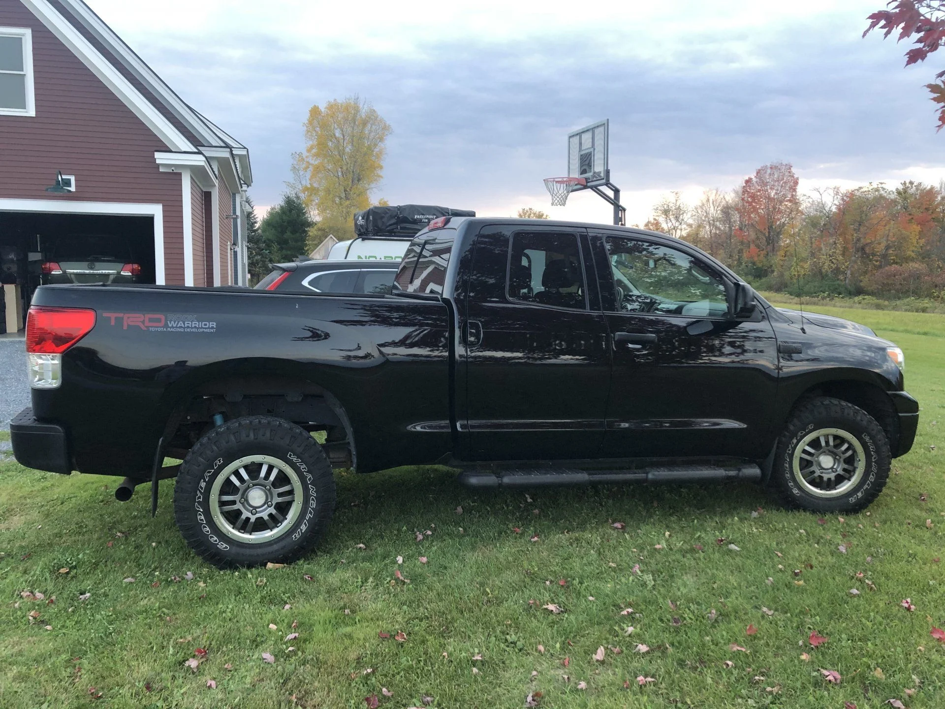

Hey all,
I picked up a too good to pass up deal on a local 56k mile 2010 Tundra trd rock warrior. I just sold my land cruiser with a King 2.5 suspension and my dealer just boned me on a deal we had agreed to on a 21 HE. I know, the tundra is a completely different beast, but I'd love to make this one handle even better. Any recommendations for a suspension upgrade from the oem setup with Bilsteins? Not sure if this is a long term keeper or just a fling. My true love is the land cruiser. My soon to be driving teenage son may inherit this one.

Thanks! I would love to do a nice suspension, but I am going to try to not build this one like I have with others. I'd like something to keep stock height, take out some rake, and keep an offroad friendly ride. (edit, Bilsteins are shot), maybe it is as simple as removing the add-a-leaf and restoring the stock TRD leafs?

I appreciate the offer, but the 17" rims with all terrain tires work well for my location (about half dirt roads).
I'm not looking for high performance handling - although I'd like something a little bit closer to the Kings that I had on my cruiser. I think the add-a-leaf adds too much stiffness, so compliance suffers. The bed has more bounciness than I'd like on dirt washboard and potholed roads.
I noticed yesterday that I have one front shock that is leaking oil (and has been for a long time), so I need to do something.
It looks like the Bilstein 5100 are only about $100 more than the factory Bilsteins, same labor for me, so I think I'm going to go with the 5100s. Sounds like the second snap ring will bring the front up to take out some rake.
I just need to figure out the rear springs - the stock TRD are probably fine, but mine are badly rusted. Taking off the add-a-leaf isn't a great option because of the rust. I'd like to find a good set of takeoff factory leafs, but haven't had any luck yet.
I don't want to spend a ton on the leaf springs. The Toyota price is $1300 for the pair - way too much. Good aftermarket custom built (like the Alcan) are slightly less cost, but have long lead times. Icon, OME Dakar and others all increase lift (which I don't want).
I need to do something sooner rather than later, since the state safety inspection is due by end of month (that shock won't pass inspection).
Once I have that done, I'll look into the TRD anti-sway bar. Looks like they're only a couple of hundred bucks on ebay.

Thanks. You are absolutely right, it will never be a land cruiser! I had the add a leaf pulled off today and have a set of shocks inbound. It already is more level and rides much more like I want it to.

I put in an order for 5100s and new strut top mounts front and rear. Should bring it back to factory new ride, or better (and leaves the option open for a mild lift later).
The only thing I wish was different was to have a crewmax like yours, the rear legroom in the doublecab is a little tight for my 6'+ son when we travel as a family.
