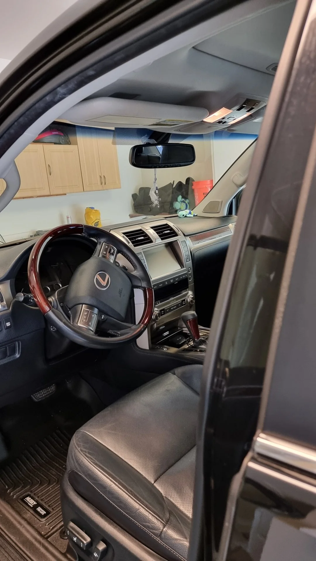

Hi All, did a little searching and seems like common issue but don't see a fix without replacing. About to order a new one but want to confirm color. Can someone help me out. Looks gray to me but in some lights tanish? Gray?Ivory? Ecru? The side trim is lighter.

ours work differently than either of those. I'd like to see what's inside ours. It'll give a better idea on how to modify it. Sometimes its a clamp that can be tightened, sometimes its friction with plastic or rubber that just wears out.
I think it's friction with a cam. I just swapped it out with new. I kept the old one so could cut it open and see but have to ruin it to fix it from what I saw.
My drivers side is gonna need to be addressed soon. For now when it starts to sag a bit I just open it and close it hard and that works for a while. I want to just fix mine and keep the original visor.
IMO: One would probably have to fillet open the assembly on top edge with a utility knife to address issue. I don't think there is a clean fix.
