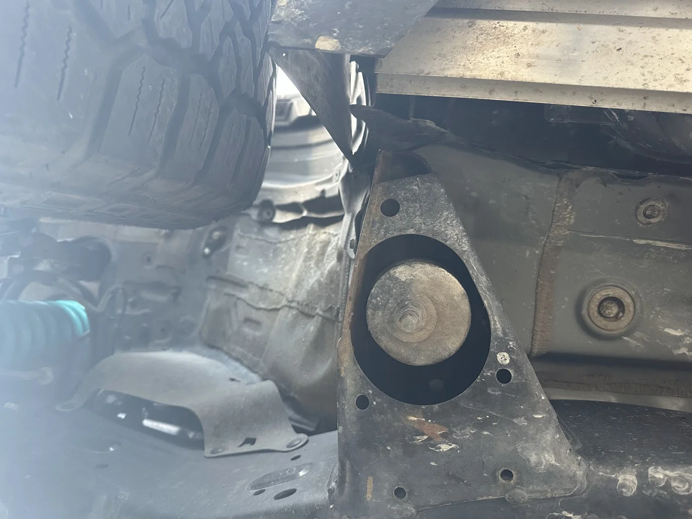

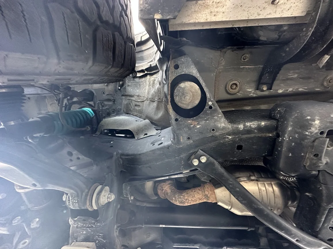

Here's a crappy picture of one of mine - I had a shop do it but having seen it I think I could do it at home. If you need more pictures let me know.
@jdam that helps! If you happen to have a pic with the whole thing in frame, I’d love to see it! Thank you!

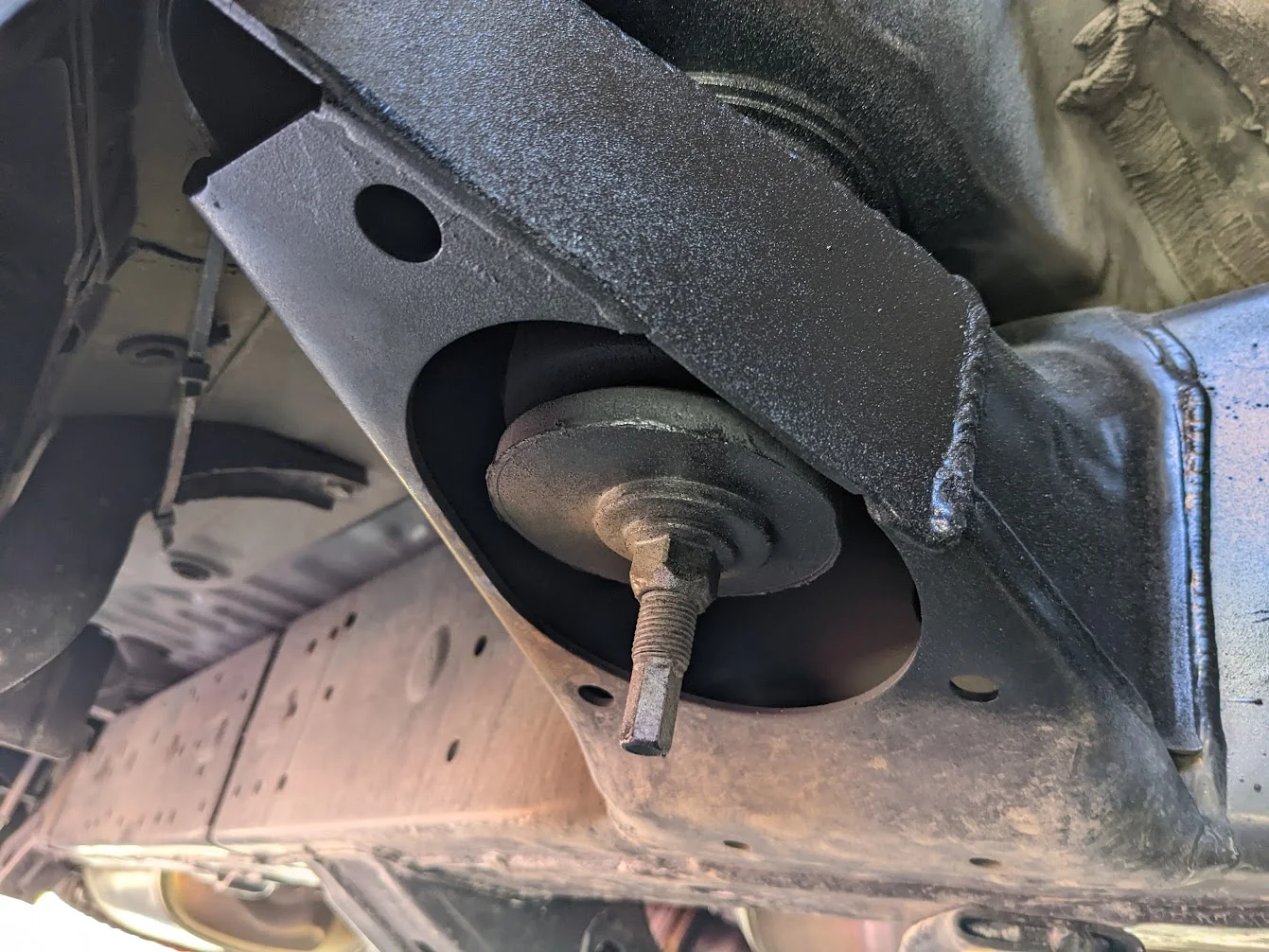

Few pics of mine in this thread.

That's what I'm running - 285/70/17 on a 17x8.5 -10 with a 2'ish Dobinsons IMS. Mine's a pretty conservative cut and you could probably get a bit more out of it if you tried. But hopefully this gives you an idea of what to do. Just do it once and forget about it haha.
