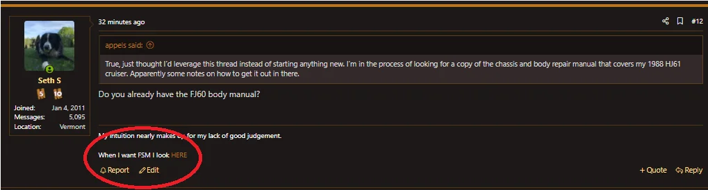

Do you already have the FJ60 body manual?
Well to get you started just click on the "HERE" in my signature:
Seth, you are an absolute legend! Thank you!

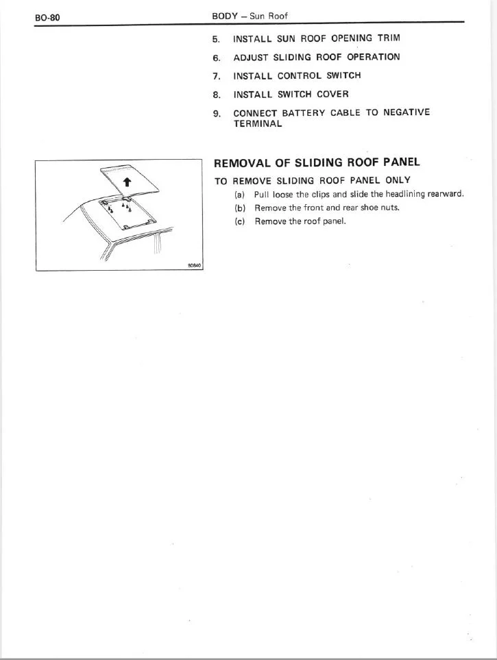

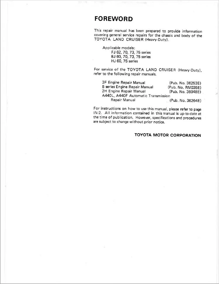

To complete this thread, screen shot of pg. 522 referring to removal on the sunroof panel only. Get a copy of the manual if you need to remove the guide rails, motor etc.
